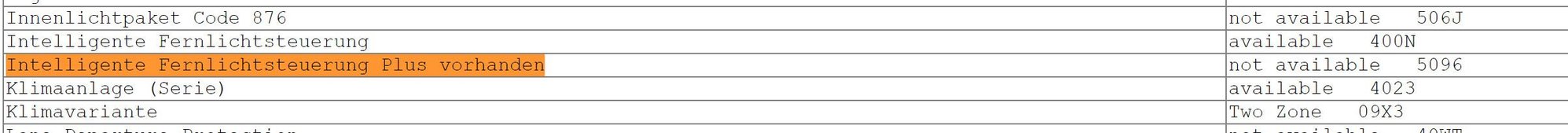

"Intelligente Fernlichtsteuerung Plus vorhanden" is Adaptive Highbeam Assist Plus. On my 2012 it's listed just below ""Intelligente Fernlichtsteuerung"

This is what mine looks like. It doesn't even have the Adaptive assist plus, just the regular old one. I think I'll activate the one in the IC_204 , see what happens. There's 2 or 3 entries where it needs to be turned on.
