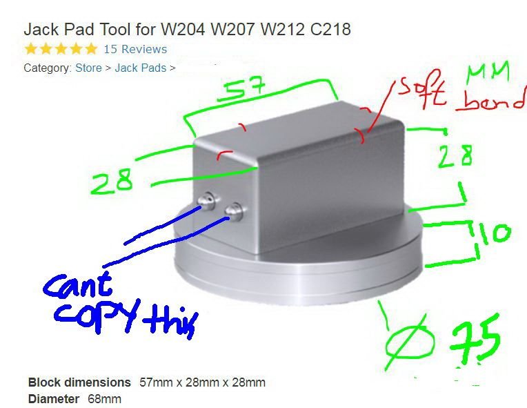

I machined mine out of nylon 66.
Its good, it can take abuse.
Here is what I gave the machined shop to machine ( in millimeters ), using a sample image from I forgot what brand, which is metal not plastic.
Under stress/load, but shape WILL return back to normal......... which is good, its like auto leveling if any car lift has worn out jack support
Using Quick Jack
Mr Jack-Pad "girlfriend" on the car , close up........
