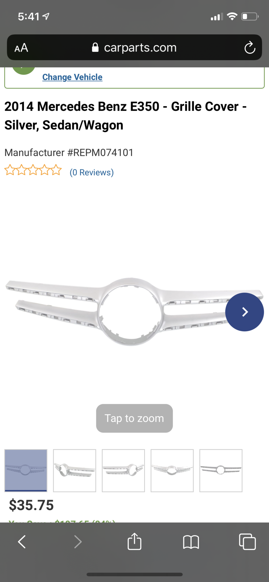

The previous owner of my car (w212 2014 facelift) basically glued the Mercedes grill star emblem into its housing and it’s proving a pain to get out. I understand that to remove the grill basically the whole bumper needs to come off, but is there a way to just remove the grill cover (the emblem holder and the two slats on each side)? From the looks of it, it’s just held in by clips but was hoping to get some information on it before I go just trying to take it apart myself.

I should have included in original that it was a 2014 facelift model. You’re positive it’s riveted in? From the replacement grill cover photos it looks as tho it just snaps in and from looking behind it I can’t see any spots it’s attached to in any other manner.

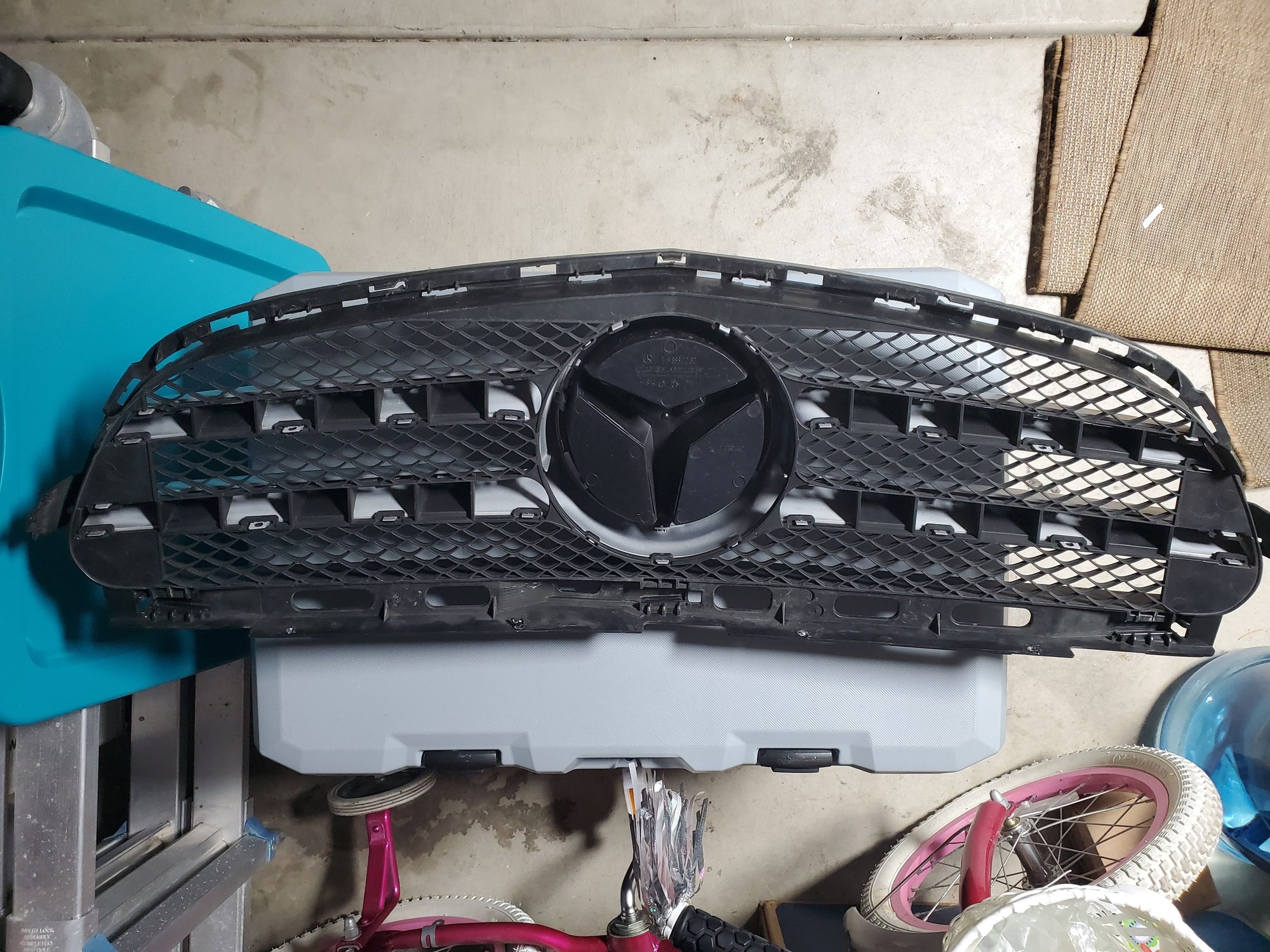

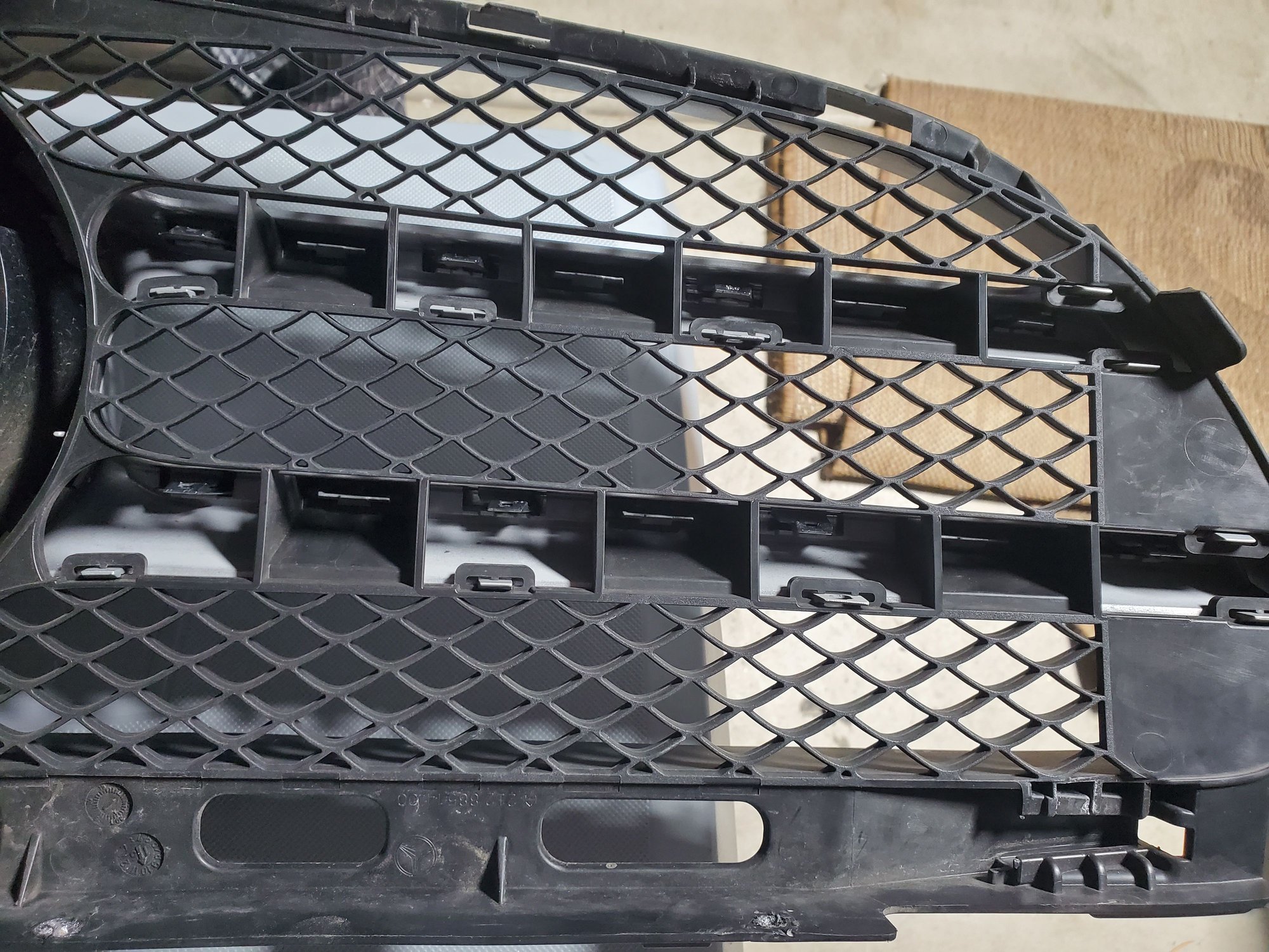

Old Jan 22, 2020 | 03:07 PM
EuroDriverSD's Avatar
Joined: Jul 2015
Posts: 795
Likes: 189
From: San Diego, CA
2016 E350 Sport; Mom Wrecked the 2008 E350; sold the 2002 C320
I got a chance to pull out the old grille this morning and yes, it is attached with snap tabs only. However, good luck undoing all those tabs while the grille is attached. Here you go
Old Jan 22, 2020 | 03:20 PM
Burns's Avatar
Joined: Jan 2020
Posts: 6
2014 E 350 sport sedan
Thanks a ton. You are definitely right about how much of a pain this is going to be. The right side of it I definitely can get (very thin and can fit thru a gap in the top), but the left side is going to be a whole issue in itself.
Old Jan 22, 2020 | 03:25 PM
Joined: Jul 2015
Posts: 795
Likes: 189
From: San Diego, CA
Since you are only replacing the slats insert, do yourself a favor and drop the bumper from the get - you'll be doing yourself a huge favor. Removing the entire bumper is not difficult at all
