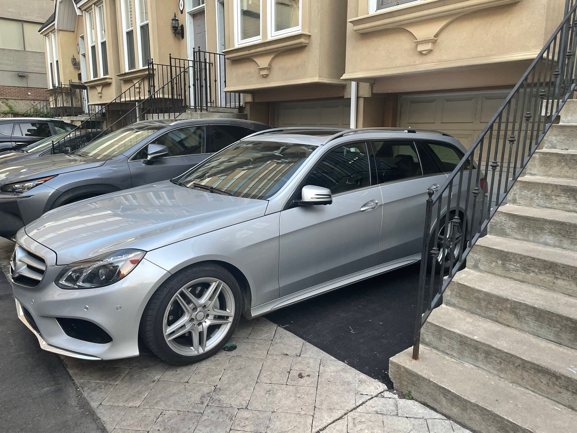

Mercedes 2014 E350 Estate (S212)
Originally Posted by ygmn
ECO gets better MPG.
Sport is fun
I have the opposite experience. I have a E350 3.5L gas engine running premium (91 octane). With E mode I get 18-20L/100km, on S mode I get 14.5 in city traffic.
Could this mean I need to change spark plugs or perhaps I need to reset the transmission coding (procedure where you turn off the car and hold the pedal for a few mins, etc). Or perhaps the car needs the italian tune up…?
Old Jul 20, 2021 | 07:00 PM
Arrie's Avatar
Joined: Oct 2010
Posts: 5,141
Likes: 1,293
From: Southern US
2010 E550, 273 Engine: 2012 S550, 278 Engine
Your fuel mileage value is very bad or you have a very heavy shoe on your right foot as 19 l/100 km equals about 12 MPG. The 14.5 l/100 km equals about 16 MPG, which could be decent for city driving. I get 24 MPG on highway and around 17-18 MPG in city with my 2010 E550. 24 MPG equals 9.8 l/100 km.
