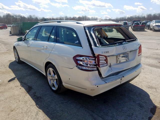

As the title says I am looking at a 2014 350 4MATIC BlueEFFICIENCY Wagon WDDHH8JB0EA811489. I talked to the insurance company and they
reviewed the damage estimate on the car. As I am looking at prices of the parts I am having a couple of challenges.
What model is the car? The salvage yard that has parts told me that the rear bumpers are not the same from the sport to other models.
what is the color? So I can try and find the parts already painted(used)
Options on the vehicle?
It is a 7k buy and at this moment it looks like I can get all the parts delivered to my door for 2k. Then I would have to do an enhanced inspection. I realize that the resale would be low because of the rebuilt title.
Any other advice would be appreciated.

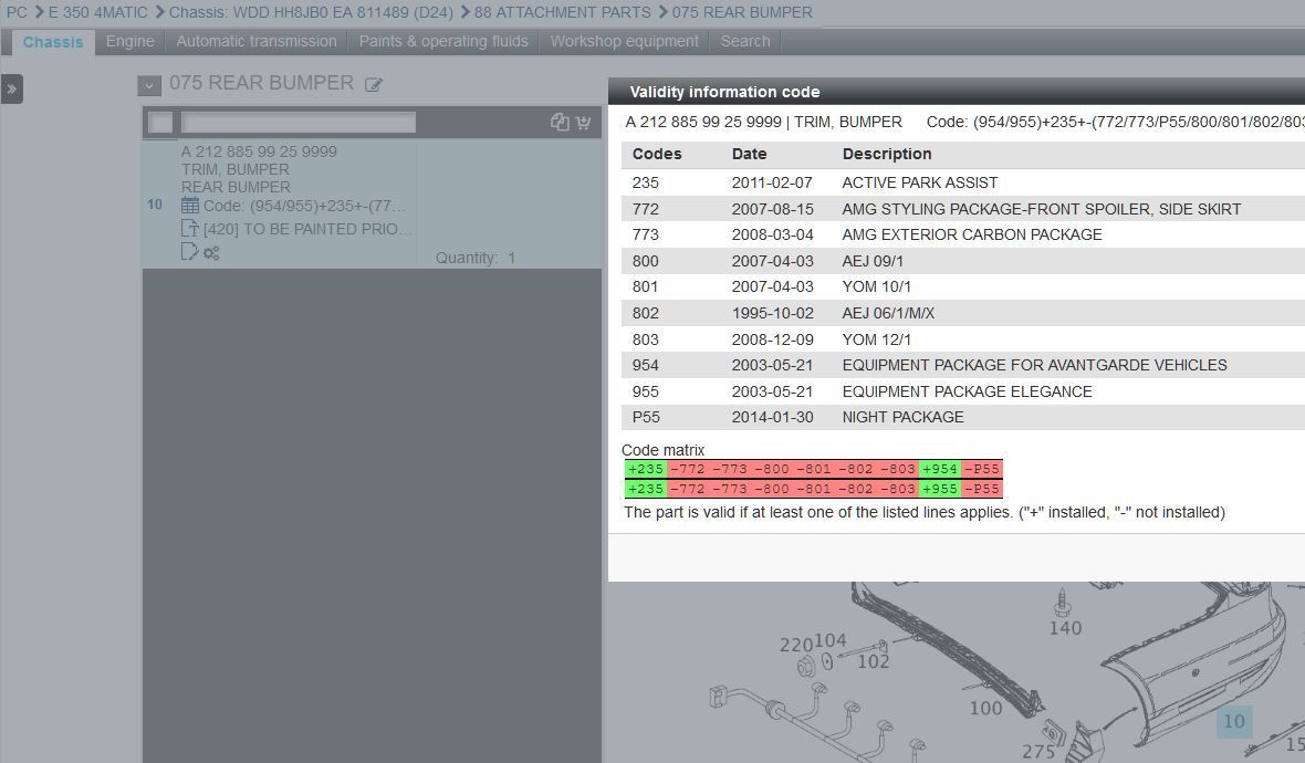

Rear bumper is part 2128859925 has active park assist not AMG styling see Xentry attachment for full parts list. Data card attachment shows vehicle details: model 212.288, exterior color Diamond White Metallic, interior Leather Espresso Brown/Silky Beige.

Looks like finding that bumper used is going to be difficult.

Viewing picture, may need these.

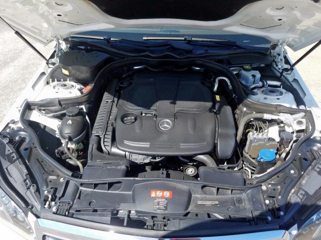

Here is a pic of the engine.

That doesn't look like diesel engine.

Not diesel, 276.952 engine as documented in MBUSA data card. BTW here are service requirements.

In one sentence, the slightest bend around the rear door will make this car a nightmare to own. I would be willing to bet that this is the reason for the salvage title.
Regarding salvage, I had an excellent experience with the car, but not so much with the process. In October 2016, I picked up a 2012 S550 4Matic with 77k miles for under $23k. It is about to roll past 120k miles with nothing out of the ordinary, one round of breaks, front lower control arms, air suspension compressor. The crash repair cost around $4k which is what made this thing a deal. And most importantly, it all happened because I know the right person.
Regarding the experience, it took 3 months to get it repaired (but only $4k), which was not the only problem. Nor the biggest. Due to a series of bad coincidences some of the replacement parts VINs showed up as stolen when I took the car to get it inspected. That is of course another story for another board. It added a week long delay, over $1,200 in damaged parts, and the massive emotional trauma of four police cars rushing to the scene to apprehend me and my ring of criminals when one of the parts’ VINs got flagged as stolen.
To recap, never buy a rear ended wagon, and never buy salvage unless you know a guy or if you are the guy.

kinda off topic but I wouldn't recommend buying the car unless I can physically inspect it,
a few month ago my sedan had a rear end accident, it looks 5 times less serious than what you have on the wagon,
but once they take the bumper apart apparently the impact also bent the rear body panel and the spare tire panel resulting a $8.1K repair bill,
so never underestimate what you see on a picture until you get to the underbody
