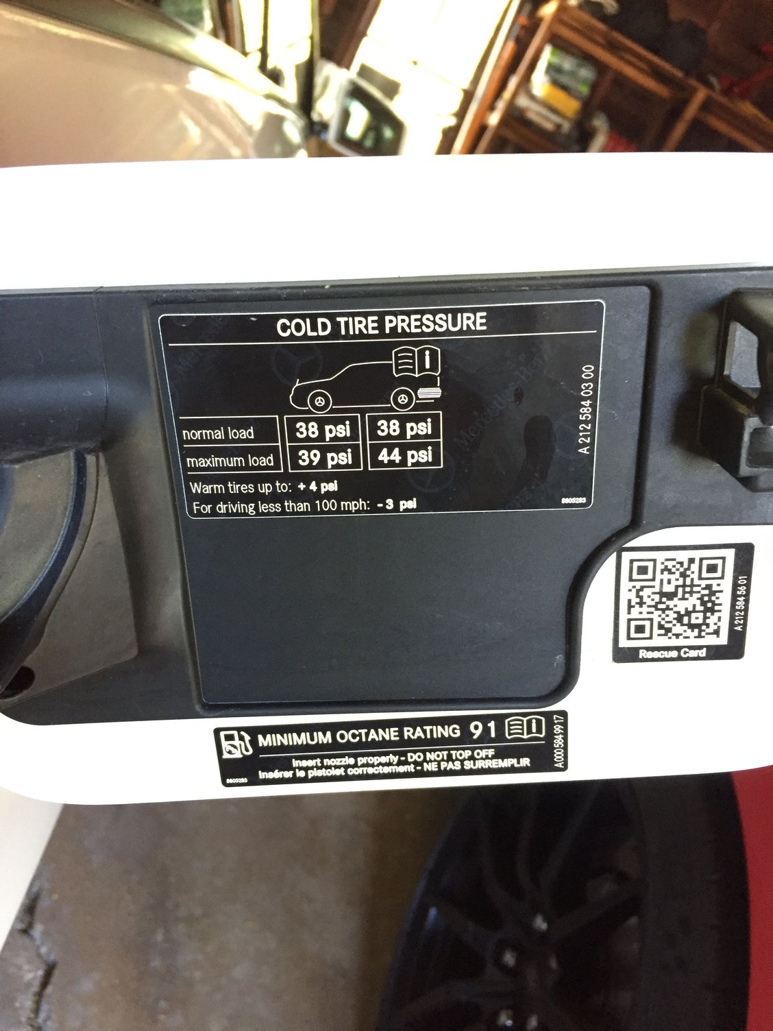

My car (2014 E550) was in an accident and then when passenger side was repaired, they never replaced the tire pressure sticker on the inside of the fuel door. Does anyone know where to find a replacement? If not could someone with an E550 take a picture of the sticker for me/or tell me the pressure as I recall the pressure listed on the sticker was different from what was listed in the manual.

Here are the two and the configuration on my 2012 E550:
Also, you can always call MB with your Vin and they can get you the correct stickers as well. Not sure if 2012/2014 are exactly the same or not...

Have whoever repaired vehicle order part # 2125840300 (about $10 or so).

See there is big difference between country models. The picture above shows
"-3 for below 100mph"
your says
"+4 for above 100 mph"
Not only the value is different, but logic is upside down.

I misread my label.. like all 50 times I've looked at it, I've misread it. Have the staggered split 18" AMG rims. My label actually says:
Normal load: 33F, 35R
Maximum load: 36F, 42R
LESS THAN 100MPH -3PSI
WARM TIRES UP TO +4PSI
So this means my current settings of 30-31F and 32-33R are the correct ones, which would explain why it rides and drives so well now. Every time it goes to the dealer they reset it to 40/41 all around and it becomes jittery and nervous.
