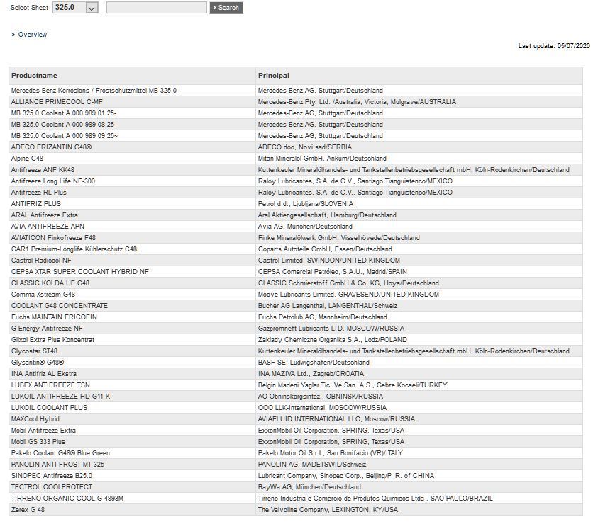

With the help of this thread and a lot of mouse clicking it leads me to believe that spec 235.7 is the correct rear diff. oil for my vehicle. Bouncing around in BevoMB also brings me to this page:
https://bevo.mercedes-benz.com/bevolisten/231.1_en.html
I think I just have the rear axle-standard differential which also points me to 235.7. I have a W212 with the 276 3.5l engine.
Then I come across this gear oil that meets the spec and am real happy since its half the price of the MB oil:
https://www.pelicanparts.com/More_In...6&KeepHeader=Y
Its great that MB has these lists of approved fluids, but it certainly is tricky to navigate. Please check behind me to see if this is correct.

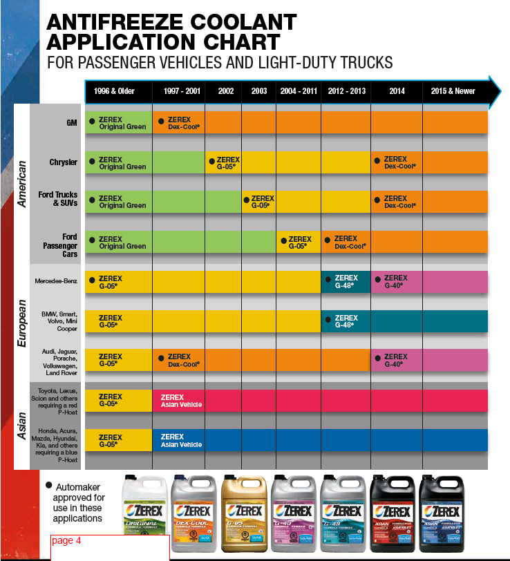

I use Dexcool in my VAG engines, it's the same thing as G-12 and $30 Porsche coolant.
G-05 and G-48 might only differ in color.
All are "compatible" except old high silicate green "HD" coolant.
Speaking of green, Maxlife is excellent w/a proprietary formula.

According to the chart you posted my 2013 E350 is right in between the switchover years and should use the G48 which shows the 32.0 approval. I think I'll stick with the MB blue coolant, its quite reasonable at $21/gal.
