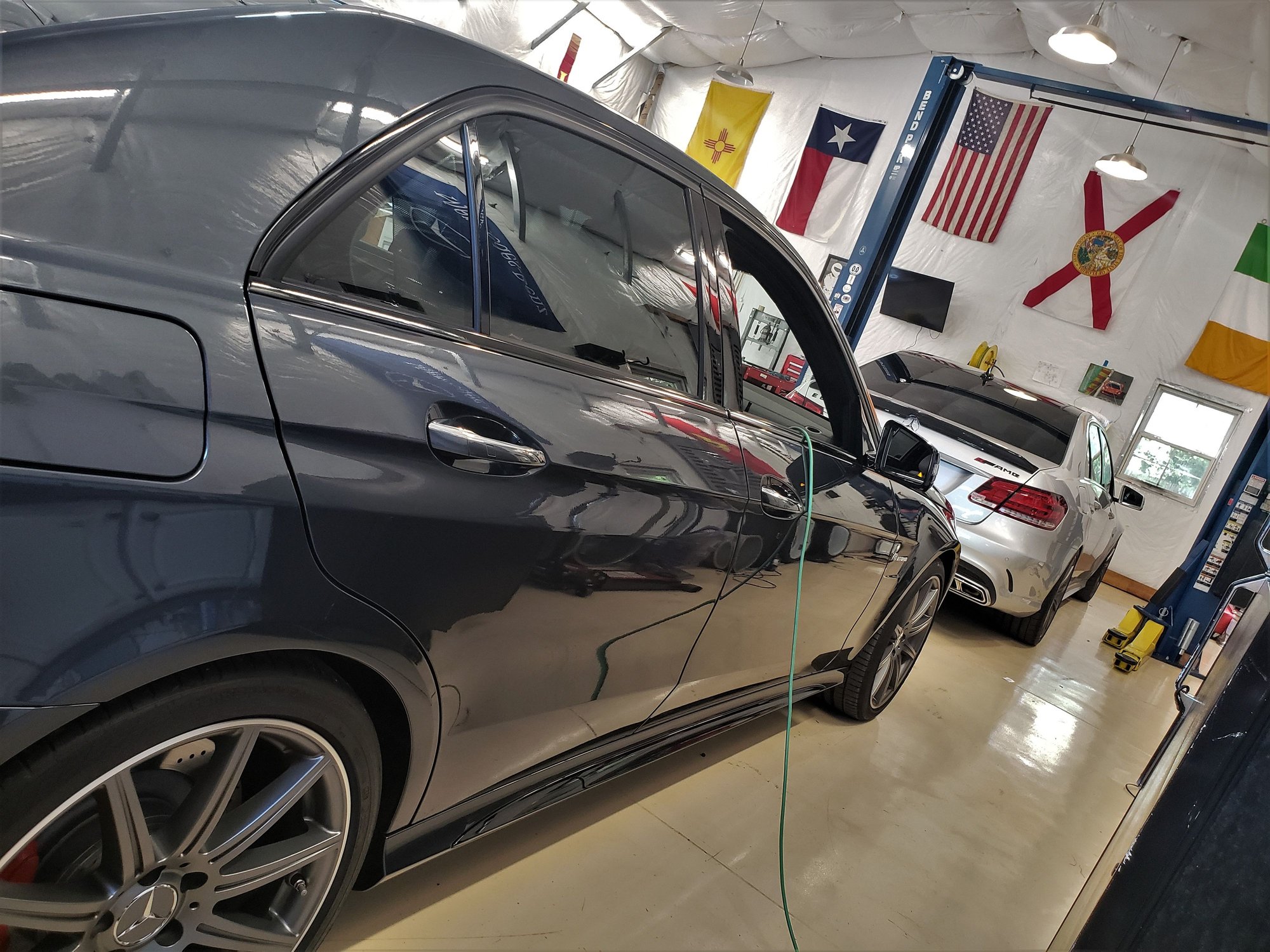

Originally Posted by LILBENZ230
Do post up what the screen actually says in your friends car. I'm 99% sure it says "adaptive highbeam assist" but I want to know now. If that's the case then the whole operation does change with the coding. Before you could turn off the adaptive highbeam. Now you cannot, at least not in the menu. You can always do it with the main control switch to "ON".
Did my friends car today, before i did you we check the menu, there was NO setting for adaptive highbeam assist. only the ambient lights, surround lights, DRL etc. nothing related to highbeams
