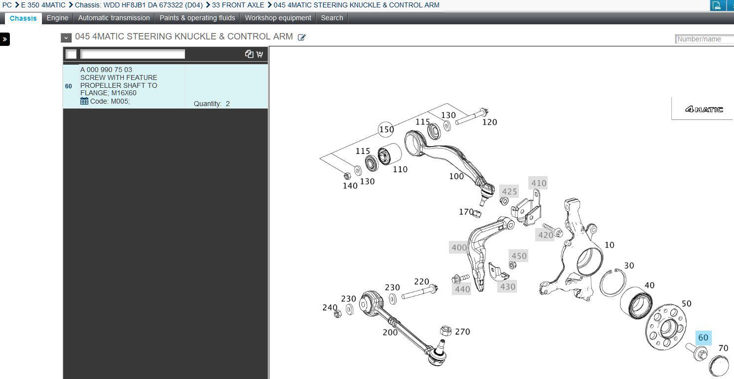

I can't remove screw/bolt (1) from front axle shaft. Did you finally be able to remove the screw/bolt (A 0009907503) from front axle shaft? I don't know why I can't remove the screw/bolt,
it seems so overtighted screw. If you don't mind to share, how did you remove the screw please? counter clockwise turning? or do I need special tools to remove the screw/bolt?

According to the parts list provide by our Guru Mr K.
The bolt #1 is item 60 A 000 990 75 03 in the Xentry Portal pdf
https://www.onlinecarparts.co.uk/feb...n-9703616.html
This is a Torx not a hexagon bolt.

For the axle nut, I don't think it was a 19. I used this set I got from sears a while back, it was on sale at the time at around $20. There's no 19 in the set. I think it was an E24 but don't quote me on that.
https://www.sears.com/craftsman-13-p...p-00949295000P
You should probably invest in an an impact gun. Mechanic took it off with no problems with a regular small air impact gun. There's lots of cordless ones out there that are about the same.

Thank you so much for your generosity and kindly heart to have best advise for me.
Yes, its for sure that screw is a Torx bolt. and I am great to know, I should use female torx plus and never use the 19mm 12pts socket, especially to remove a high torque super tight boll.Thanks Sir.
I totally agreed with you, I should get your recommendation tools "OTC MASTER TORX SET". while the one I have now, Torx Set (not Torx Plus), its only up to E18.
But this finish this weekend project, I love to have that OTC torx plus set. to add the tools into my inventory, and the price is quite reasonable. tools with high performance tools. If I know this kind of tools, I should get it much earlier.
Btw 2 years ago, I replaced the all break pads (front + rear) and also the rotors (front + rear) too, the only hard time for me, when I was removing the rotors, as for the brake pads, it quite simple.
It seems, there are many tools that I don't have in order to remove ball joint, and this "hub and bearing wheel" removing is quite complicated, not as simple as complete brakes replacement, and I am pretty sure that my skill and knowledge is not good enough to replace this hub and bearing wheel.
Do you think, it better for me, just bring it to my local mechanic to do this job? thanks you in advance.
