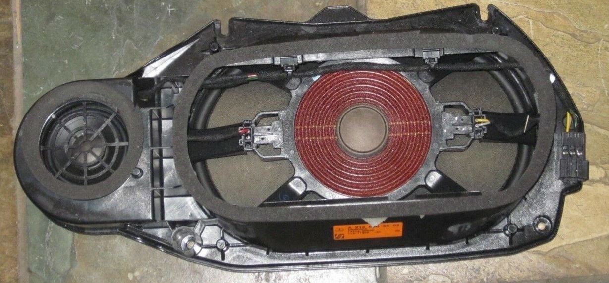

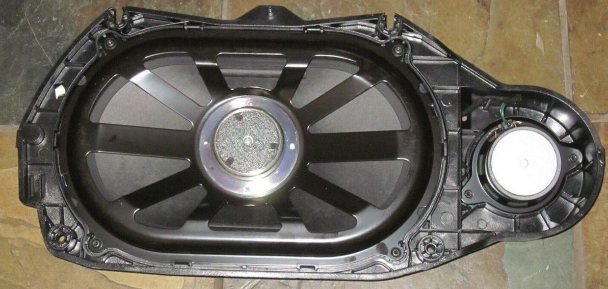

Thanks for that. I have nailed down sound to the passenger side rear deck? Subwoofer mayb

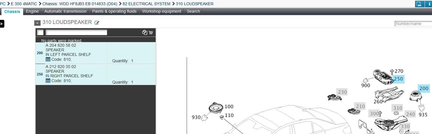

Attachments cover rear shelf. Here are parts #s if it proves to be speaker(s).

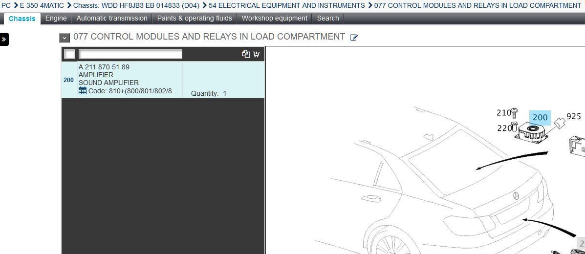

See post 9 above for sub, here is amp.

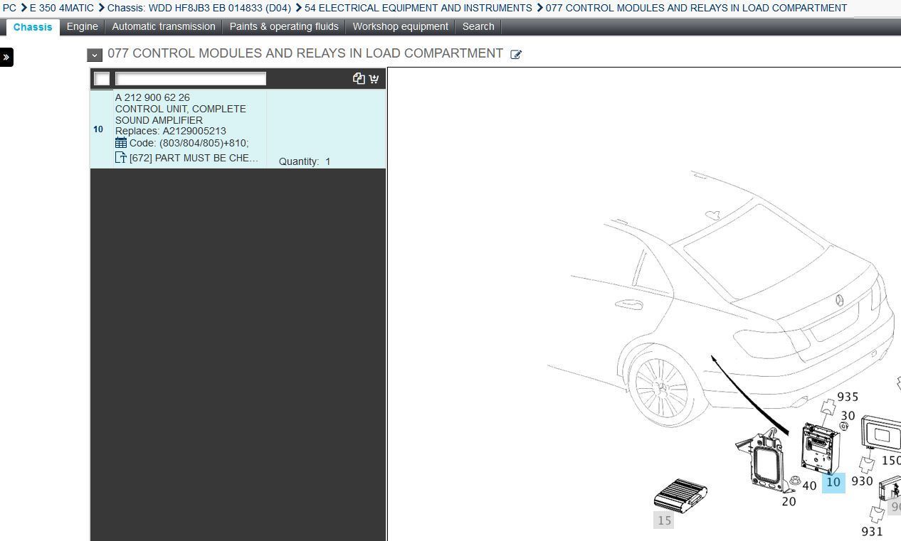

Amp in post 12 is for sub, here is system control amp.
