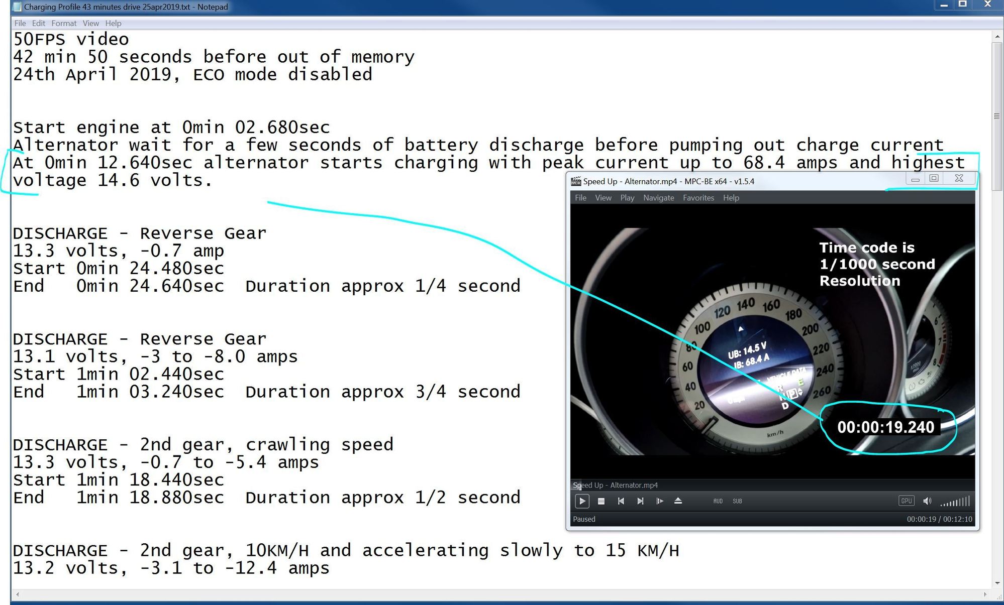

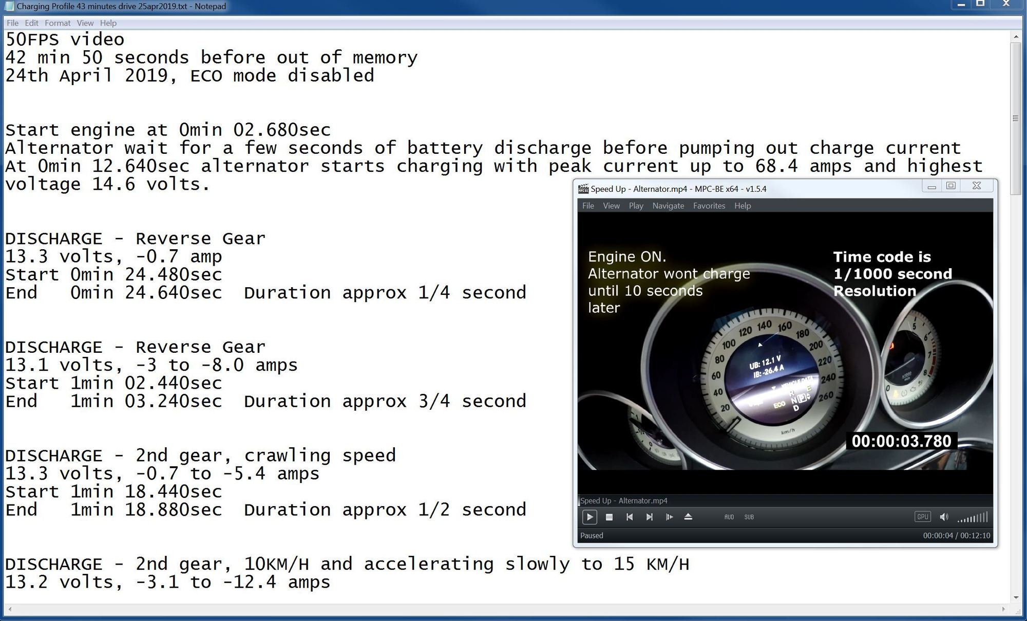

I have stopped investigating my E400 charging algorithm for quite sometime now. I have come to term with it ...Amien.
Before I have the Torque Apps and OBD2 bluetooth, I video the dashboard screen and set Amperage and Voltage.
I have an alternator behaviour video of 43 minutes, during a use, which I sped up to 12 minutes, but I doubt u guys wanna watch something that boring
I have attached a TEXT file showing what happened, faster read that way. Charging Profile 43 minutes drive 25apr2019.txt
Some teaser photo below of the alternator charging video :
Prior to MB dashboard amperage + voltage info, I use my stand alone amperage clamp and voltmeter and idle the car for like 15 minutes and do engine stop and lock the door and log what consumptions before car computers
really sleep till lowest amperage drain occuring.
Too bad the Torque Apps can't pull out amperage data but anything less than 12.75volt while engine is running = a discharge condition, easy to summarize.
I have accepted that my E400 has a charging algorithm which will result in my car battery unable to live its life to the fullest, as per my car driven habits.
Knowing how a battery works, I have decided that the only way to solve this is to use a small battery charger, whereby I will keep my battery fully charged at least twice per week.
Anytime a battery is not fully charged, sulfation occurs. That simple. CCA is lost when sulfation on the plates gets more and more over time, where charging can no longer remove it.
You can read 12.7 volt unloaded at the battery thinking it is healthy, once you apply 200 crancking amps and it won't spin the starter beautifully and voltage sag down to 9 volt or less,
that is CCA decline.

Originally Posted by S-Prihadi
S2. If you want to know that your car battery is not fully charge or at least 80% charged that day after a day use...easy.
Open hood when you reached home and not using the car for at least 10 hours later. Lock the door and keep that key far away to not trigger radio communication with car. Don't do anything which discharge the battery.
Get battery to room temperature after approx 4 hours ( for me ).
Measure battery voltage with a decently accurate voltmeter.
If you read 12.45 volt or lower, there you go, your battery is probably at 60% state of charge.
What we want to see is 12.65 to 12.8 volts during overnight storage 4 hours after engine shutdown and zero activities eating battery power.
Happy troubleshooting.....
My only additional notes to the above is that those state of charge charts typically refer to no load voltage. There's typically a slight current draw when the battery is connected. Also it's temperature dependent. Typically that voltage is for a battery at 70 degrees. I've registered 11.5 volts on my battery when the temperature was in the 20s in the winter.
Agree, me forgot I am in a tropical country with no cooler than 28C 365 days a year and you guys have winter. Thanks C.
After 4 hours or when all electronics are sleeping ( usually 30 minutes) my car consume only its so small stand-by needs at 6 milliamps. Car key far away, door locked, hood open.
Forgot to add, there are times which I can't yet pin point the exact cause ( occured twice already that I know of )....but I suspect is a long good hard run where my aircond runs very cool for X ( good ) amount of time
on the road at decent speed ( not in bumper-2-bumper traffic jam ). In like 30 minutes later after engine shut down, the aircond blower will spin slow for some minutes. I did not record the amperage discharge
for this but I think 1 ampere is easy. NO, the interior aircond control panel did not show anything as active nor does my car has that special button called REST.
I suspect this is a way the car remove more condensation from the indoor unit ( evaporator ) to keep away growth/mildew. It can only be seen if I remove the air baffle on top of battery box. It is so quiet the slow spinning.
Old Aug 1, 2020 | 01:36 AM
That is still not the same as the no load voltage of a battery at rest. I left the fog lights on once and killed the battery, brought it home to charge up and tested the voltage and then put it back in the car. Voltage was about .3 volts lower with it connected than the no load one. Granted it had a slightly higher load on it as the display was just on. According to the charts, about .3 volts is almost a 30 percent difference in terms of state of charge.
Old Aug 1, 2020 | 10:58 PM
S-Prihadi's Avatar
Joined: May 2018
Posts: 6,600
Likes: 6,547
From: Jakarta-Indonesia
Voltage drop reading with load will depends on how big the load is and how weak your battery is if it is not totally healthy or even if the battery is totally healthy drawing certain amperage will drop its measured voltage.
Automotive battery is a standard 20 hour discharge to get the Amps Hour Rating, so in theory a 100 amps-hour battery is discharged at 5 amps and they calculate to the minimum voltage of 11.9V if I remember correctly.
Same 100Ah battery if discharged at 10 amps will not be a 100AH battery, it could be 80ish AH, depends on the test result.
What most people dont know is the amount of power draws by the car electronics from engine running to engine stop, locked the car and leave the car till all computers really sleep at least 30 minutes later.
After door locked stage, my E400 is about 6 amps draw for about 30 seconds. Then it will be about 3 to 2 amps for about 5 minutes.
After engine shutdown and if you leave the car key in ignition* ( *maximum left position ) where the dashboard still shows gauge mode, that is 11 amps worth of power draw.
Hence my suggestion for those who wants simplified version is to check battery voltage is after about 4 hours or when room temperature is reached and car computers are sleeping and very very low
amperage draw, as such it will not create significant voltage drop when one measure battery voltage.
If that Solar BA9 battery tester is nearly as good as say Midtronics battery analyzer unit, perhaps once in a while test the battery with it.
For me, knowing my E400 charging algorithm is basically a battery killer, all I need to do is charge the battery at such low power a 5 amp CTEK is.... twice per week at least and be happy and
hopefully can get 4-5 years out of the Varta AGM. By now my ear is trained to hear battery getting weaker just by the sound of the engine cranking and the speed of crank to engine active/running,
as such there is never a car of mine ( my own daily drive ) which in my last 25 years ever had a battery failure, I will replace it the moment the cranking speed and sound is out of spec.
I dont have winter in my country, so basically I don't have experience by ear to detect reduced crank speed due to say zero Celcius ambient temperature.
