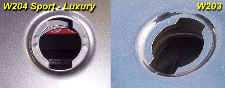

The part number quoted is the standard Upright hood star. A210 means it is for the W210 E-Class, and will fit any car with the hood divot that looks like this... Take off your flat badge and look for this...

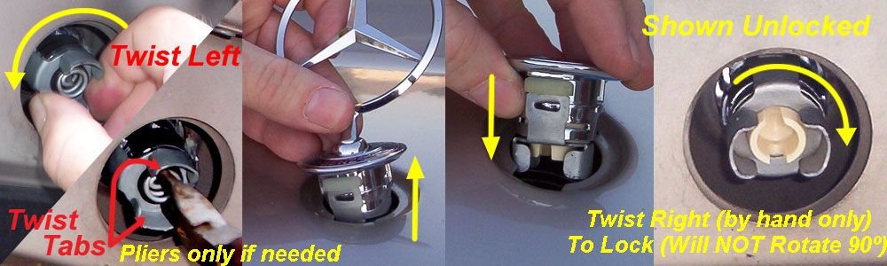

Open the hood and look under the location where the hood ornamants (flat or upright) are attached. The only tools needed to remove/install an upright star are the standard issue, Mk1 Thumb, and Mk1 Index finger (see upper left)...
