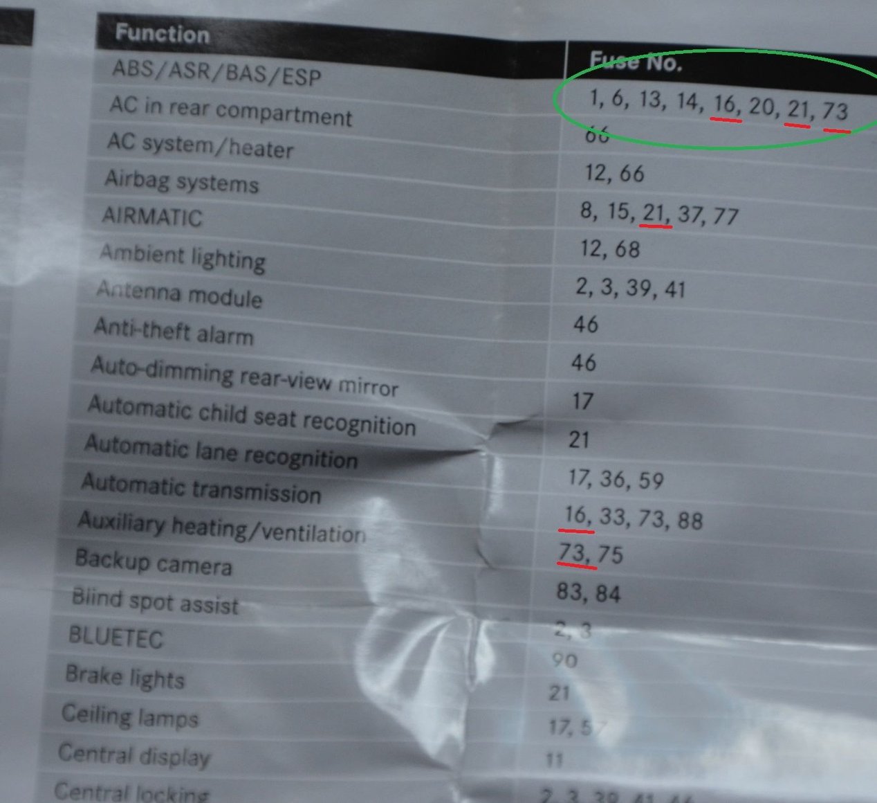

For ESP/TC. Depending on YMM, it’s either fuse 1,5,15, or 20 in the engine bay

Thanks for that.
Looks like I don;t have a 5 or a 15. And 1 and 20 are both pretty big fuses. 25 and 40 amp respectively.
Any ideas?
Of the 8 listed, many also have other uses. Do we use those for process of elimination?
1 25A
6 10A.... Engine Electronics. Fuel pump. Starter.
13 7.5A. Fanfare Horn. Headlamp Flasher. Multi-function Steering wheel. Turn Signal lamps, Windshield wipers front.
14 7.5A
16 5.0A.. Telephone System.
20 40A
21 7.5A.. Airbag System. Child seat recognition. Brake lights, Glove Comp light.
73 ??A... Automatic Transmission. Diagnostic Socket. (This fuse is not under the hood)
#20 is a 40A, and I gotta believe that powers the ABS pump? #1 is also pretty huge for a circuit that senses tire slip using already installed systems.
So does that mean it's #14 or #16?

you can pull the fuse for esp but there are other computers in the car that wont allow it to be fully off. like dyno mode will completely disable all assist but its not recommended as it turns off 90% of the braking power as well.
when you can do is disconnect your wheel speed sensor, thatll also replicated dyno mode but will keep your braking power where it needs to be.
