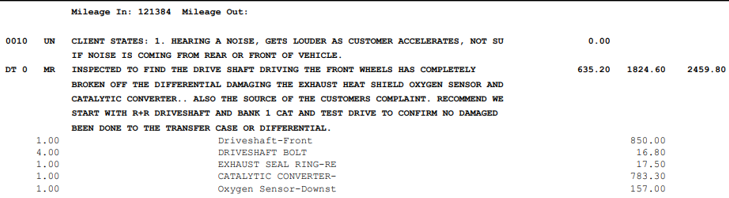

Maybe I choose wrong word for the sound. Attached the video with the sound.
The car had history of front axel break and I think it create same sound before it break. It happened around one year after I hit pot hole around 2 inches deep which that time blow out front tire and bend both front and rear wheel on passenger side. It make noise until it broke loose and hit catalytic converter
I bring to the shop repaired the axle but he suspect belt system. with below estimate
The part very expensive and it easy to do so I replace myself.
One idle pulley I bought from Mercedes which is very expensive US $87.50. The second pulley is OEM Litens (900667A) bought from Advance Auto Part which is identical bearing as the original from Mercedes for US $ 30. Belt is Dayco 5060840 6PK2135 around $32 from Advance and Tensioner INA 276 200 03 70 which had Gates brand on the product and it label as OEM around $60 from Advance which bought the same day from wholesaler WordPac cheaper than Mercedes which want it for $250.

Hi I found out what make noise it is again front driveshaft failed again around 172000 after replaced at 120000
I had Mercedes E350 2013 4Matic bought 2016 with 43000 miles. At 121000 on 2/7/2019 front driveshaft broke after making sound for around 3 months. It broke catalytic converter and oxygen sensor. Actually it broke when mechanic drive tested it. Can we blame to shop? I don't we can right. So it fixed for around $2500. Then now at 172000 miles 4/10/2021 it left me stranded around 140 miles and cost me $500 for towing to home. The closest shop is 46 miles but it about to close on Sat and will open Monday. Geico tow is scam they claimed it cover up to 100 miles but only to close shop and didn't care if shop will close if more than that they only cover 20 miles. So lesson learned get AAA for around 100 per year for up to 200 miles with no condition.
