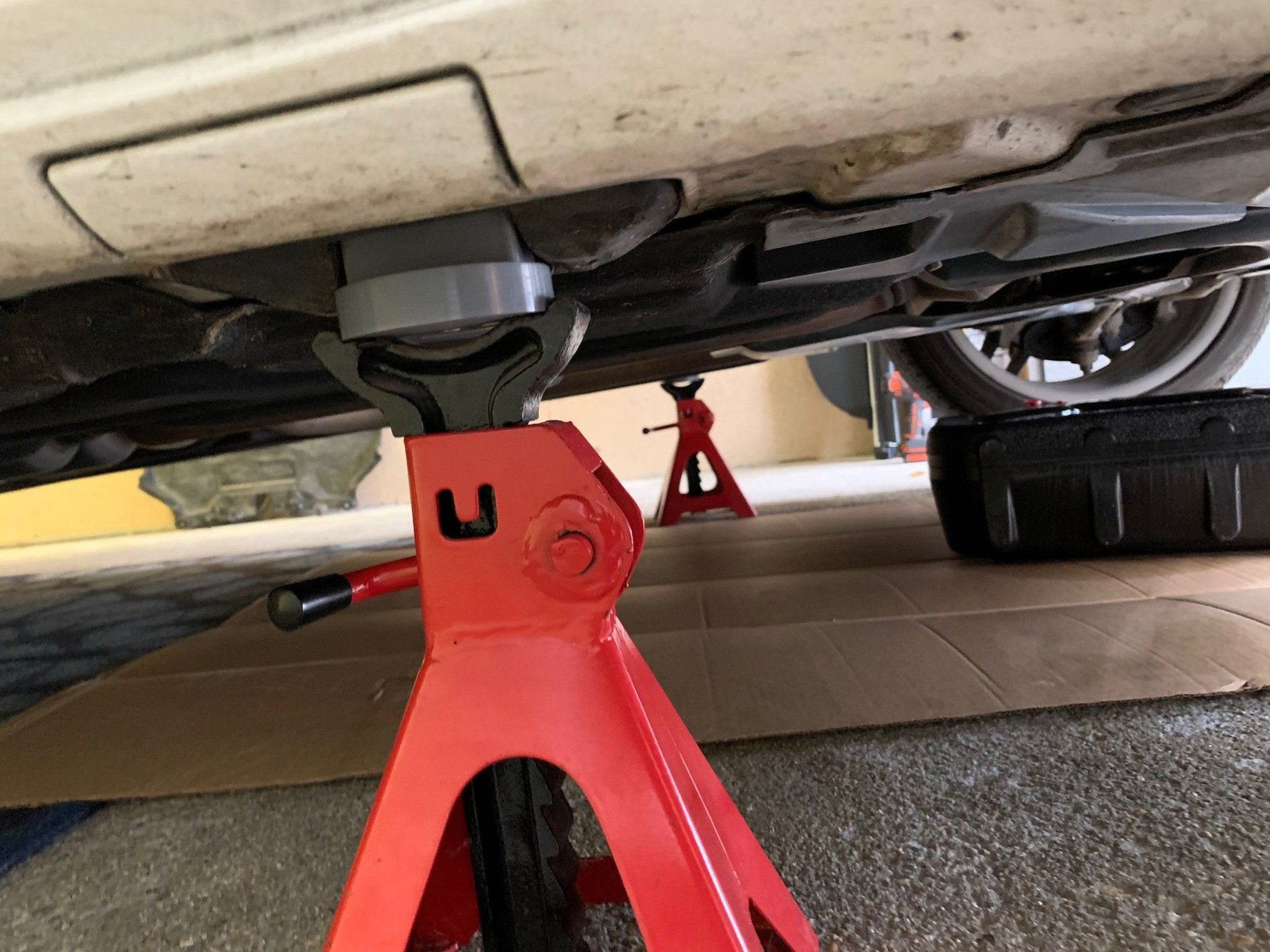

speaking of oil changes, my older Mercedes W124's (have 3 of them), the factory recommended oil change procedure was a oil sucker down the dip stick, and the oil filter was topside too on the M103 and M104 engines... Can a oil vacuum pump be used with the M276 ?

speaking of oil changes, my older Mercedes W124's (have 3 of them), the factory recommended oil change procedure was a oil sucker down the dip stick, and the oil filter was topside too on the M103 and M104 engines... Can a oil vacuum pump be used with the M276 ?that
Yes. I believe it's how shops and dealers likely do it. It's also the preferred method in this article.
Except on a 4 magic it won't get the last Quart out because the axle is in the way.
ah, k. heh, ever since getting one, I've used the oil sucker on most of my cars, including old Volvos, a Tacoma 4.0L.... but on my F250 7.3L 4x4 diesel, you only get about 6-7 of the 14 quarts total it holds, ooooops, so I installed a Fumoto oil drain valve plug, which is awesome.
