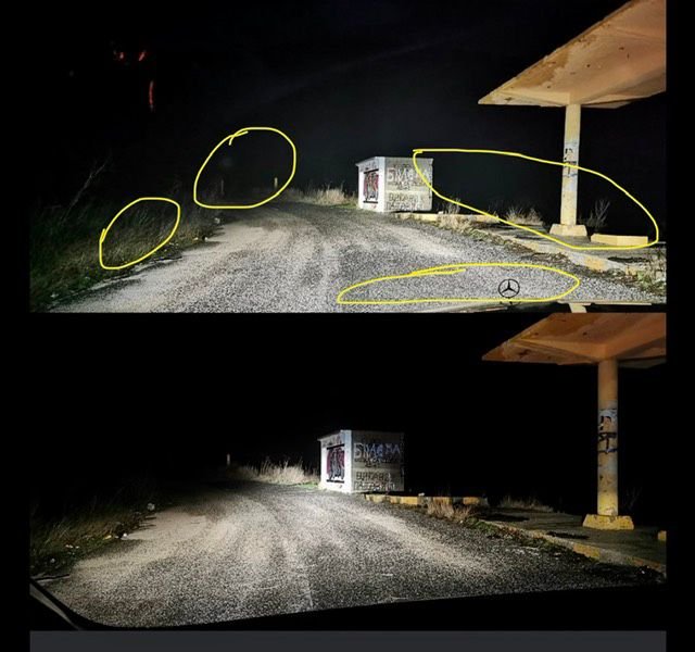

Just to check with others owners of W212 2009-2012. My xenon lights are very poor. This image is compare between my Merc W212 with xenon lights and Seat with regular H7 lights. Is this with every E class W212 or do I need some kind of repair? Xenon lights are brend new Osram.

It is very hard to determine from the photos, but the W212 has more light directly in front of the car, more width, and a longer throw. This is pretty much what you would expect from HID compared to halogen. I don't think you have a problem.

And the bulbs are new [Osram]? Are the pictures of the W212 and SEAT? The first photo has a hood star and the foreground is better illuminated than the other photo. I'd almost suspect the high-beam was on in the first photo given how high up objects are illuminated.

It's pretty clear the W212 is putting out more usable light.
