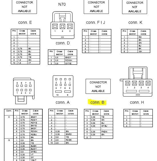

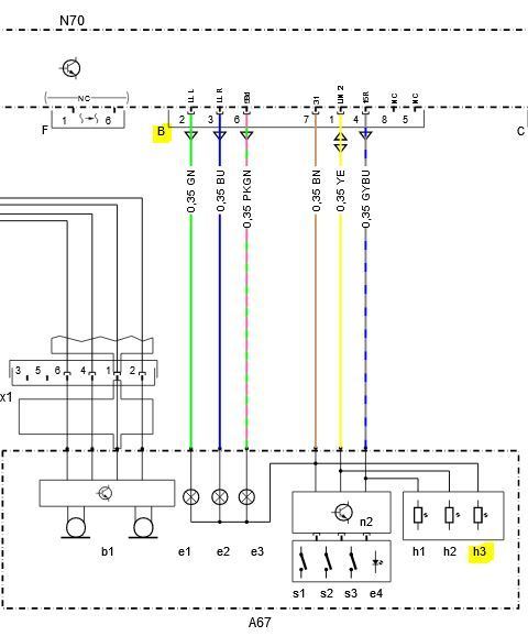

Could be internal sensor requiring mirror replacement but you can check connector/pins @ overhead control panel for precaution.
