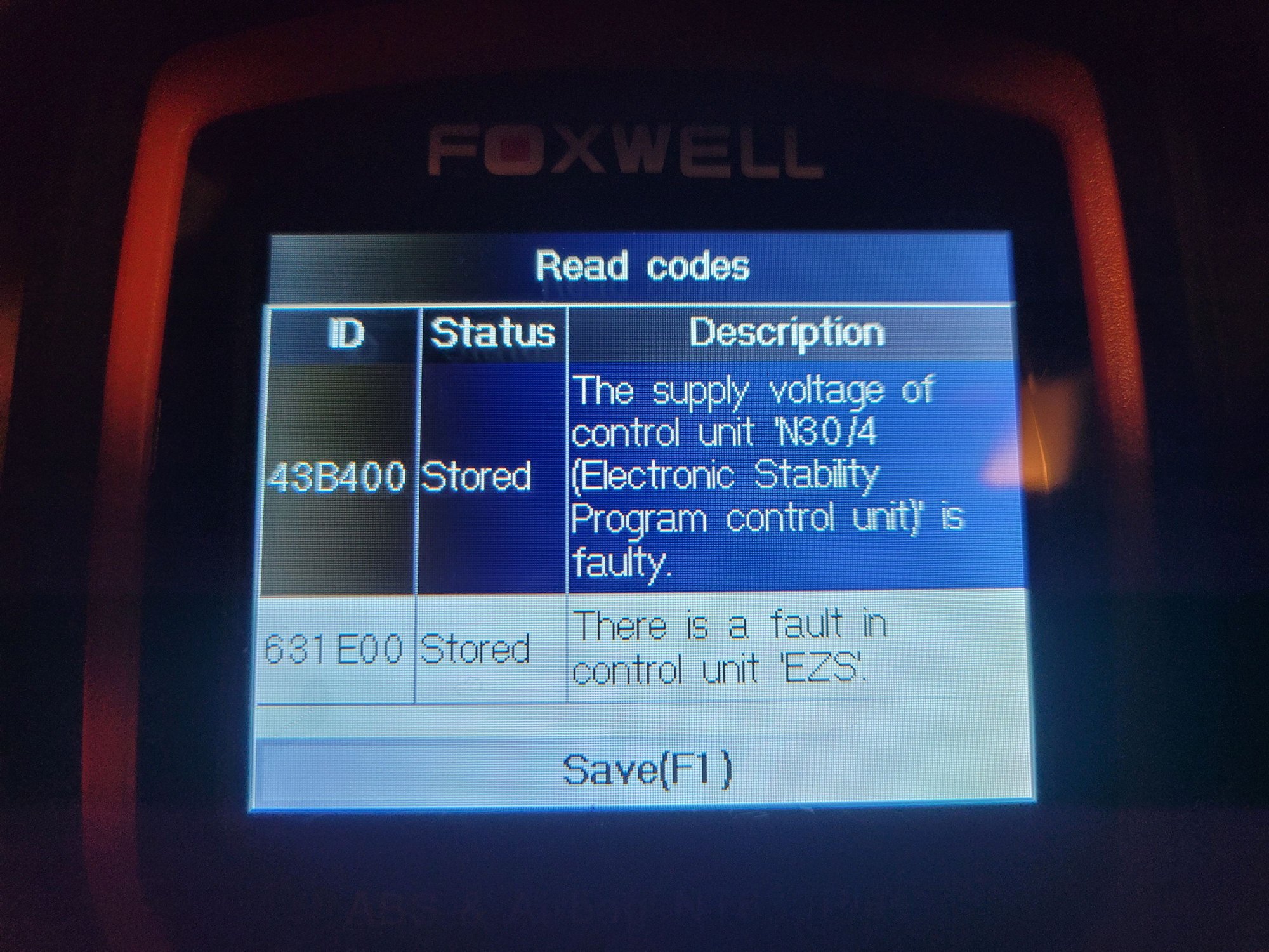

My E550 4Matic 2011 with push start, won't start and the wipers aren't working. It drove perfectly last. Didn't drive it for a few days and when I tried to start it I heard a very short noise from, maybe, the starter and nothing else. Took off the push button and used the key to no avail.
I read a bunch of posts about the starter going bad and based on people's symptoms leading to their starters' failures, I assumed it was the culprit. Bought one from eBay and dropped the exhaust to change it, but realized they sent me a starter from a RWD which is the mirror image of the one I needed. Since I had everything down already, I tested my old starter with a jumping box and much to my surprise it works perfect. I installed it back and no change.
Today went to the dealer and bought a new starter relay and a 20A fuse, which didn't change anything.
When I turn the key, the lights come on and everything works except the wipers. Checked all fuses and nothing is blown.
Just scanned the OBDII and got the following.
This is the read
Please help

N30/4 associated fuse is f1 (25A) @ front SAM (engine compartment). Have you cleared stored codes, revisit battery.
The only 25A fuse in the front SAM is good. The battery is from last year and has been on the trickle charger for the last few days. Seams good, but don't know how to test it short of going to advance auto.
