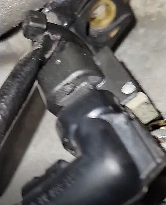

So I started replacing the crank position sensor, and I'm having a hell of a time with the electrical connector. Does anyone know the trick to getting it off, I feel like I've done everything.

Pull the off-white/grey lock out a LITTLE (down and right in the picture)... then press the lock in towards connector body (down and left in picture) and pull out of CPS

I can’t for the life of me get that lock to budge, even got a little flathead in there to help and nothing. Might be time to throw in the towel and bring it to the shop.

I messed with it some more and finally got it off with a pocket flathead. That little white lock ended up going flying and getting stuck in the under tray of the car, so I had to jack it up and fish it out. We're done though, that was defiantly a PITA!
