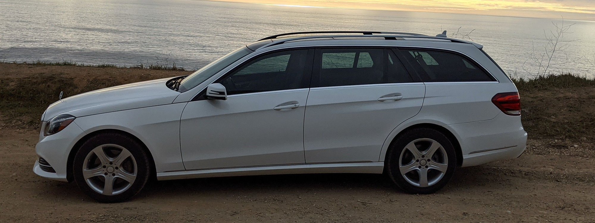

I'm pretty sure the E550's have the same size front brakes as my '16 E350 4M, and 17's fit fine....
these were the 17's offered 2014-2016
