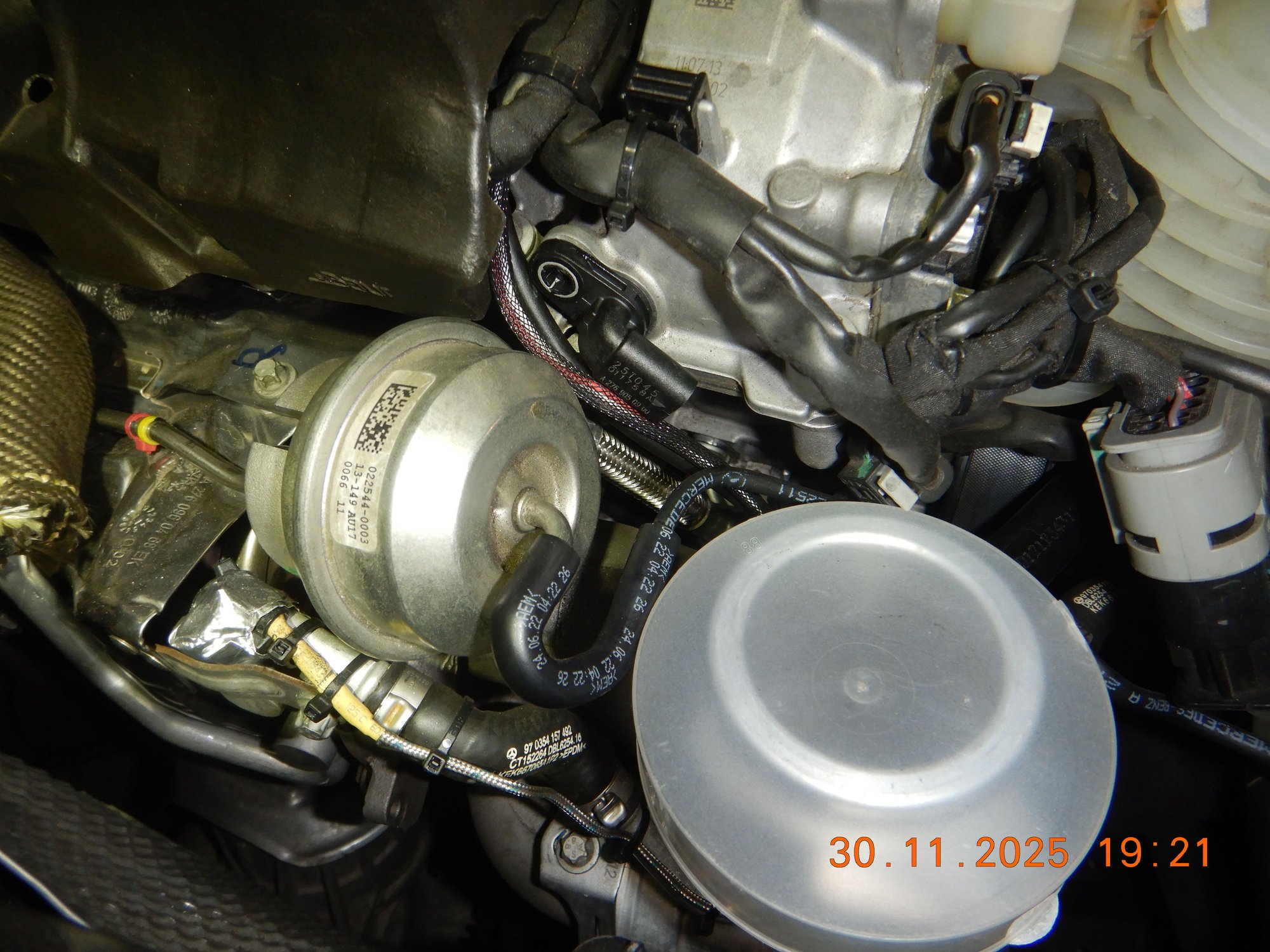

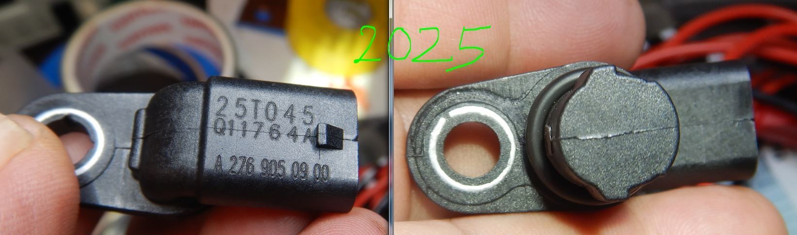

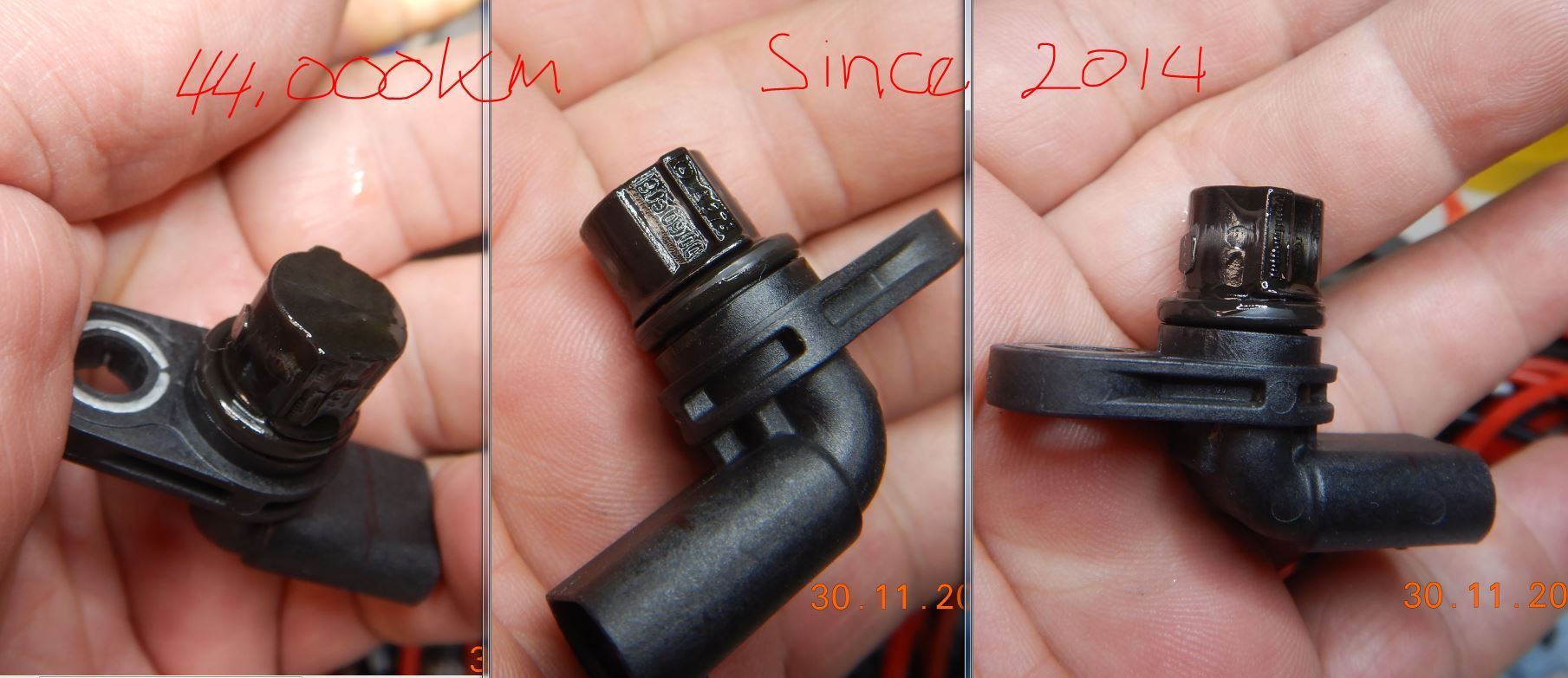

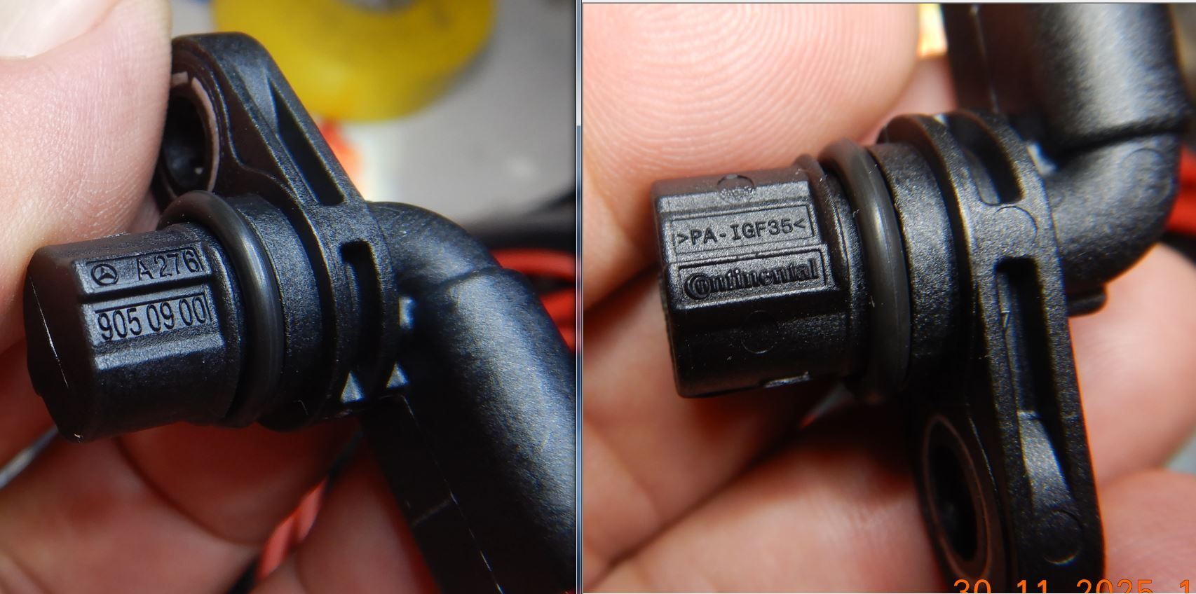

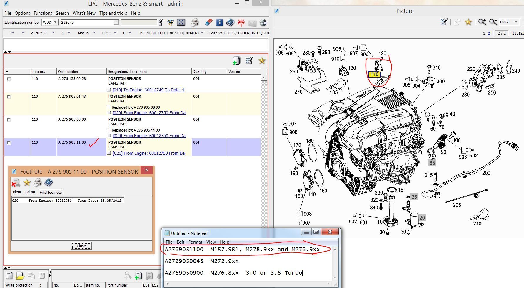

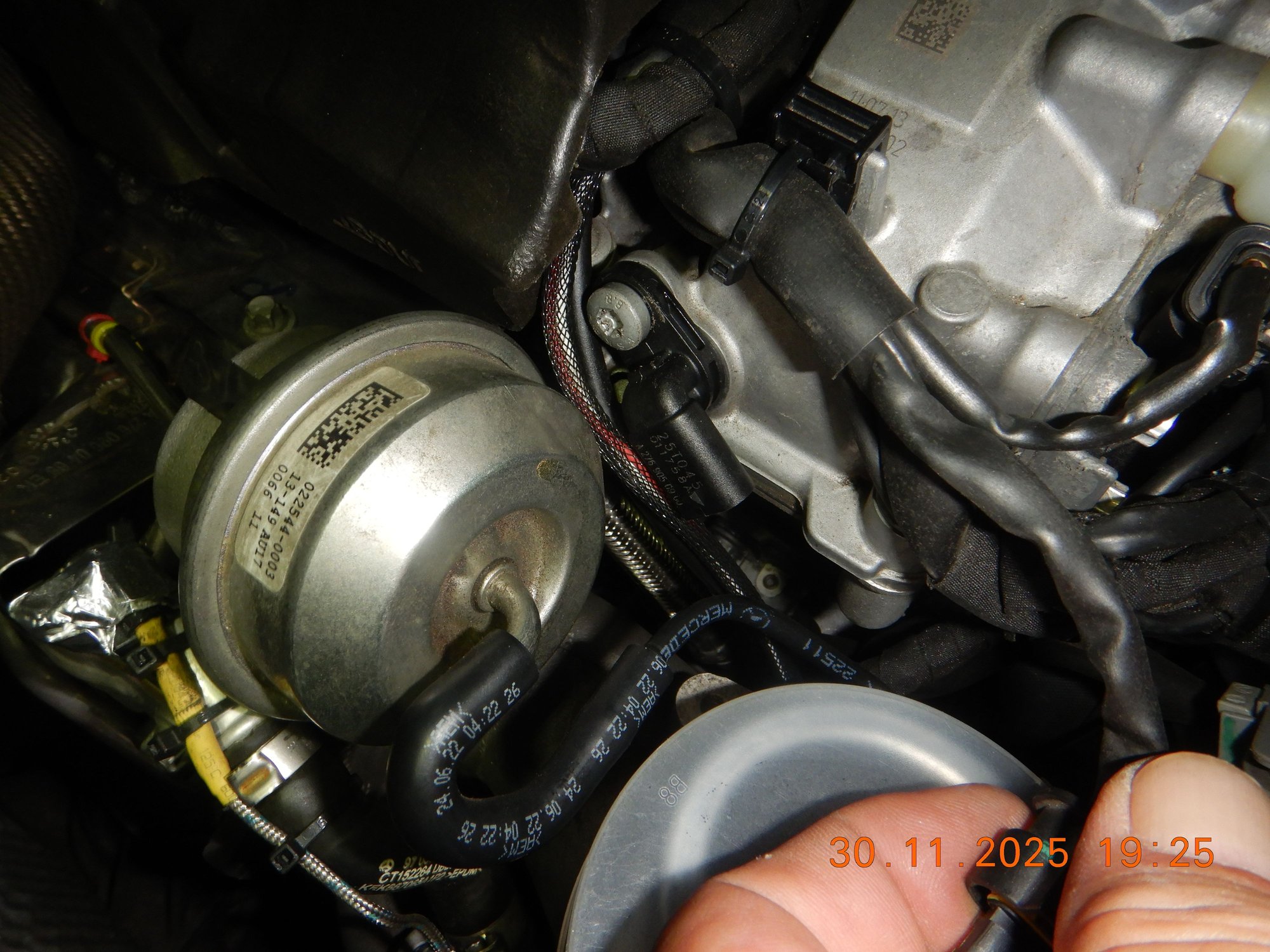

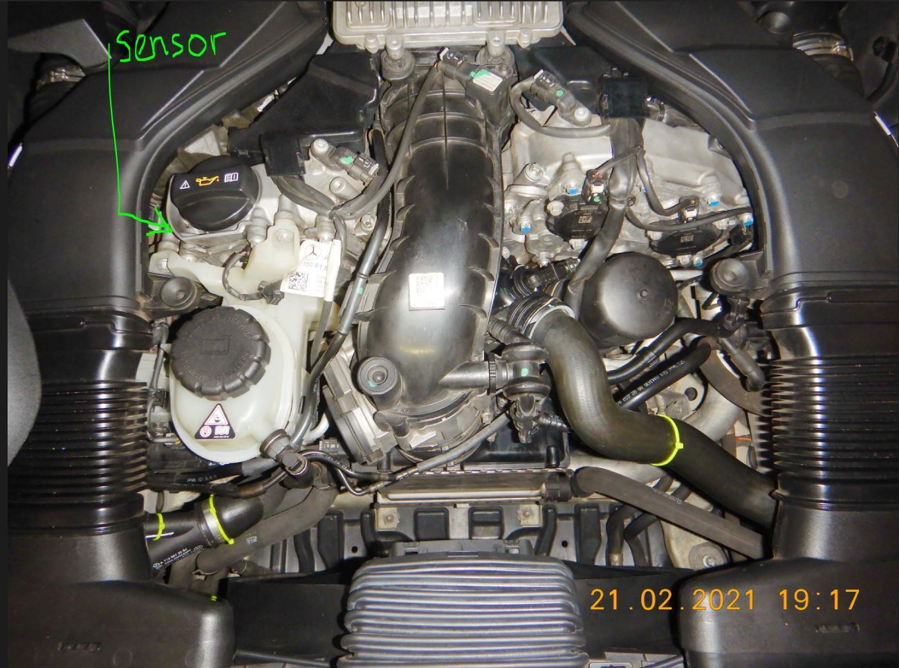

Update........... since my car is now 11 years old, I replaced the 4 cam-pos sensors.
I think specific to M278.8xxx 3.0 Turbo engine , we get the "safer" cam-pos sensor. The part number A2769050900 is only for M276.8xx family.
I am still waiting for info if this A2769050900 or M276.8xx engines can have its cam-pos sensor leaking oil, which M278, M157 and M276.9 3.5NA is proven to be leaking oil.
One month special order...dugghhh.....came about in 3 weeks.

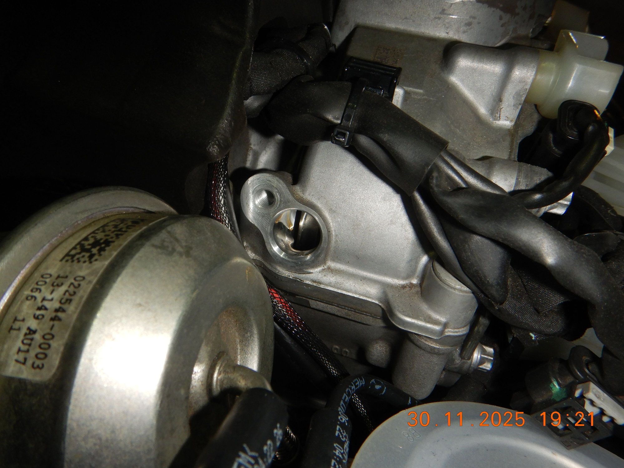

The most unpleasant one to replace. Bank 1, exhaust cam-pos sensor.
The Torx tool get kinda blocked by the turbo vacuum wastegate actuator, that round fat thingy.........

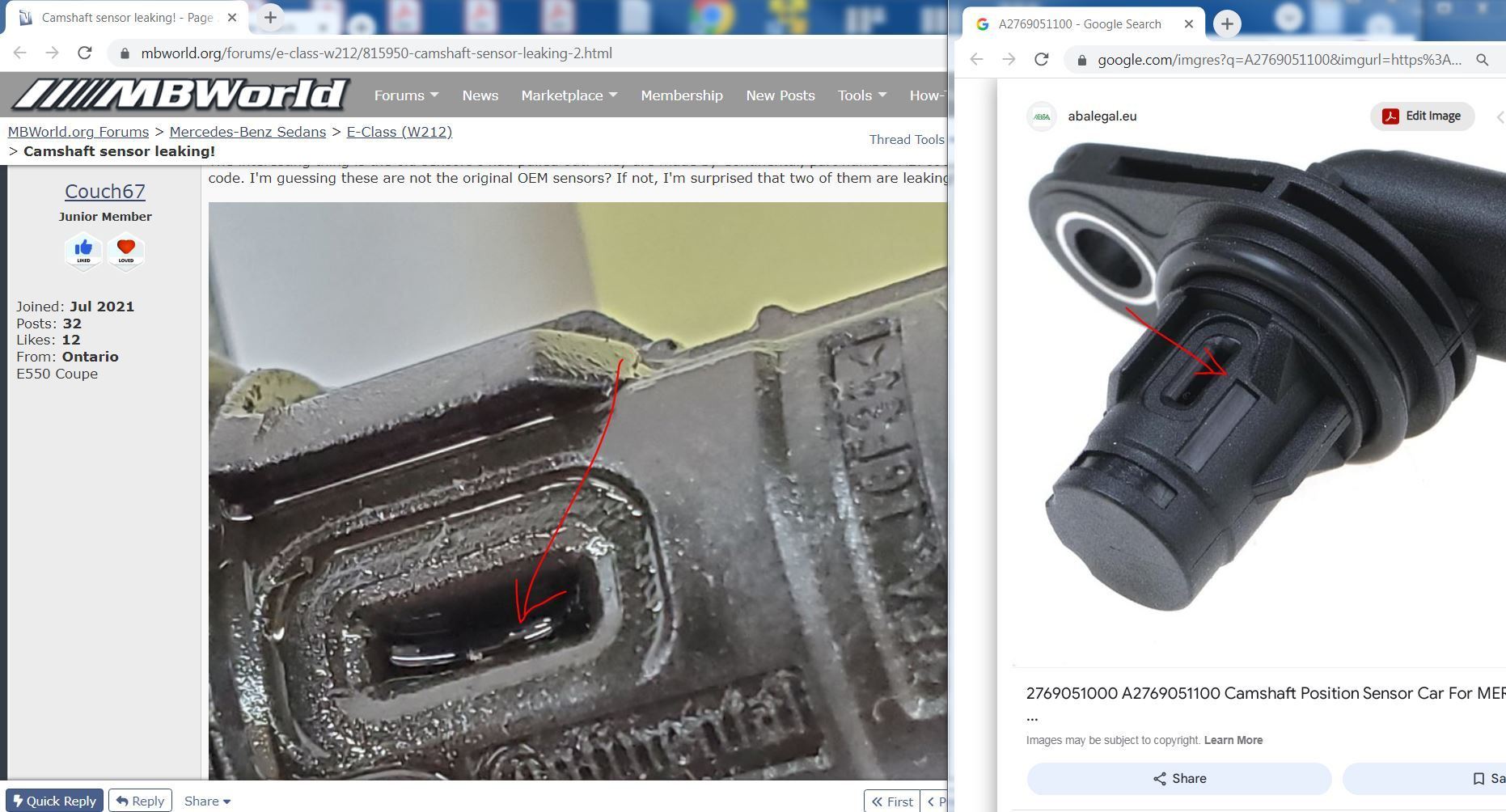

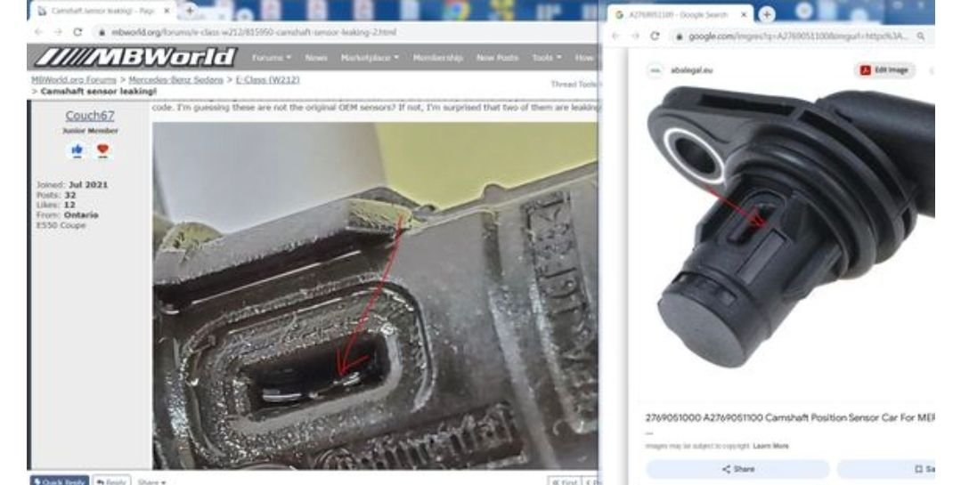

Unless the plastic casing of cam-pos sensor cracked, no way oil can go into it and exit at the male pin terminal.
I notice the type of cam-pos sensor prone to this leak is the one with this unique vent-hole.
P/N A2769051100 and later revised to be A2769051000
Since M276.8xx is the newest of the other trio bunch M276.9 , M278 and M157, I guess that is why my engine get the hole-less cam-pos sensor and my part number never changed.
I guess Continental finally got the resin formula or casting formula or whatever yada yada CORRECT AND they improved for my cam-pos sensor.
Not only Mercedes has this issue, but more common on Mercedes because M276, M278 and M157 are popular engines and M157 AMG engines are famous, thus more "noise".
Any M272 wicking oil out of its cam-pos sensor to ECU ?

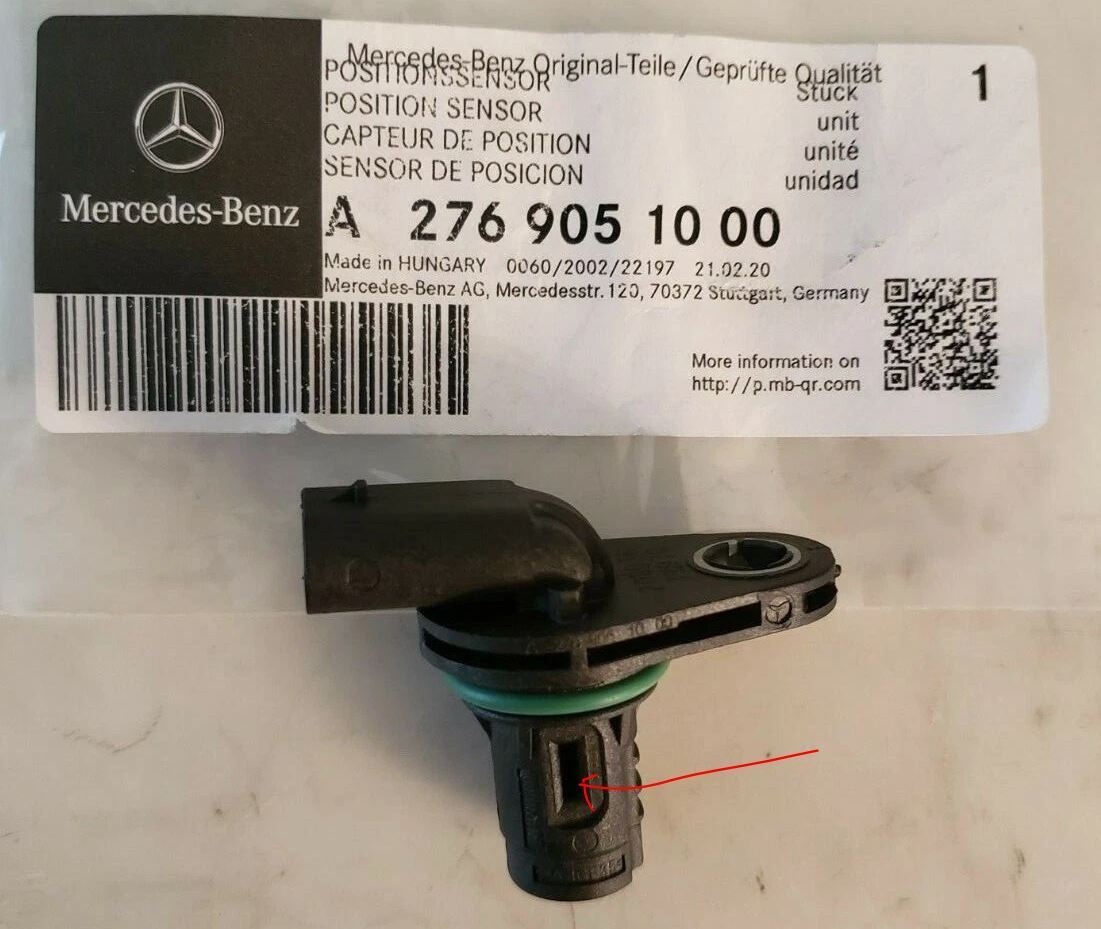

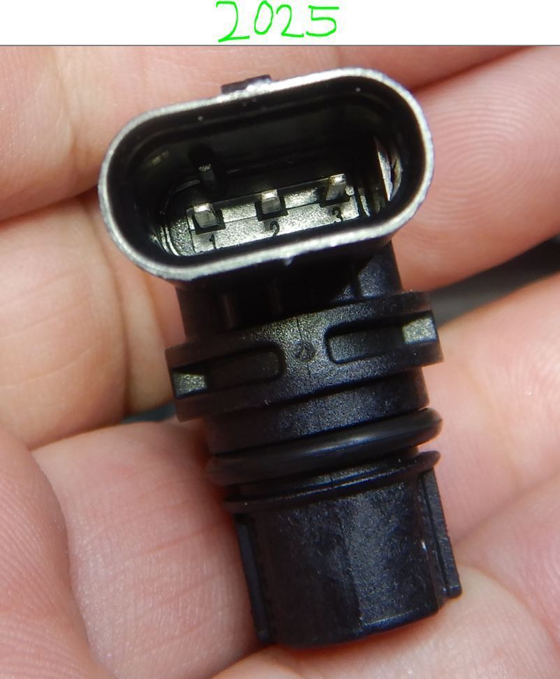

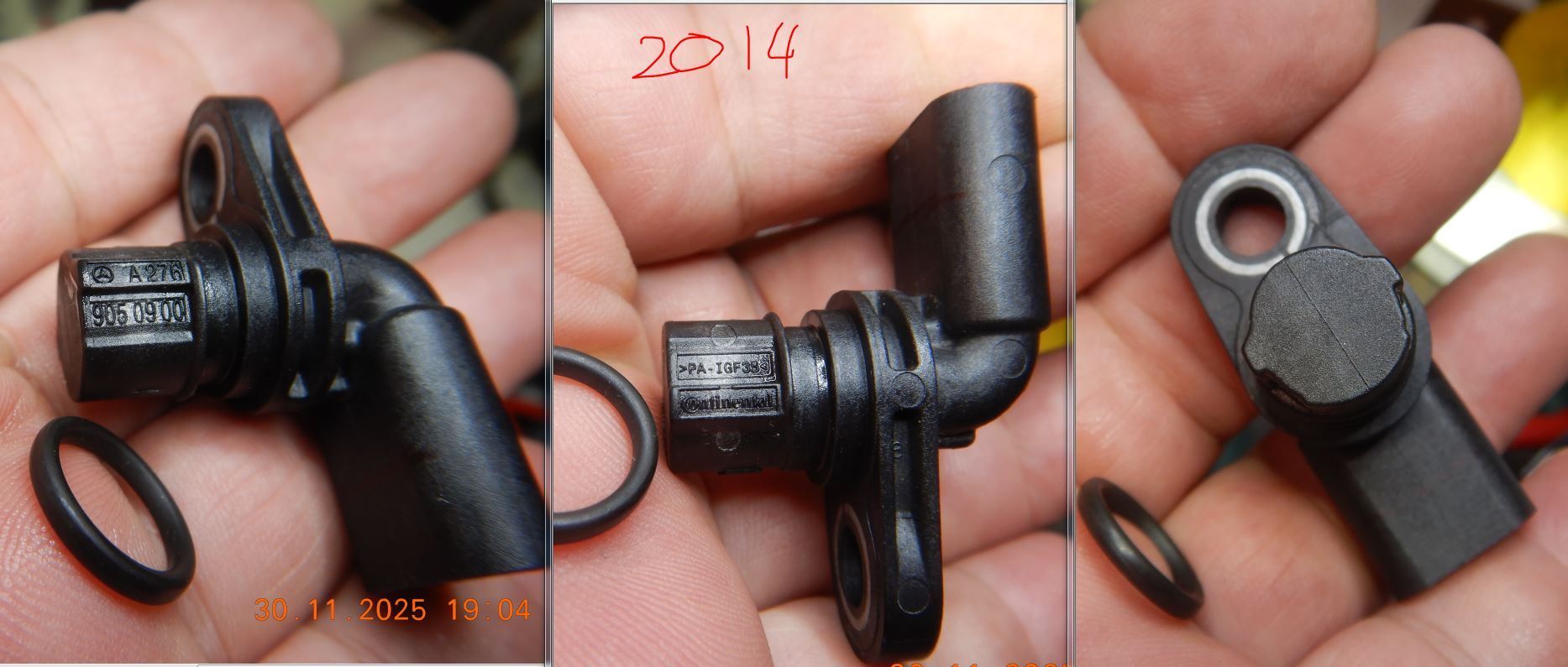

Camshafts Position Sensors
We see M276 TT vs. NA use different CPS.
Lucky the M276-TT features the non-leaking type.
TT CPS: shorter with no slots
RELIABLE 276-TT CPS: shorter body with no slots...
The Continental CPS on M276 NA has been upgraded to reliably leak oil into ECU harness.
LEAKING 276-NA CPS Long slots leak oil into harness
LEAKING 276-NA CPS Longer body with slots that leak oil out into engine harness
The CPS show the nearby steel particulates carried by the oil flow are attracted by the cam sensor inner magnets... that's both good + bad.

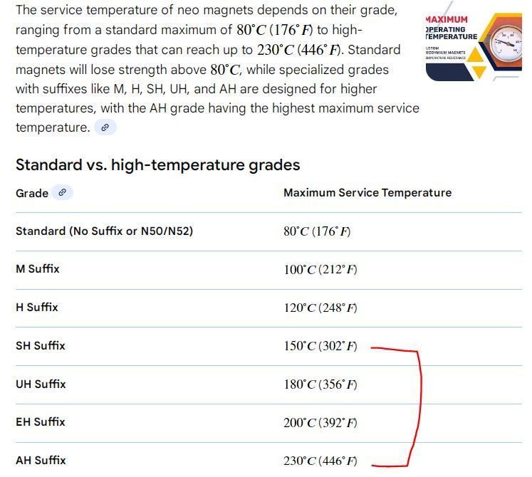

Get a high temp version Cali.

I though you had found a supplier of high temp CPS that could tolerate the engine heat well
I know magnets are affected by heat, I'll be sure to check them in couple month - I wonder how much fine steel was circulating without being captured.

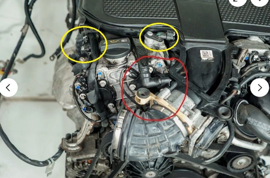

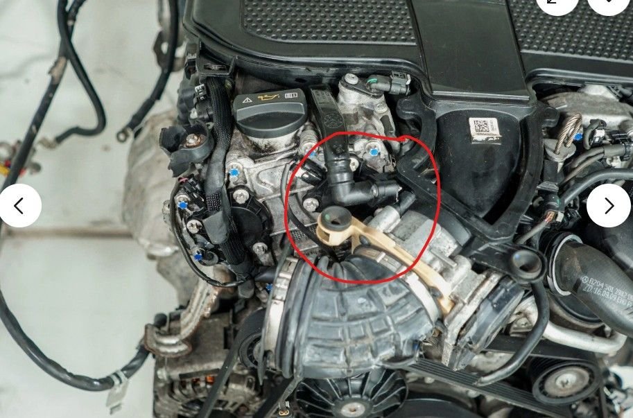

I just googled an engine for W212 2014-2016 and it looks like on the right side when you're facing the engine that the oil filter is in the way of the magnets which can be easily taken out of the way, but on left it looks like some stuff in the way. I am only familiar with the W221 from 2013 S550 but will tell you replacing the cam sensors and cam mags along with installing the pig tails are probably the easiest repair I've ever done on my car. I would recommend that you get new bolts for the magnets as on mine they are aluminum and new ones will come with thread locker preinstalled on them. You never know if someone has previously torqued on them too much and since they are cheap, just get them. Be careful tightening them since they are aluminum they can snap off if too tight then you have to use an easy out to get the broken stud out. On the W221, The dealership sold the pigtail for the magnets but not the sensors, I got the pigs for the sensors from ZZ Performance on ebay.
I don't know the torque specs, just be careful as its not very much. Also when moving plastic parts out of your way if there are any, be mindful that they get brittle with heat and age from the Mercedes engine, sometimes a small plastic part can set you back on cost depending on what it is. It was a very simple job on my W221 though and I wish I could get someone to pay me $900 to do it for them as it would be very easy money.
$900 makes me think that there are some things that need taken out of the way which may be a pain in the butt, however I'm not really getting a clear picture of what they are. I circled it in red on this pic.

The red circled part is the camshaft solenoid. The cam position sensors are on top of the valve cover, circled in yellow.

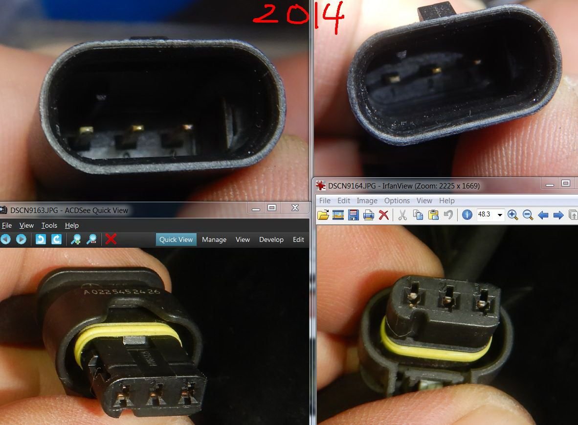

I'm trying to get pig tails for the sensors, but it looks like there are no OEM ones out there. ZZ Performance on Fleabay carries pig tails for the 4.7L engines only. I was able to get OEM pig tails for the magnets, but nothing for the sensors. However, on Fleabay I found sensor pig tails, but not sure if they would work.
https://www.ebay.com/itm/25696983774...Cclp%3A2332490
you can try Amazon as well,

Originally Posted by JCM_MB
Looks like this link is showing connectors for 4.7L engines, which mine is not, not sure if they're different??

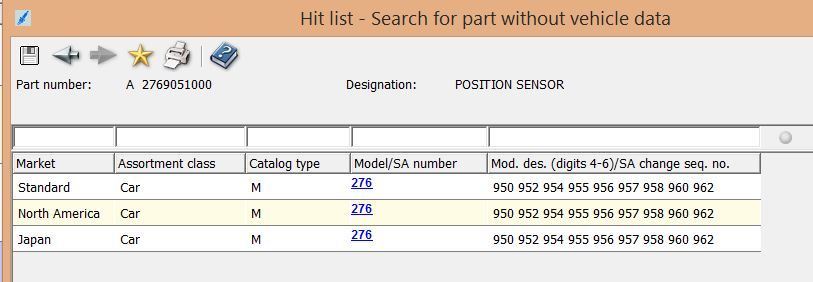

They are the same for the M276/M278/M157 and other engines.
Out of the ones listed, this one shows a compatibility list at the bottom (
https://www.amazon.com/XINSAUTO-Extension-Compatible-A2761560790-A2769051000/dp/B0F8ZVLSNL/ref=sr_1_2_sspa?asc_source=01H78KDR7F0253Y3A38GPXB4C9&dib=eyJ2IjoiMSJ9.SSgyf9GJLscSzdcjTWV8OcesCFL839Fy2eSkDsK8NUsXD6LdByeBNrBtnlGzcvNGU5w6yUUsrcyGT3v7WA8drbn-QVDw4_N83Jzl9YxVvpWQj8LyqKQWSC-CMpdWvDwiF3VaTAD3k6HqT91YWLV8q1GyQzfDuzErI6u179LznBfHqGKOh-Wfbuqc0ukA2V74B02LDulmlMN9ln-IVxCsTWwiUl0d8c2g6oCoD3xdXxY.DxjkWqPfUVEvD2YIO5Cttf6l90xTPB0XqO0l3Prnwuo&dib_tag=se&keywords=cam+position+extension+harness+b+mercedes+3+pin&nsdOptOutParam=true&qid=1767979715&sr=8-2-spons&sp_csd=d2lkZ2V0TmFtZT1zcF9hdGY&psc=1 https://www.amazon.com/XINSAUTO-Extension-Compatible-A2761560790-A2769051000/dp/B0F8ZVLSNL/ref=sr_1_2_sspa?asc_source=01H78KDR7F0253Y3A38GPXB4C9&dib=eyJ2IjoiMSJ9.SSgyf9GJLscSzdcjTWV8OcesCFL839Fy2eSkDsK8NUsXD6LdByeBNrBtnlGzcvNGU5w6yUUsrcyGT3v7WA8drbn-QVDw4_N83Jzl9YxVvpWQj8LyqKQWSC-CMpdWvDwiF3VaTAD3k6HqT91YWLV8q1GyQzfDuzErI6u179LznBfHqGKOh-Wfbuqc0ukA2V74B02LDulmlMN9ln-IVxCsTWwiUl0d8c2g6oCoD3xdXxY.DxjkWqPfUVEvD2YIO5Cttf6l90xTPB0XqO0l3Prnwuo&dib_tag=se&keywords=cam+position+extension+harness+b+mercedes+3+pin&nsdOptOutParam=true&qid=1767979715&sr=8-2-spons&sp_csd=d2lkZ2V0TmFtZT1zcF9hdGY&psc=1

make/female extensions
this is showing male/female pinouts for both 2 + 3 pin connectors.
