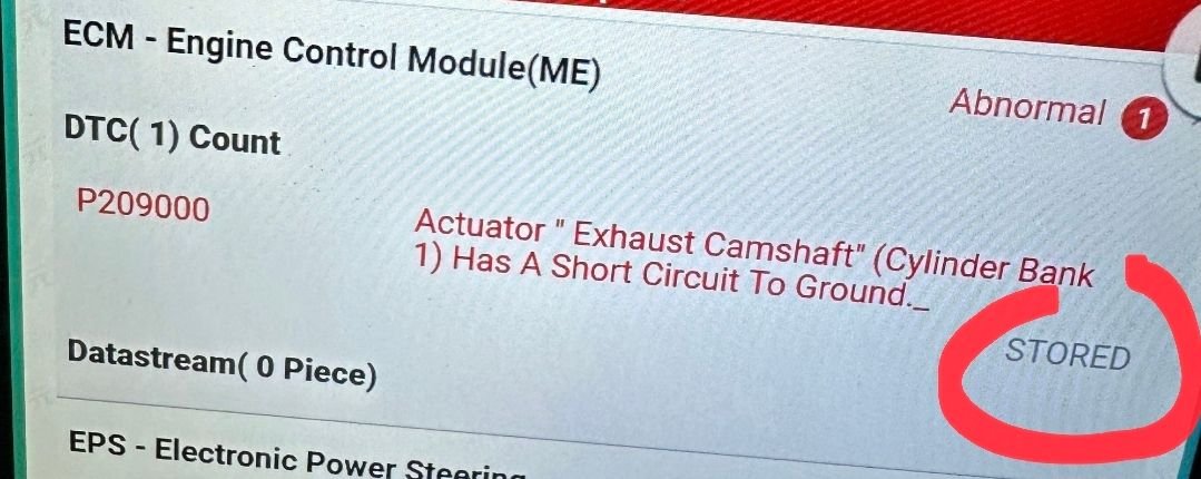

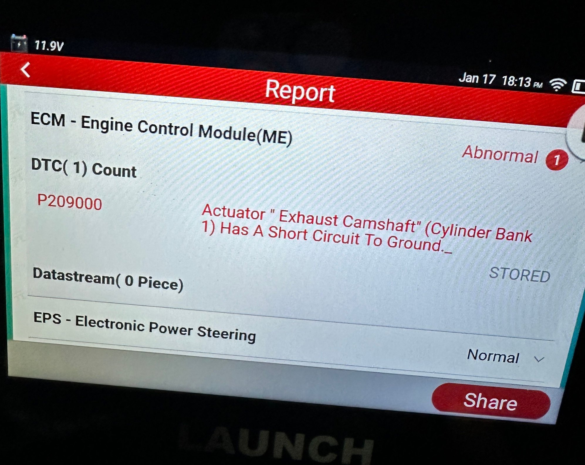

This morning, I replaced 4 sensors and 4 magnets along with all getting pig tails. I did it at a friend’s place when car was warm. I drove it and all seemed well. This evening when engine had cooled down, I wanted to go to a grocery store, but when I started car, it shook and check engine light popped on. I ran a scan and I got this. It was too dark to recheck all my connections, but using a flashlight I went over what was accessible. Not sure if I have a bad part or bad connection.

Take one of the old solenoid actuators, and replace the one closest to the air box (exhaust camshaft bank 1).
If the error goes away, shorted actuator. If it stays, remove the pigtail on that one, retest. Be certain, no wire is cut, broken. Definitely a short.

This transient fault is passed history - It got logged while you had the connection opened during pigtail install... meaning fault is Not PRESENT.
"Short circuit to GND" is the Bosch ECU reporting "missing power supply", not realy a zero Ohm issue.

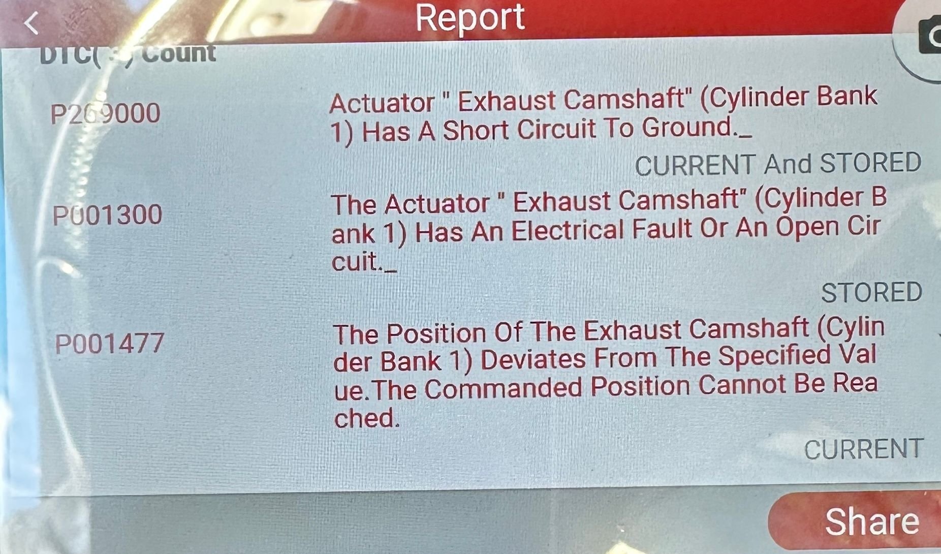

I replaced the pigtail of Bank 1 solenoid, but no luck. I then went without a pigtail and this is what I’m now getting. My original solenoids are at my buddy’s place and he just left town🙃

are you dealing with phasers SOLENOIDS right?
Can you test & compare voltage present in solenoid harness.... it seems your missing 12Volt or bad connector pin contact

The camshaft phaser solenoid is a simple coil of wire wound around a magnetic core.
Electrically it has a low resistance, like 15.Ohms. Its neither an open circuit, nor short circuit either.
You solenoids have been swapped around ue. good solenoid means bad ECU harness side ...
The live ECU harness side supplies 12V on one pin and some GND pulses on the other pin.
Test by measuring 12V from connector to the engine block GND
Compare results with the other solenoid circuit...

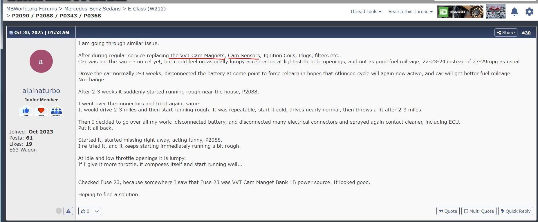

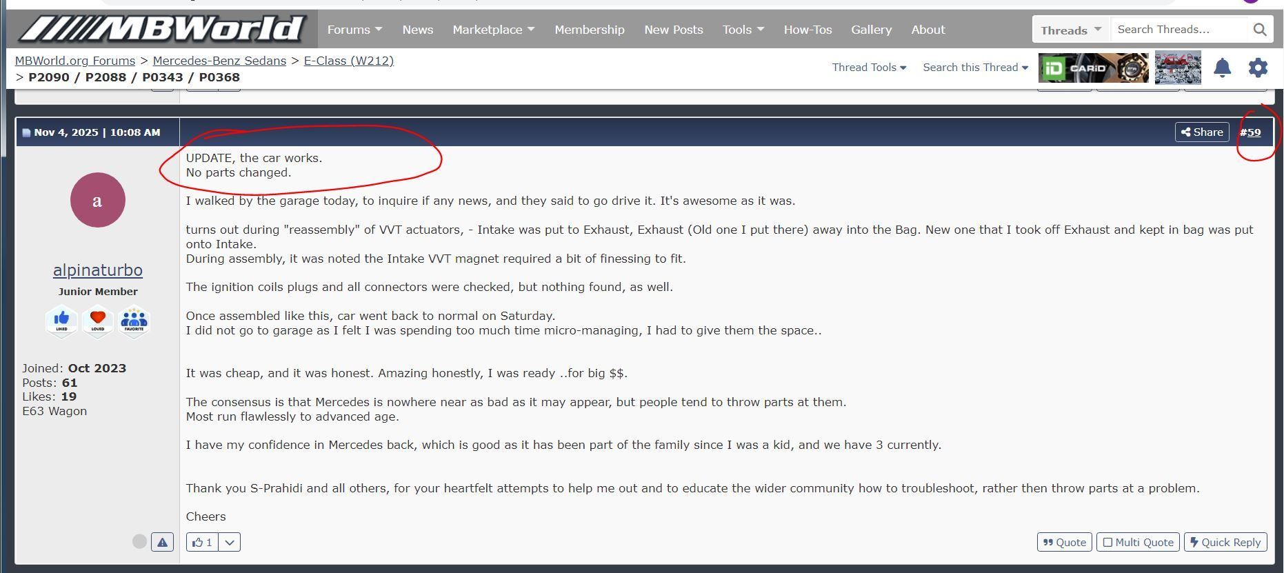

Someone was having similar issue like you........ start from post #59....or much earlier, up to you.
https://mbworld.org/forums/e-class-w...ml#post9230445
The short info is this : A capable person doing DIY on the very same parts you also replaced ( and bit more parts ).
In the end, nothing was wrong at all. Just "bad" install I guess .

Thanks Prihadi, I read his write up, but he's all over the place. If I understood him correctly, he's saying he mistakenly plugged intake plug into exhaust and vice versa. Not sure what he meant by "put it in the bag." I drove car to mechanic shop and left it there for them to figure out the problem. It shook and rattled and almost died out, but luckily I made it there
