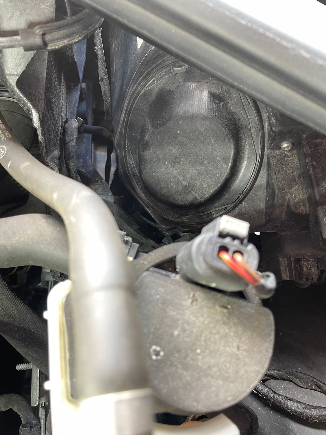

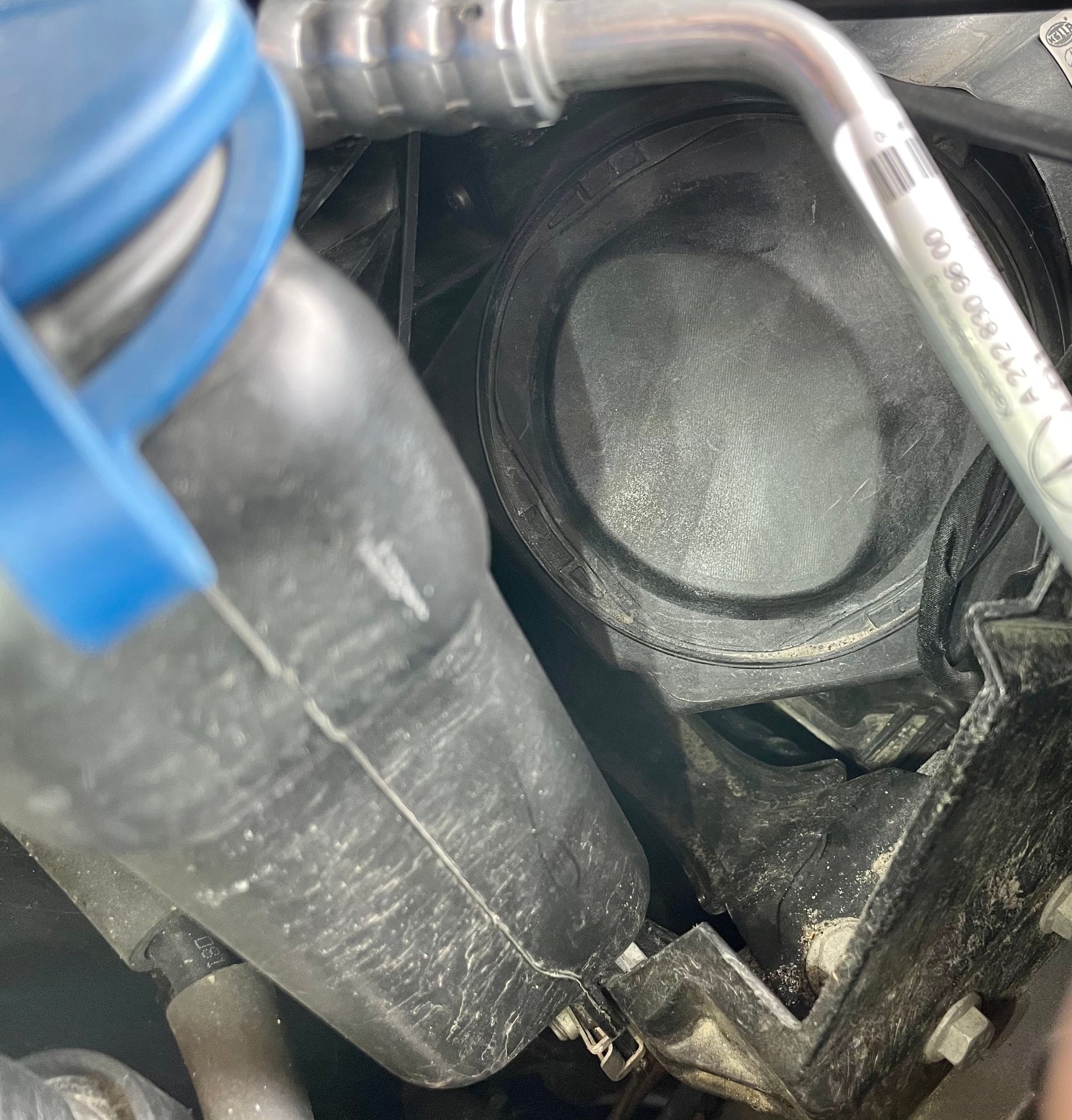

Looking to replace low beam lamps on a 2015 E400. Every instruction set I’ve found refers to twisting of the back dust cover by the raised handle running down the middle of the cap. However, my caps have no such handle. Nor do I see a pry point or any gaps. See pictures. The cap and housing appear to be one molded piece? What gives? Anyone seen this before? How are the caps removed?
Thanks ​​​​​​for any info or help you can provide
Passenger side
Driver side

Is it possible you have LED headlights… those wouldn’t need access, since the LED are likely not replaceable (besides entire headlight assembly).

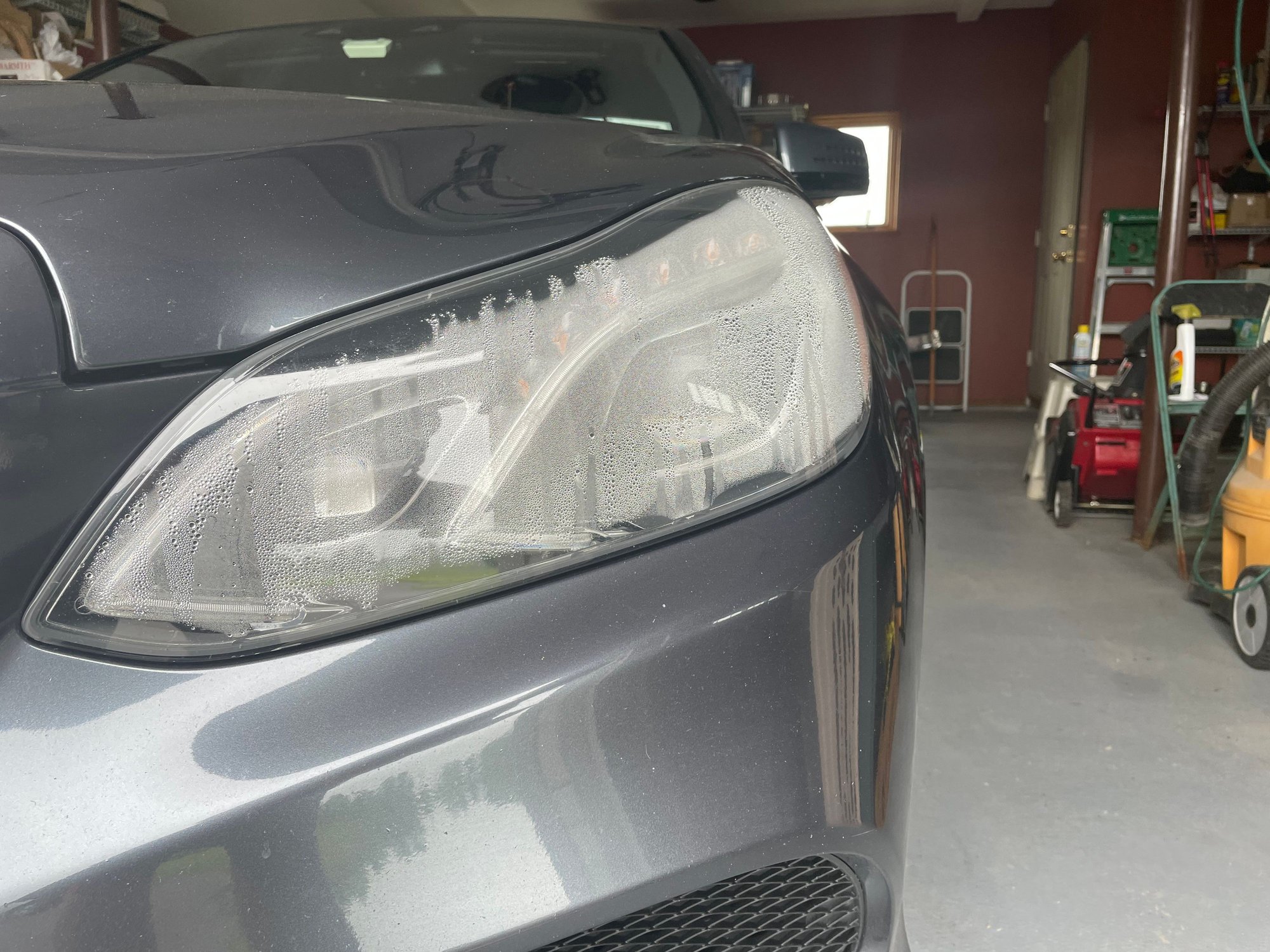

do the front of your headlights look like this?
If so, those are the 'intelligent LED', and have no user servicable parts inside.

That’s them. Thanks. Dealer wants $3,800 each. I’ve got to at try something else.

You're going to need to source the entire assembly, and yes the dealer is not a good option. You can try eBay for OEM used units. These will need programming to the car which will require you to find a mechanic with the proper computer to do that.

Just short of replacing both lamps, I would install permeable patches first and see if the issue improves.
The ricer crowd uses something called a breather patch on the back of each lamp housing to allow moisture to escape.
It requires the removal of each lamp and drilling small holes in the backs of each housing (one high/one low). I would warm the housing while pumping compressed air into each drilled hole until the the lens clear somewhat, then cover each hole with a permeable patch.
it's a big job to remove and reseal those clear lens; you can always approach that project if the leaks are excessive. I haven't had mine off the car, but most lens are sealed to each housing with a butyl caulk. it typically requires heating (200-300F) to soften. AliExspess sells replacement lens for some Benz models.

I really appreciate the info and perspectives. I’ll need to ask dealer for an install price and buy the units online. The videos I’ve watched show the removal of the headlamp assemblies to be a lot more involved than I trust myself to do. The required programming after the change seems to be a procedure only a dealer can do?
The kicker is that the driver side has a LOT of moisture but seems functional except the auto dimmer (car keeps throwing an error on the middle screen) BUT the passenger side lens is clear and the low beam isn’t working.
