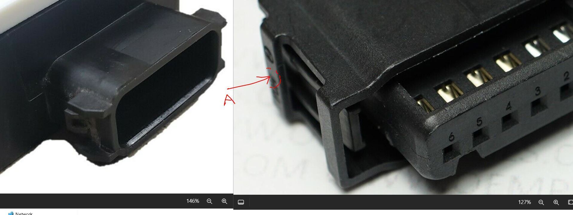

I tried to remove my radar sensors today ... I can easily reach them from underneath, but I couldn't figure out how to remove the electrical connector. The video says "push both sides in" (I think). I didn't have any luck trying to get the connector off. I thought I'd drop the sensor from the holder to access the connector better, but I couldn't figure that out either. (I did reference the AR54.71-P-0100EW document.)
Any ideas how to get the electrical connector off, and then drop the sensor from the holder?

I shall teach you a trick on how to find ways to open up unknown connector, usually it will work.
First go to EPC to get your radar P/N, the correct one.
Then you go to ebay and take a look, often their image is of very high resolution and the connector locking mechanism sometime is visible.
Example here image #6 : https://i.ebayimg.com/images/g/U9QAA...9d/s-l1600.jpg
May not be your exact P/N, but you will get what I mean.
2nd method is, at the same EPC, the connector P/N for radar may sometime be shown, you then search for that P/N too for its high resolution image.
Your issue is most likely a crusted up connector.
So basically its like being "glued" by crusty.
If the video I linked at post #26 is the very same radar module on your car , watch it slowly as the connector design is so clear there.
https://mbworld.org/forums/e-class-w...ml#post8564491
By looks of it , the locking mechanism of the connector is indeed the push in type to raise the locking lever.
https://www.ebay.com/itm/255521380811
It seems the A , I marked in red is where you must press, and only A region.
Have a try.....

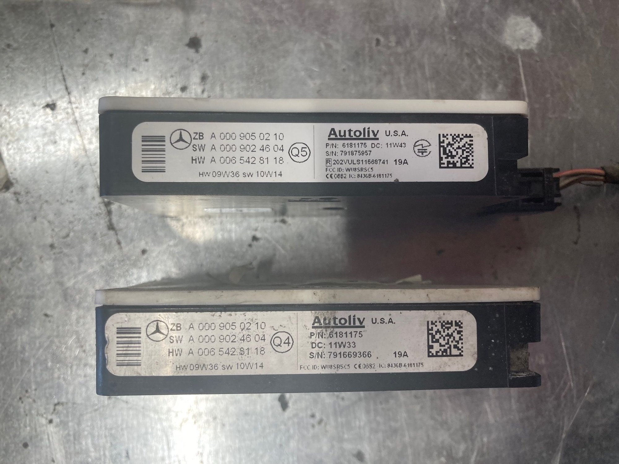

Just a follow up. I purchased a used Radar Sensor and it works fine.
Thanks to @konigstiger and @S-Prihadi for their help here!
In this image, my original is on the bottom. You'll notice what numbers are the same to ensure it is plug-and-play.
