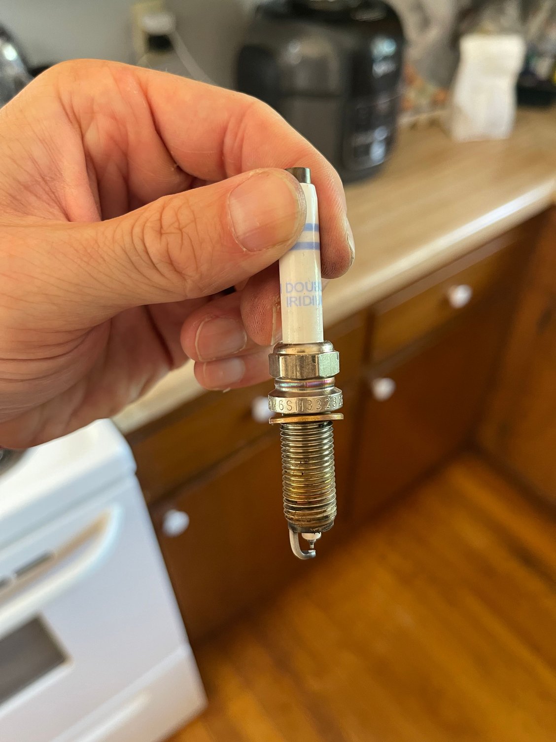

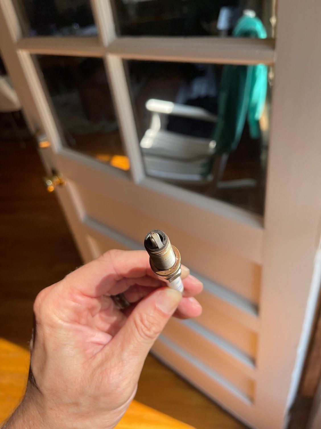

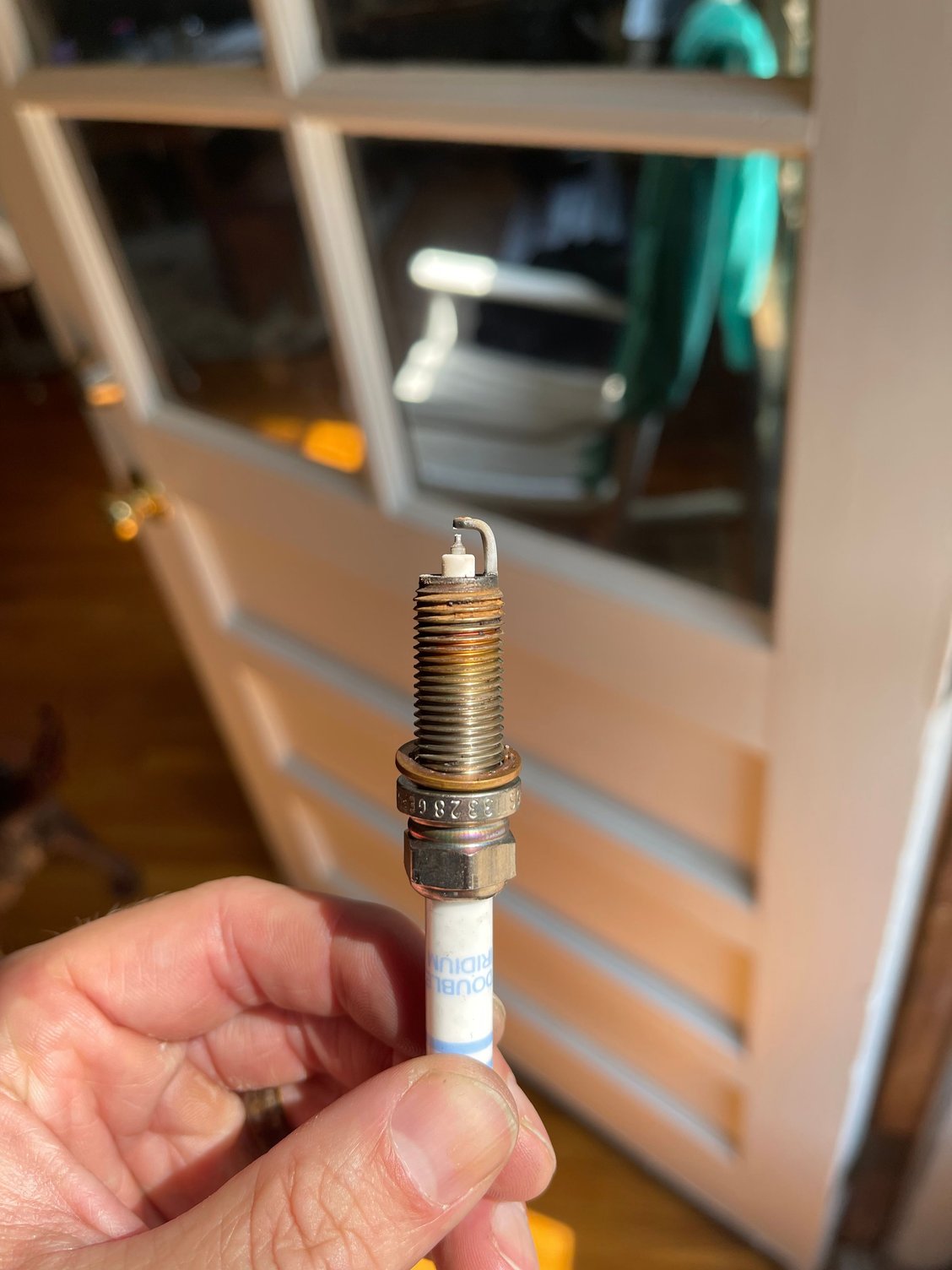

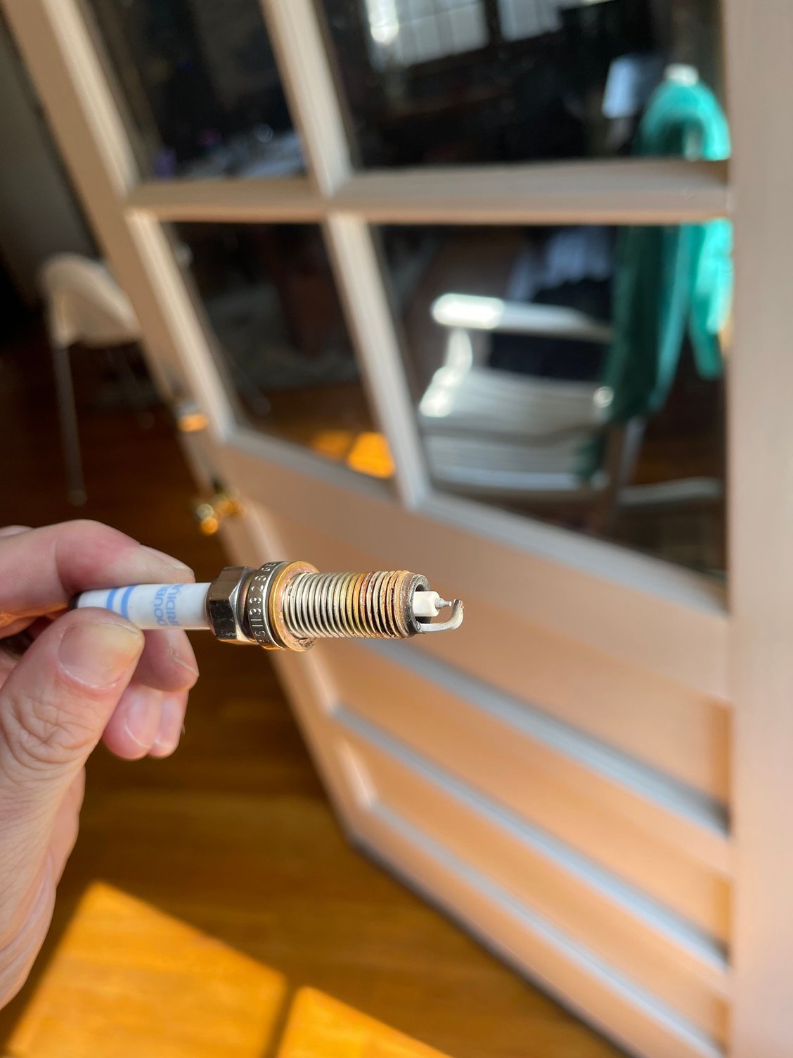

So my question is this, I pulled a spark plug, and it is a Bosch V6S113328.I do know my vehicle is the flex fuel version, so the plug doesnt surprise me but I cant tell if it is a factory plug, or if they have been replaced before. Im not great at reading plugs, soI am going to post some pictures and hopefully some of you can help me out!

Buy plugs from dealer (based on your VIN) and properly torque per MB spec... this will avoid any issue with "improper" index of plugs. IIRC, plugs are different for flex. As far as the transmission it could simply be adaptation, based on PO driving habits. That said, it wouldn't hurt to service the transmission if the history is unknown... should have been done at 70k. A couple hundred dollars for peace of mind if you do it yourself.
The original plugs would have a MB logo (star) on them, so I would say the plugs have been changed.
MB OEMs Bosch plugs, so the Bosch ones should be fine.

Originally Posted by ghlkal
Congratulations, and good luck with your E350. Enjoy it
While Bosch is the original maker for the plugs, it seems that what they ship to the Mercedes dealers is different than what they sell directly to the aftermarket as noted by several threads. That's why there's the recommendation to buy the plugs directly from the dealer so you know they will index correctly. Or if you get Bosch plugs from an aftermarket source while they're cheaper, make sure you check the indexing on the plugs to make sure they line up right.
