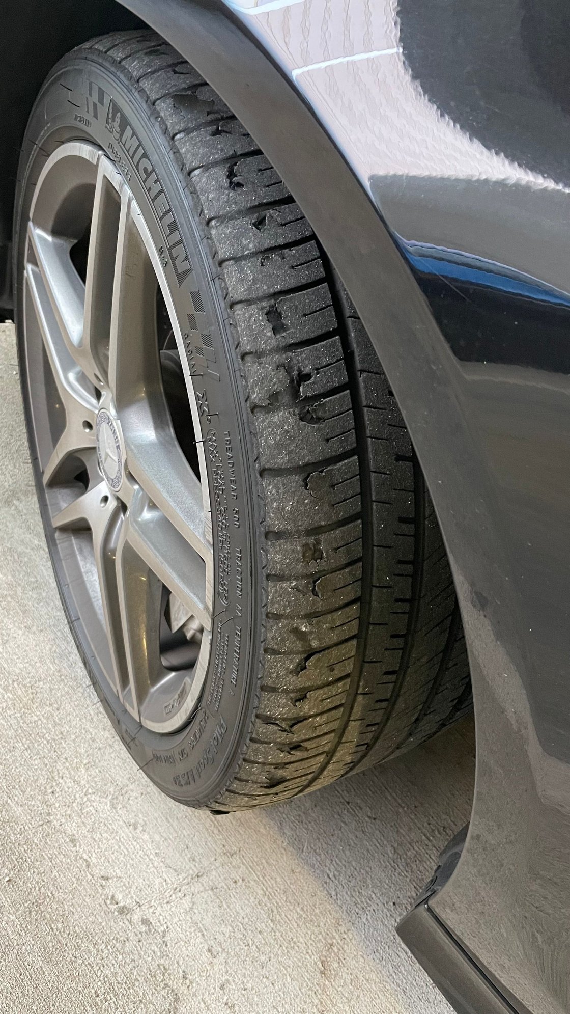

Tire issue 2014 E550
2014 E550 4matic Sedan M278 engine
Im not Jedi when it comes to tires so any advice/help would be awesome. Here are the details..
  • These tires where on the car when I purchased it.
  • Michelin Pilot Sport A/S 3 radial X
  • 245/40ZR18 all 4 tires are the same
  • All 4 tires are filled to 38 psi cold
  • I do drive aggressively, like a bat out of hell. I guess I just like hearing the exhaust
I did notice when I looked at the side wall that they are "X" tires please see pic and I believes the car requires "XL" according to the Discount Tire website
They are wearing evenly but only the front tires are having this "Chunking" issue. Is this common with all season tires. I have been told that I need to replace with the oem - Pirelli P Zero. Just wondering if anyone else has experienced this issue? Please see attached pictures

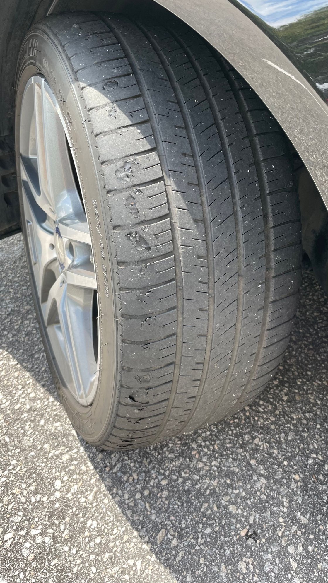

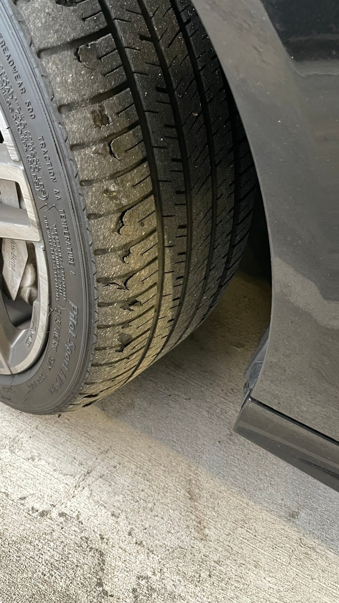

Yes both sides are like this/ identical. Just driving around the streets and highway. There is zero vibration or shake the car drives beautifully and performs amazing, I had an S class before this and I replaced all the air struts and suspension components so I’m very keen to look out for things like that which also showed me how smooth the car should drive and I’m very impressed with the E class. I just can’t wrap my head around why these 2 front tires are doing this. On a normal street I take turns to where the car is comfortable on the inside and stays level but when I come out of the turn or on the highway I do accelerate fairly quickly. The only time I noticed the car have a slight vibration is a sweet spot around 93mph after that it’s smooth sailing
The car has 75,000 miles
I took a better picture to show how the tires are wearing evenly except for the chunking
Im going to discount tire next week and purchasing a set of 4 Pirelli P zero’s which will come with warranties so if this happens again I’ll be covered and just to be on the safe side I’ll get an alignment after the tires are put on but I doubt they’ll have them in stock so I will have to order them in the mean time I’ll get the two front tires checked to see if they’re balanced properly since they haven’t been since the purchase of the vehicle I just didn’t think that would be an issue since it came from a Mercedes-Benz dealership

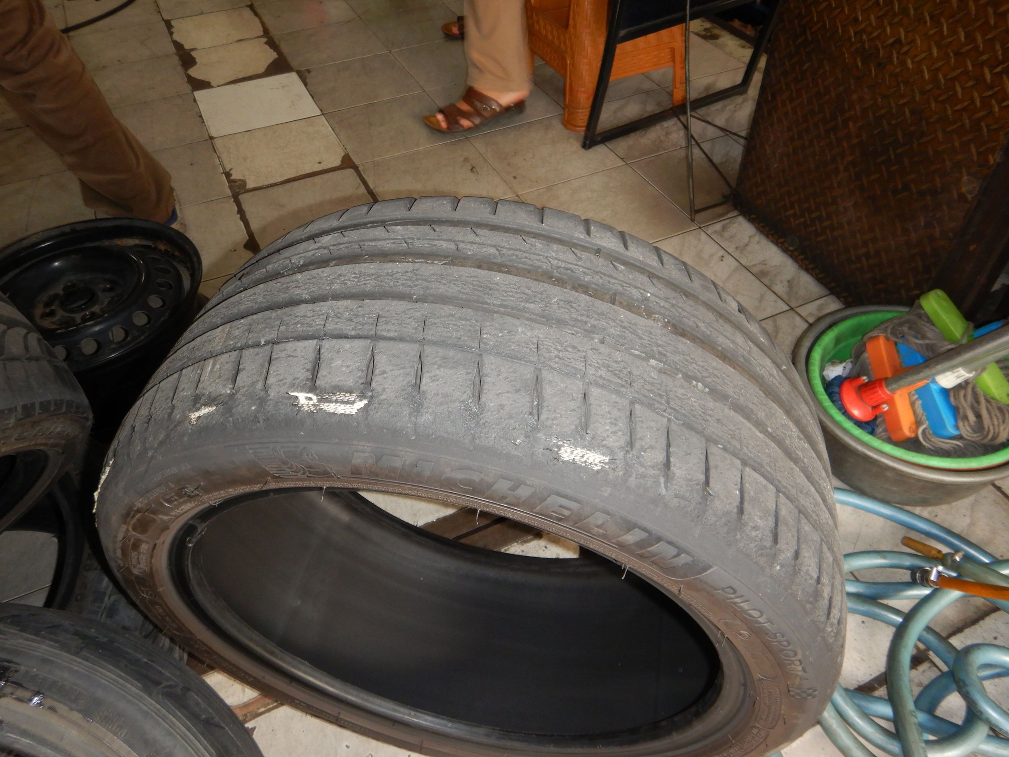

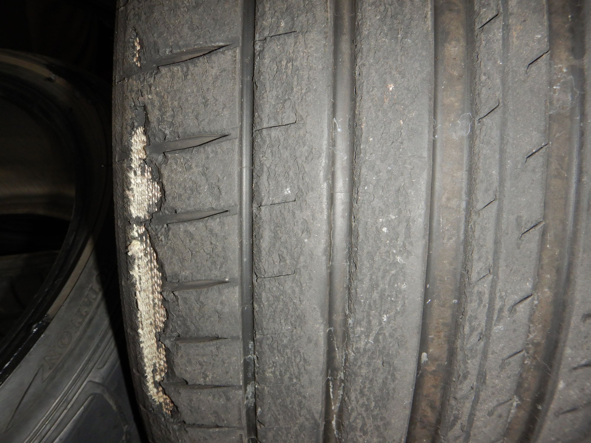

I think the Michelin Pilot Sport A/S 3 radial X compound is rather soft, compared to Pilot Sport 4.
It should not "chipped" out like that while the rest of the thread look so "polite-ly consumed"...at least it wont be the case if it is the Pilot Sport 4. 4 only, not 4S.
You are decent on the cornering, not hard enough as you would be on the track, it is just the tire side is not holding up well. Above is 20 laps front tire on the track as spirited driving only and not racing, Mic Pilot Sport 4. 20 laps = 60 KM.
See the wear on every running surface of the tire at least 70% from outside to inside ? Yours is still smooth.
Dont get P Zero, get Mic Pilot Sport 4 or the 4S if USA has 18" version.
Below is approx +-10 laps at the track, much milder driving mode. FRONT.
REAR
REAR
My light weight Ford Fiesta 1.6L. FRONT. Same Mic PS4 tire.
Ford Fiesta. FRONT
I think with V8 engine, your car front weight is heavier than mine. So your front tire work harder, no choice.
Typical E Class , E400 W2120.65, Pano Roof, Right Hand Drive corner weights.
The light weight Ford Fiesta and is a Front Wheel Drive. Also Right Hand Drive.
If 75,000 miles and if it is not air suspension, get a Bilstein B4, no need upgraded spring. B4 is civilized compliant ride and sticky too, along with Mic Pilot Sport 4.
Have fun....
