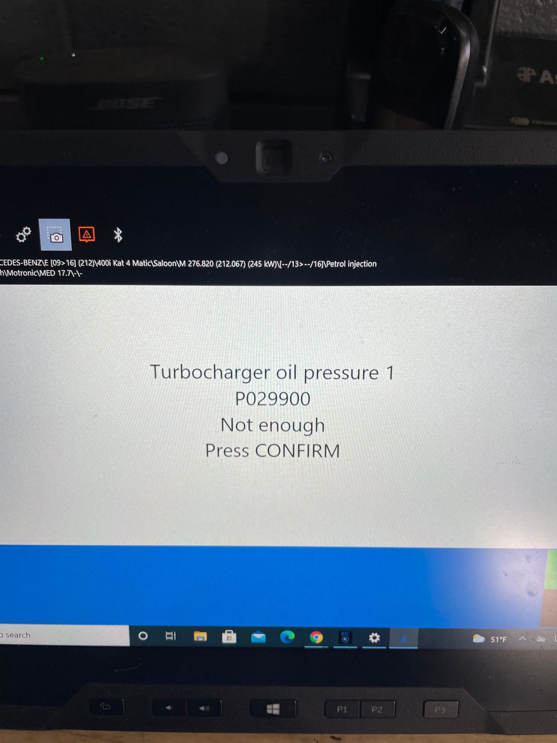

Hello all, an update. Took it to the independent and he found this code (see pic attached): P029900. Apparently, I had too much oil in my engine, and that is throwing my turbos off. He checked my oil levels and they were WAY higher than they were supposed to be. He did a drain, a full oil change, and added an OEM filter and he says that should help. I got it done around 2PM EST.
Its now 1AM EST and after a few hours of putting turbos under heavy load and highway cruising at 85-95mph, the car has not gone into limp mode. Everything seems to be fine (for now). Can anyone chime in, is that possible for too much oil to mess with the turbos like that?

You'll kill a motor just the same by overfilling it as you would underfilling it. Oil level absolutely matters.

How did oil overfilled occurred in the first place ?
This 3.0 TT takes in only 6.5 - 6.7 liter of engine oil, with oil filter change.
I hope it is not fuel dilution into engine oil, which is not so obvious by look (if say only 0.5Liter )compared to coolant dilution into engine oil.
I seen a 22 liter engine oil capacity big marine diesel, overfilled by 4 liter and the aftercooler clogged.
That engine design was using aftercooler vacuum for its diesel fuel injection governor system for final WOT RPM .
So the clog caused the engine to not able achieve WOT, that simple. It was a 1995 680HP V8 MAN, non electronic, purely mechanical.
I don't really know how 3.0 TT M276 oil vapor separation would handle overfilled engine oil, but if also your aftercooler get oil load, do keep this in mind
when next troubleshooting.
On M276 3.0TT, there is a Y31/5 turbo pressure transducer.
See page 5 of the attached document
Its easy to remove and undo the hoses, maybe take a look if those hoses internally are wet with oil.
oh that makes sense, and another day has passed of putting it under HEAVY load, and normal cruising and nothing has happened. I know its only been a full 24 hours, but so far so good. Hope it's permanent.

I will check the hoses on my next free day, and to be honest I'm not sure how it got overfilled. I got an oil change from the actual stealership about 2 months ago and everything was fine up until the incidents. Thanks for attaching this so i can see it!
