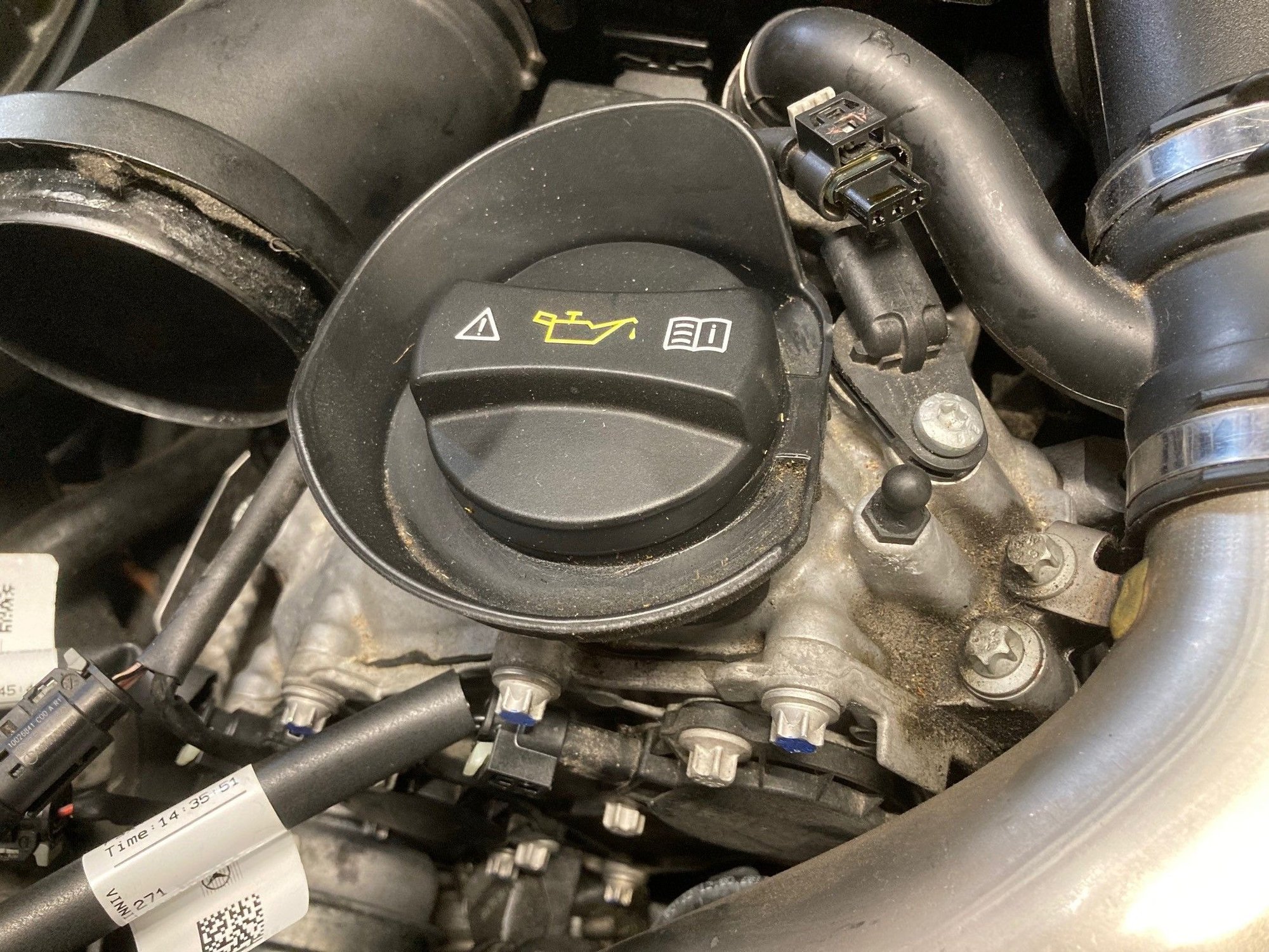

Regarding manifold oil issue contaminating the PCM thru wiring, I've installed the pigtails to the 4 camshaft magnets. They are a 2 wire. The two cam shaft position sensors are a 3 wire. Does anyone know if pigtails exist? If so, what is the part number and purchasing source? Thx.

Pigtails exist. Part numbers are posted on this site. Search function will find them.
And the permanent fix for oil in the harness is new cam position sensors and new cam magnets. 8 pieces replaced. Pigtails were the first field stopgap fix.

I hadn't noticed the difference between the magnets and the sensors. You are correct, the magnets are two connector while the sensors are three connectors (as shown in my image)
I installed the harnesses on my magnets - part numbers in this thread https://mbworld.org/forums/e-class-w...age-issue.html
My sensors are clean and clear so far, so I didn't look for those harnesses.
If you find a part number for the harness, post it here for completeness. Thanks.

That picture is how they look like right now? If so you got oil on the connector.

Hmm ... I wiped them off and they were clean with no sign of oil. They may appear a little wet since I sprayed contact cleaner on the connector. I sprayed off all the connectors after checking them.

The oil travels thru the holes in that connector. If you have not swapped those sensors, please get them done.
Run a q tip on those holes and where they meet on the sensor, and you may see oil on the q tip.

Yup, I wiped both connectors with a Q-tip and lint free cloths -- no sign of oil
I also sprayed them with electrical contact cleaner.
