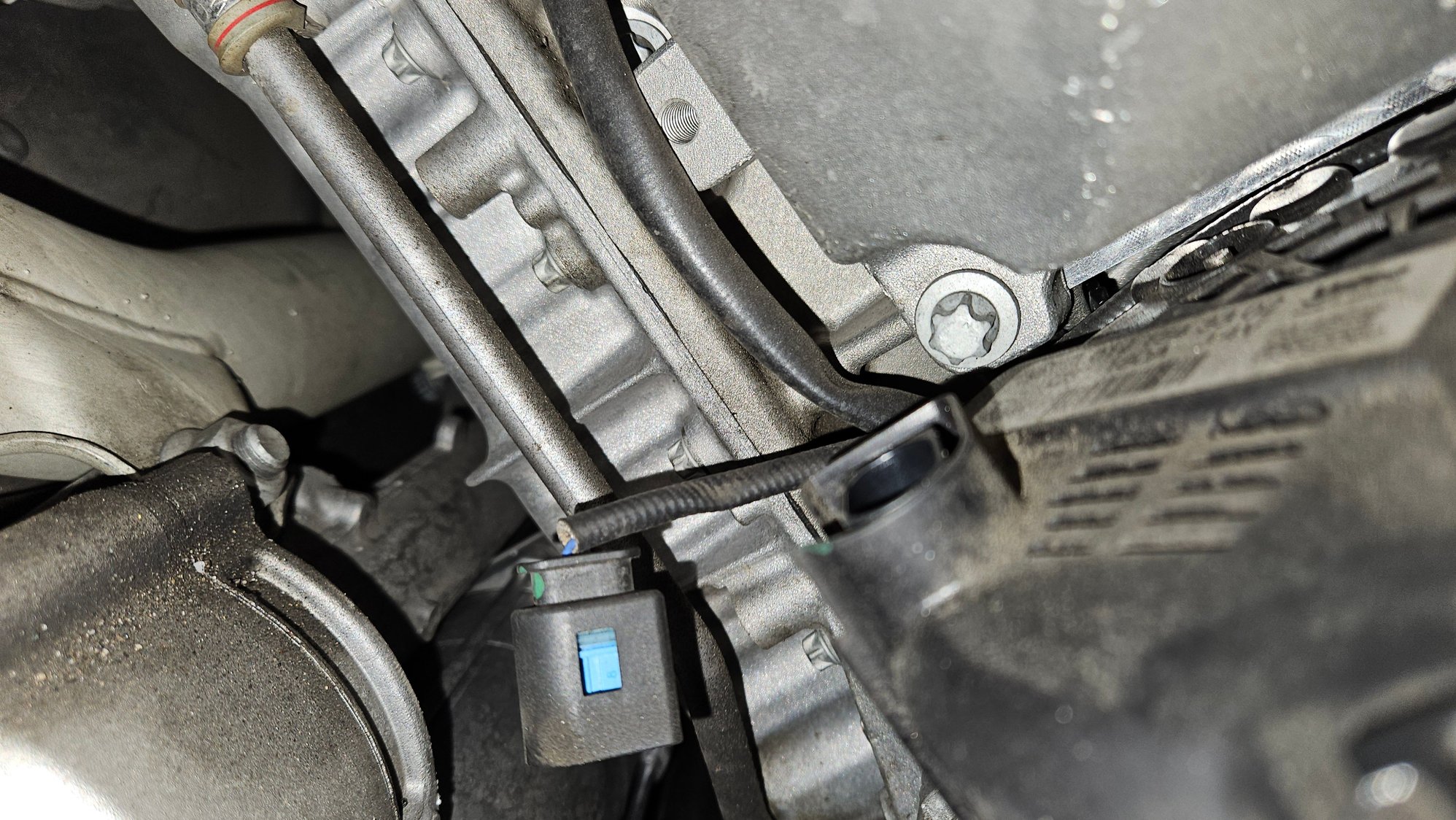

Alternator started giving issues with randomly stopping charging, getting me stranded while getting back from work, only to charge battery fine after next start-up (and a battery charge). I was removing undercover to see how I'd remove this guy from the tiny work space and saw there was oil leaking from the cover plates. Opened the hood and saw plenty of oil and dirt deposit on the motor. Saw some place where it was more liquid, indicating it was closer to the leak. Removed the driver side turbo intake and saw this small kind of cap behind the belt. Seems like there's a small pool of dirty oil there. I have no idea what's this part is (only a DIY working on it when absolutely needed and having to follow tutorials found online). I also realized the turbo intercooler is leaking, again. Oil and dirt spread everywhere and the alternator is a mess. With some luck a simply cleanup will fix it, but I still have to figure out how to take it otu with the least amount of work.
Since the car has been knocking for almost 85k miles (now at 340k KM or about 211k miles), has main electrical harness issue, transmission slipping somewhat under hard acceleration, fan for heating/climate control randomly not working for 2-5 minutes about once per months before starting like magic happened, I simply want to get a few more months before I need to remove it from the road. Having had too many issues IRL job/covid/etc to be able to afford another even if looking at used market, so it's hard to say goodbye to a car so comfortable to drive. I know next one will not be anywhere near this E550.
So, anyone is able to tell me if this kind of cap could be the oil leak culprit and if so, how is it called? Simply need to unscrew it after removing the belt?
Also, if someone knows if I absolutely need to remove the radiator to get the alternator out, I'd liek to know as well. Trying to avoid this due to working outside in the cold (-5 to -20 celcius).

So, have to fix the alternator so I went in and drained coolant, removed fan and am close to being able to remove the alternator now.
Looking at it, I can't see anything wrong. It's clearly brand new, shows no sign of wear and tear and didn't see any dust from road nor oil leak!

Well the no wear and clean was a joke. If you look at the picture, you'll see there's almost 1/4 inch of dirt mixed with oil stuck everywhere on the alternator.
I've removed the 2 front bolt (see new picture) but it won't move. I've tried stucking my head in between the radiator and motor and searched for some other bolts but didn't see any other, nor from underneat. The view is pretty limited TBH. Anyone knows how many bolts are fixing the alternator to the motor body and where the others are (if more than 2).

Managed to get it off. There was no other bolts, it was only stuck in place due to grime and deposits. Using a small prybar screwdriver, I could push on the alternator frame right beside the lower bolt if anyone ever has this issue. It started moving without excessive force and then wiggled it until it came free. I had to remove basically most pipes to get it out. The only one I didn't remove was the piping from turbo to the motor, and I still needed to removed the alternator from under the car. I don't think it is possible to remove it without a full coolant flush as the fan need to be removed just as most bottom piping for the coolant.
So after removing it, I cleaned a little bit as it was a huge mess. The voltage regulator contact point are clearly worn out as you can see in the picture.
Bearing and alternator are in great shape except for the contact point for the regulator, which are slightly grooved in. I'm still wondering if I reuse it or not. MB is asking 1300$ with 2 business day to deliver it, which is plain crazy considering the Valeo ( it is the OEM brand I removed from the car) sells for about 500$ in other online store. Downside is they are asking for 1 week delivery and it's my only car.
Since I had every coolant pipe removed, I decided to check further for 2 issues I knew. Heating had been having some issue with car not keeping temp at 85c during very cold temperature (-20/-35c) as well as the previous leak I saw. Removing the pipe going to thermostat, I saw the gasket is ripped, so coolant must have been circulating even when it shouldn't. Also, on the right, we can see the black cap from where oil seems to be leaking. Anyone knows the name/use of this cap? I was scared removing it without knowing what's it's for

if you decide to replace ALT brushset, I suggest you use only OEM regulator! The aftermarket china-compatibles use hard carbon that waste the soft copper rings ie. kill the alternator core.
Good call on your bypassed thermostat ring !
