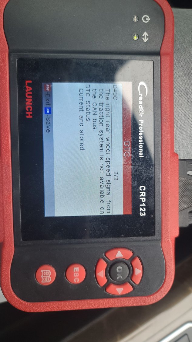

I ran the scanning tool and I got codes d40b and d40c - left and right wheel speed sensors.

and re ran the scanning tool and the same codes have come up. I ran a live scanner and all wheels are running correctly same speed. The car will not run past 60km.

Hi everyone- March 27, 2022 update.
We ran another scan test and one sensor came up.. right rear rpm sensor. We bought another speed sensor and installed. Everything worked! BUT... the lights are still on.. now the final situation is.. how do you get rid of the lights?? (Abs esc module inoperative, run flat indicator inoperative + associated lights on dash)

I reset the codes again today and this time, only 1 rpm sensor code came up- this time, left rear (previously it was both). Both sensors were changed.. and the car runs perfectly fine.. but the lights come back on after hitting 20km/he or so..
Tried driving 110 km total distance to see of it would go away but it didn't.
Thinking of changing that left rear sensor again with a replacement sensor (maybe this one is faulty.. even though it's new)
