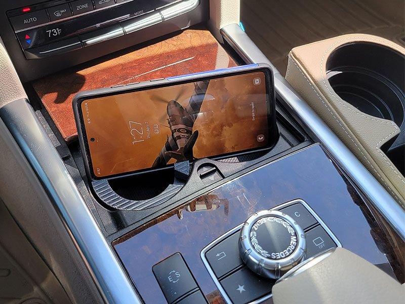

Picked up mine this evening. It fits my Samsung S20 5G FE with its protective case perfectly... either vertically or horizontally. $3.60.
I'm pretty sure the third slot is for phone cabling, if needed. Keeps the cable below the surface of the holder so the console cover can slide shut.

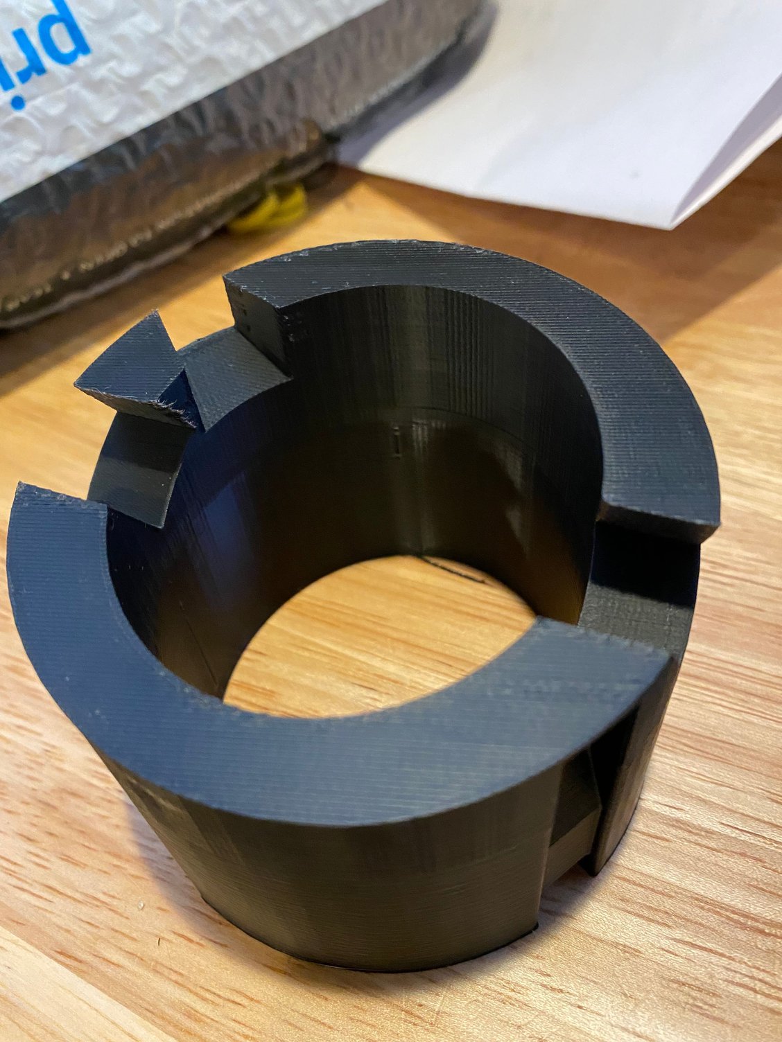

Great job! Which filament did they use? (Please say it is ABS or PETG)
three things to add:
  • They could have used a finer print resolution. See pic below. It doesn't take more filament - it just triples the print time.
  • The third slot lets the light in from the source at the center-rear. See picture above.

I requested ABS filament, so I assume it is. Yes, it could be finer resolution, but I decided to print it with basic settings for testing. If I find myself using it regularly, I may have it printed to a finer resolution.
Today I drove 26 highway miles with my phone in place (vertically). It didn't move at all.

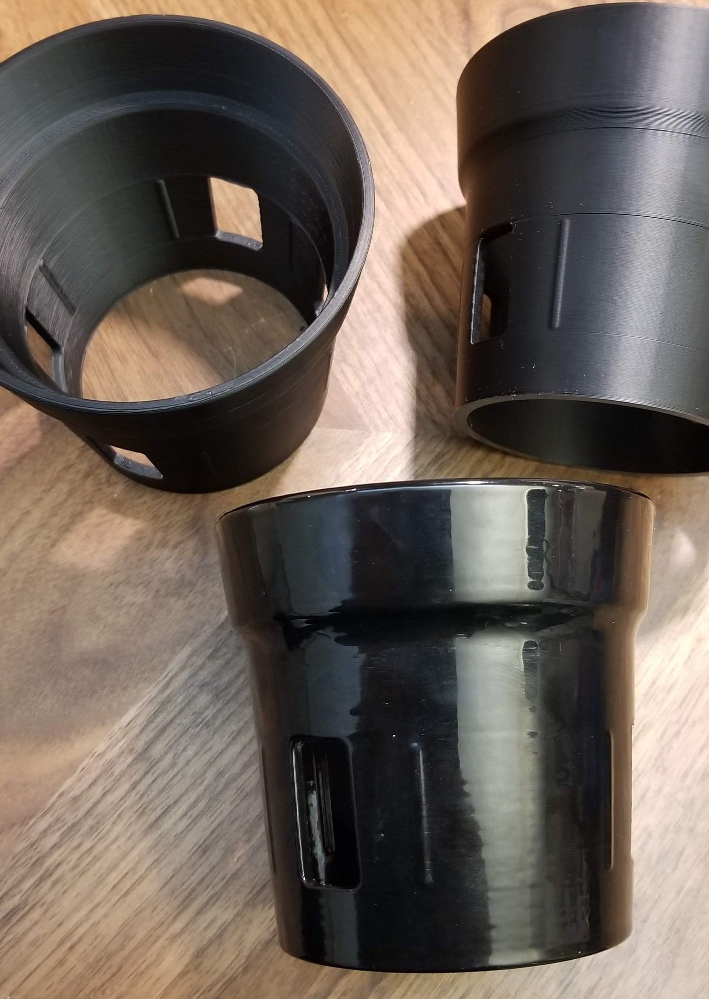

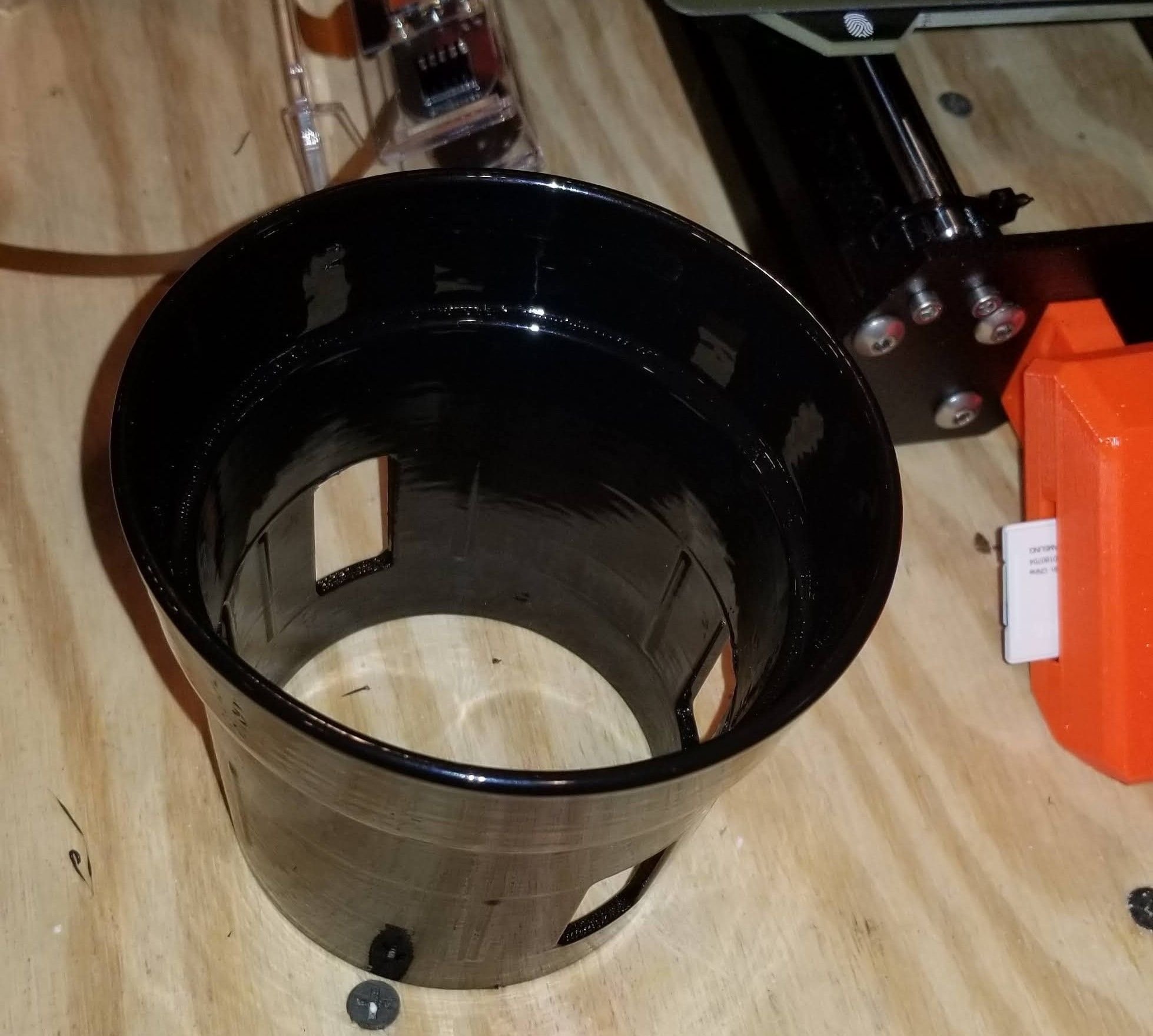

Gotta share this here. From my BMW, Porsche, and now MB experience - German cup holders are awful! It must be our big fat american drinks. They're even called out in Better Call Saul. They have a long way to go if they want to catch up with the 19 cup holders in the Subaru Ascent.
A finer print resolution improves quality at the expense of a longer print time. Some filaments (like ABS) can be smoothed. Here are some cup holder adapters I made for my Porsche Cayenne.
I made a couple of sets for people and this is the first time I used acetone vapor to smooth the ABS. I think they look neat in both forms. The smoothed version looks like an injection molded part.
