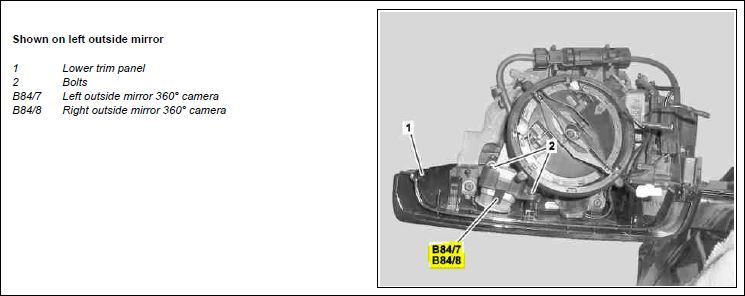

Here's function & wiring diagram for MB pre-facelift stand alone backup camera, as mentioned facelift got 360 cameras in o/s mirrors. Camera (b84/3) is part 2128201897, module (n66/10) 2128270006. Alternative, search afterrmarket. BTW 207, should be posting here: https://mbworld.org/forums/e-class-c...brio-a207-141/
File Type: pdf
File Type: pdf
File Type: pdf
