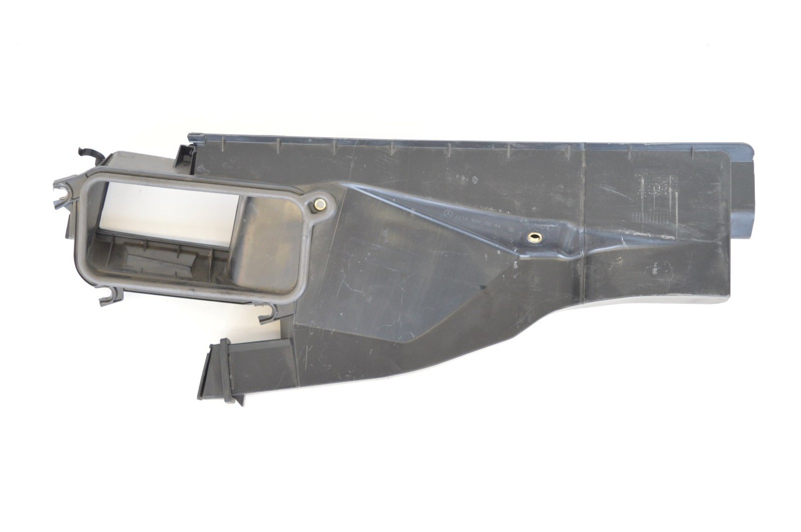

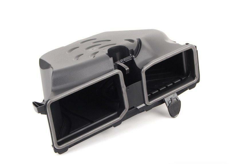

Aha... this is the plastic component responsible for watertight-ness of the removeable air box above battery to firewall....which is for HVAC blower air path. Item 100. This is from a RHD car.
https://www.ebay.co.uk/itm/263726847453
Above device item 100 (RHD car ) is also rain water collector from the big plastic tray/cowling of windshield, where the 2 wiper shaft pops out.
This tray, item 10 : https://www.ebay.com/itm/265579543292
This is the EPC data on all 3 : Item 100, 10 and 50
https://webautocats.com/epc/mercedes...65/d04/83/110/
Item 100 (RHD car ), So it is the same o-ring seal like front SAM fuse box white housing to firewall.
We must also make sure the grey foam seal at the air intake box item 50 is still good.
Mine, at 1 region got small cut, because I have opened this air intake box like 100+ times ha ha ha
https://www.ebay.com/itm/254364519243
