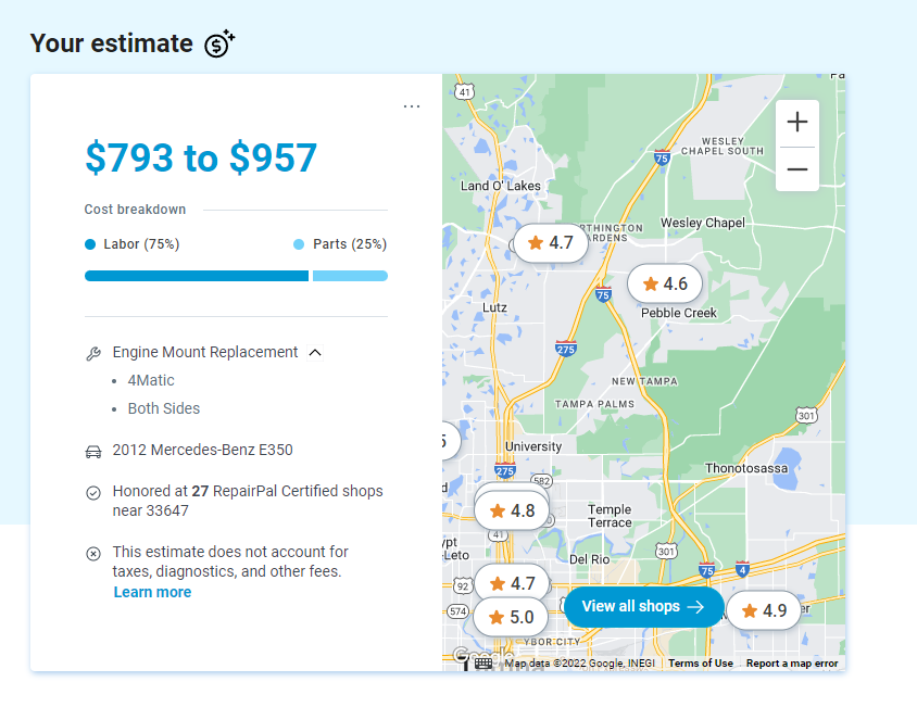

To complement @Left Coast Geek and @chassis suggestions you can get a rough 2nd estimate using RepairPal and ask for suggestions of reputable MB indies in your area
For example, here is Tampa a quick estimate using RepairPal for the mounts:
I bet you can get an Indy that will replace the engine and transmission mounts for less than $1500 in MA. The brake lines may be a different story since that may be work intensive (I did it once, replacing all lines, in a Toyota and it was not fun)

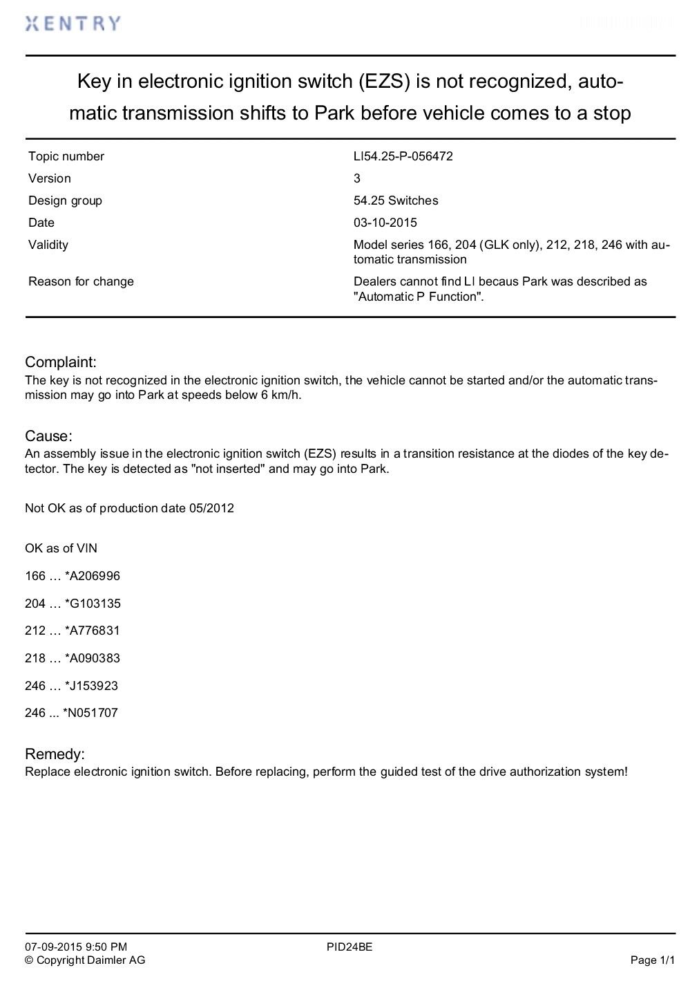

I do not believe an ignition switch would quietly through the tranny in P without anything else being impacted. It could shut off all power all right but not to tranny alone.
Instead of guessing invest in a OBD scanner of your liking. It will give you basic visibility on your car developing faults.
The driver door ajar switch can through your car in "Park" below a certain speed. It's all driven by software signaling through a handfull of different network buses.
Once a while operations can get upset by unchecked voltage. Keep your battery topped off to serve you well.
Can and will I’m afraid. It’s quite jarring to say the least.
https://mbworld.org/forums/e-class-w...ng-stop-2.html

THANK YOU @atraudes for this terrific eye opener!!
OMG this is seriously pushing quality well within VW standards👎
MY'14 EIS module 🤪
The updated EIS one is not much better with vulnerabilities to dust (opto-couplers) and solderless pins all over the place.
The way EIS is built that's a serious hazard waiting to happen. Tead threads: ppl get stuck in "P" across intersection with broad side exposed to incoming traffic, kids in rear seat
I am still surprised the MB logic is able to lock the tranny while the car is moving due to EIS acting up - The steering column is also a prime candidate for shifter bugs
From what I have seen the substandard quality is only used for peripheral modules, not for VIPs that can cause crashes. That why I am surprised the software is on par with the hardware wickness.
++++ Edit++++
Failure analysis:
Let me re-read the thread (TSB) to try better understand how this piece of **** fails.
HERE is the full description:
This happens during long ROAD TRIPS then becomes ok again after a RESTART! Short trips are no problems ✅
...Small world !!
-- That sounds exactly like what triggers the battery drain yo-yo below 12VDC
-- Add to that the MISFIRES on long trips
many chassis are impacted
The revised TSB (version 3) above instructs to replace EIS/EZS because of "transition resistance"... solderless pins??
The condition that causes the EIS to crash are still present but the revised EIS is more fault tolerant to disruptions.
Under the radar: No known faults are loged.
That is a step in the right direction: now EIS can poop quietly without banging the tranny. CAN still gets disrupted but the resilience is increased by one fold.
The fact designers left the loose pins alone on this VIP module may be a sign they found a different primary cause.
Why leave wicknesses in this module? Is a working main switch secondary because F-SAM is doing the switching?
