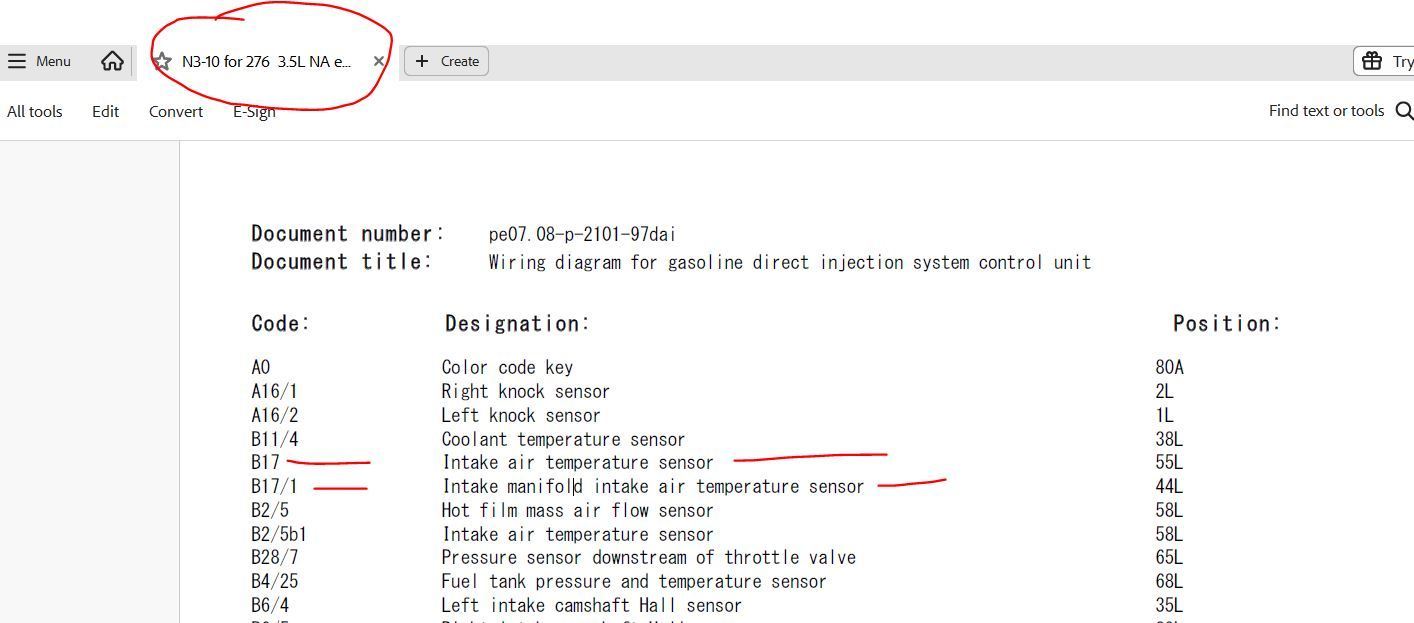

I was looking at the data stream on my icarsoft MBII scanner today, and it seems that the intake air temperature sensor is reading correctly considering what you said above and so is the ambient air temperature sensor. For the intake air temperature sensor, I still don't know whether the computer is looking at the one on the intake plenum or the one after the air filter, so I'll probably try unplugging one and then maybe swapping them. I don't know if there are any adaptations that I can do to bring my fuel trims down. They're around plus 30 on bank 1 and about 22 on bank 2. So either too much unmetered air going in or not enough fuel coming out of the injectors or an issue with some sensor even though I don't have any other codes. But under load, I don't have any issues. So I figured, if the injectors weren't putting out enough fuel, the problem would be more evident at higher loads, which it's not. Even in open loop, any problems with injectors should show itself, I would think. I have a 144,000 miles, and other than the code, the engine runs well. I even changed the oil separator and pcv valve trying to see if that was the cause for the lean condition.
Ignore the tensioner lol
Ignore the tensioner lol. IAT is #10 on top left (pic is mirrored in the parts diagram), and #165 on bottom right.

Looking at wiring diagram, you got two IAT sensors
If you want to ID them, disconnect 1 of them and run a scan, DTC will show open circuit or short circuit on that sensor.
