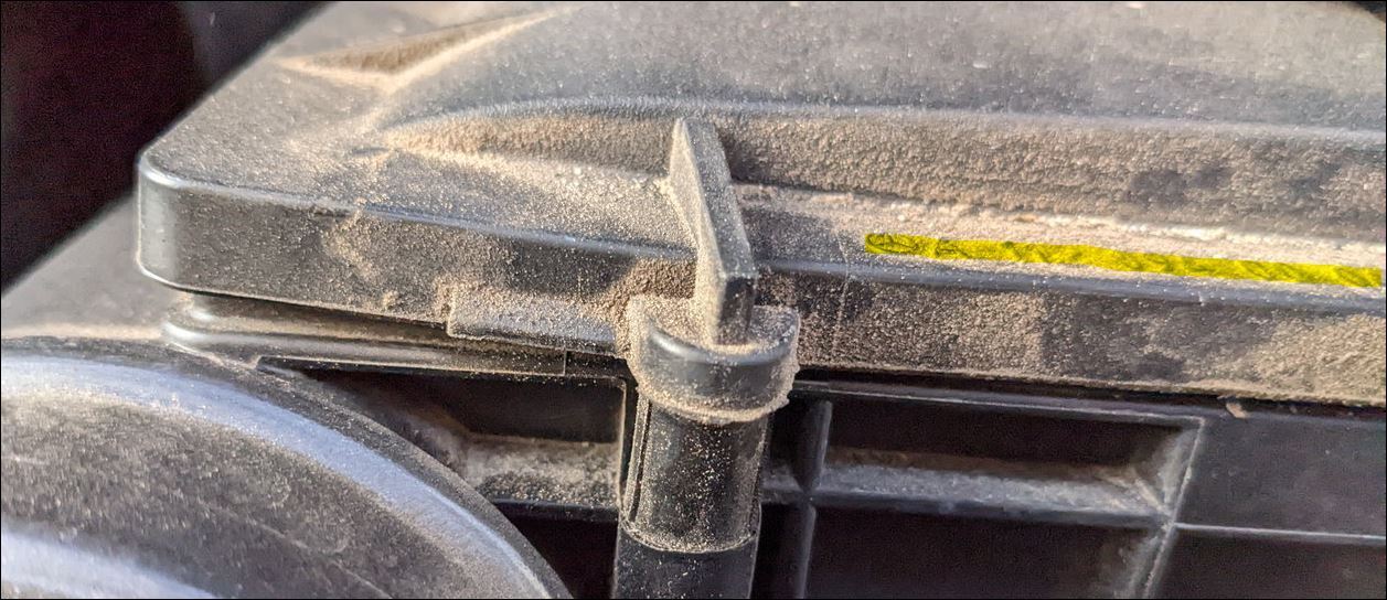

Is my airbox on correctly? It seems like the corners of the box are unable to sit flush. Is this the design or is something off?
Edit**** this is 2010 E550 5.5v8 sedan

Dunno. Pull it apart and check it. Doesn't look right to me though.
Old Sep 25, 2022 | 06:51 AM
RA72825's Avatar
Joined: Oct 2005
Posts: 4,957
Likes: 1,640
Looks like the plastic has deformed and warped. I’ve not seen that before, but it’s probably not worth replacing. Could use a little clean up in there. 😁

Typical Arizona under hood shot! So darn dusty down there, my car in Tucson looks like that after six months also. plastic warps in the heat, what year and model is that? doesn't look like either of mine and reminds me of my 210 E 320? Either way, if you can set that out in the sun for a while, upside down, it may warp back flat. I would also check my cabin filter, I bet it's a solid wall of sand! you may need to replace that cover to stop the infiltration of dust into the filter and cabin. AutohausAZ is right there, south of Sky Harbor. If youre not interested in buying a new lid, you could I guess use door weatherstripping dense foam to stop the dust infiltration.

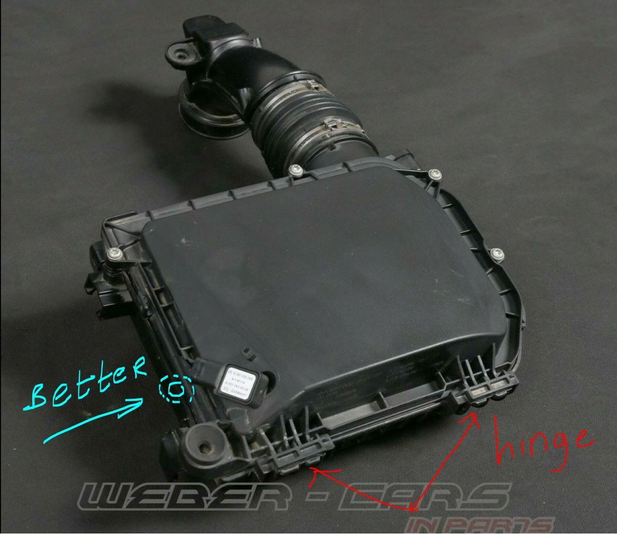

M276 Turbo 3.0, if one is not careful pushing down properly into its channel for the seal of the engine's airfilter, sometime on the side of the similar airfilter cover as OP's photo, it will have a bit extra gap than usual.
This is what I am speaking about. https://www.ebay.com/itm/264946156219
See the Torx screws are not equally spaced and in equal quantity per side, some side uses hook/hinge.
Would be better if where I marked green, another torx screw is placed there

When this is just a cover and not crucial, even it might allow small amount of bay (hot) air to enter the filter, I would more worry why it warped this way.
MB air filters do have precision-molded lips, who have to go into groves.
I would check to make sure the filter is sitting properly and is not pushing the cover the way it not suppose to.

Sorry for my delayed reply. This is a 2010 E550 5.5 V8 engine. It has 2 filters.
I will try to take it apart again and reseat the filters. Based on the comments it sounds like this is not the way it was designed.

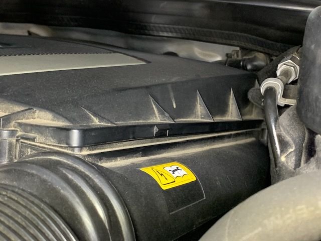

Should be the M273. It has the same air filter setup as the M272. I can check mine when I get home and take a picture.

Well, mine is the same way. It does look like it shouldn't be that way, but it's fairly reinforced so it seems to be by design

Thanks so much for sharing the pic of yours! It looks the way mine does. This gives me some piece of mind.

I have the m272. Mine is the same exact way at corners. I thought it was an issue too when I first got the car years ago. But I looked into it and it’s by design. Nothing to worry about.
