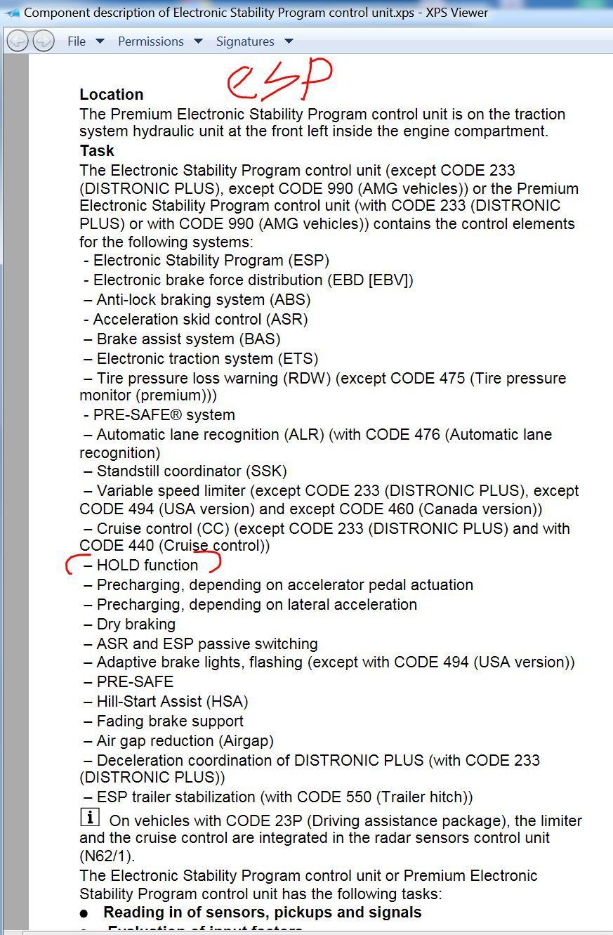

Although OP realized noise is not associated with HOLD thought it best to mention the ESP CU controls the HOLD function.
File Type: pdf
