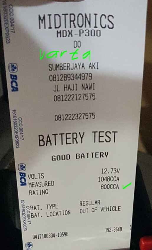

2015 to today = super awesome battery life
If there is no parasitic load sucking down your battery of 2 weeks non use, 11.xx volts usually means 1 dying cell and at that 6 years of age it is so acceptable.
When you get a new battery, train your ear on how the cranking sound and speed of engine start is from a super healthy battery.
Often we can hear when the CCA is rather weak but battery still is very useable as in decent reserve minutes.
I am speaking of 30C all year round average temperature, I don't have winter freezing temperature in my tropical country to weaken cranking power.
Your/our 3.0TT engine if based on a Fluke 337 peak inrush current capable clamp meter will take approx 570 amps at cranking at 30C ambient temp and
engine been shut down for more than 24 hours but less than 7 days. This will be approx 210-220 RPM starter spinning speed.
If I am out of town for a month and car unused that long, meaning the oil film on components are less, first cranking RPM can be as low as 190 RPM.
If I do not use my car more than 2 weeks, I do not start my engine the normal way, I use Xentry relative compression test capability to produce crank no start of 10 seconds.
I do this compression test at least twice to spread oil around the engine first using +-200 RPM instead of the typical cold start 1,000 RPM the ECM will do as fast idle.
Less oil starvation occurrence at high RPM is what I want to achieve.
NOTE : My staff will charge my battery every week when I am away because I have accessories which need a little more power than the typical <20milliamps of the W212 deep sleep typical drain. The super slow & polite 5 amps Ctrek is what I use. So battery is always peaked charged.
I also have disconnected the LIN connector to alternator, meaning my charging system is not the "smart-but-dumb" one MB uses. My Valeo alternator's own charging controller is doing the
proper smooth and yoyo free charging and I can get 95%-100% charge level compared to 80% typical MB smart-but-DUMB charging algo is designed to do.
The appointed battery MB supplied for my market and model is equal to this Varta https://www.varta-automotive.com/en-...gm/580-901-080
800 CCA DIN version rated but when brand new a Midtronic battery tester MDX-P300 will show 1,048 CCA SAE J537 version . Values at 30 Celsius.
Above is my new battery in July 2021. I retired the same Varta battery of 3 years old, still very good CCA above my engine requirement but reserve minutes has gone down a little.
So the 3 years old battery I allocated for my emergency small diesel generator/s jump start unit and for multi purpose use.
I think 4 seasons country with plenty of heater options get the 95 amps one with 850 CCA DIN version https://www.varta-automotive.com/en-...gm/595-901-085

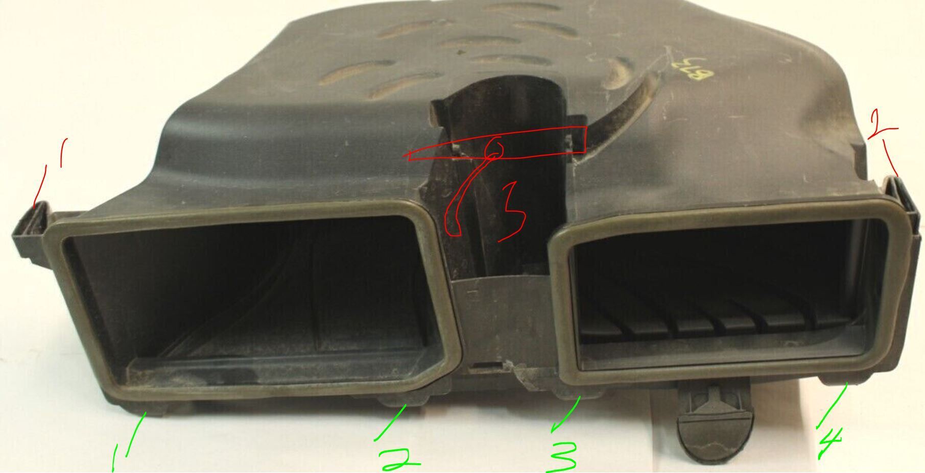

Interesting how some HVAC ductwork snaps in over battery without much for sealing I feel as it is only thin rubber about 1/16" and easy to install in not located properly.
That thing is a rain water separator for HVAC blower, and is one bad design I hate on MB.
I have removed it in excess of 50 times.
I seen a few MB cars with one of the top side metal C clip broken, usually the no 1 in red if for a RHD car.
The metal clip uses plastic rivet as hinge/anchor point so not really strong. Red 1 and 2 are clips or its receiver, 1 to 4 green are notches or notch receiver.
I suggest you use a white or yellow electrical tape as alignment marker at one side of the top clip. I marked mine at red no 1 equivalent of a RHD car, it helps a lot.
There are 4 small notches at the bottom of this unit. Often people re-install this thing without getting those 4 notches locked into its place/receiver and what will happen
is the top steel clip then carry all the weight of this thing and eventually broke. Also without those 4 bottom notches seating pretty in its place, the super thin foam gasket will
not seal well and sometime get a tiny tear from movement.
Try to play around with this box a few times install and remove, and you will understand potential re-installation mistake one can make.
