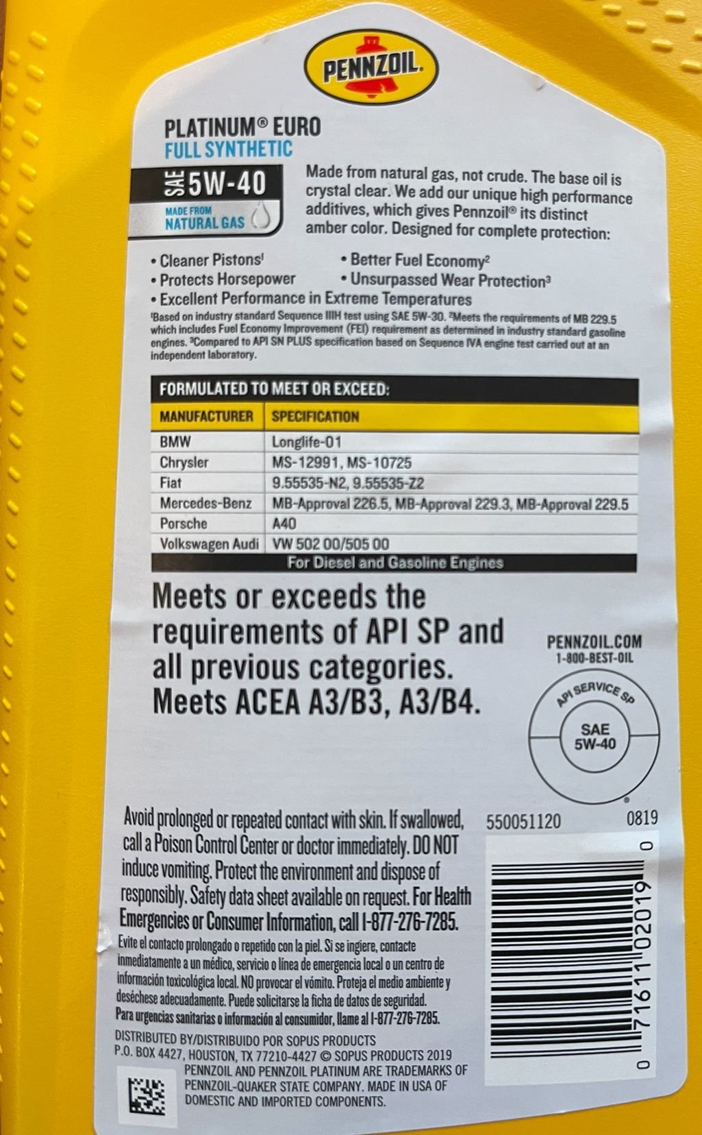

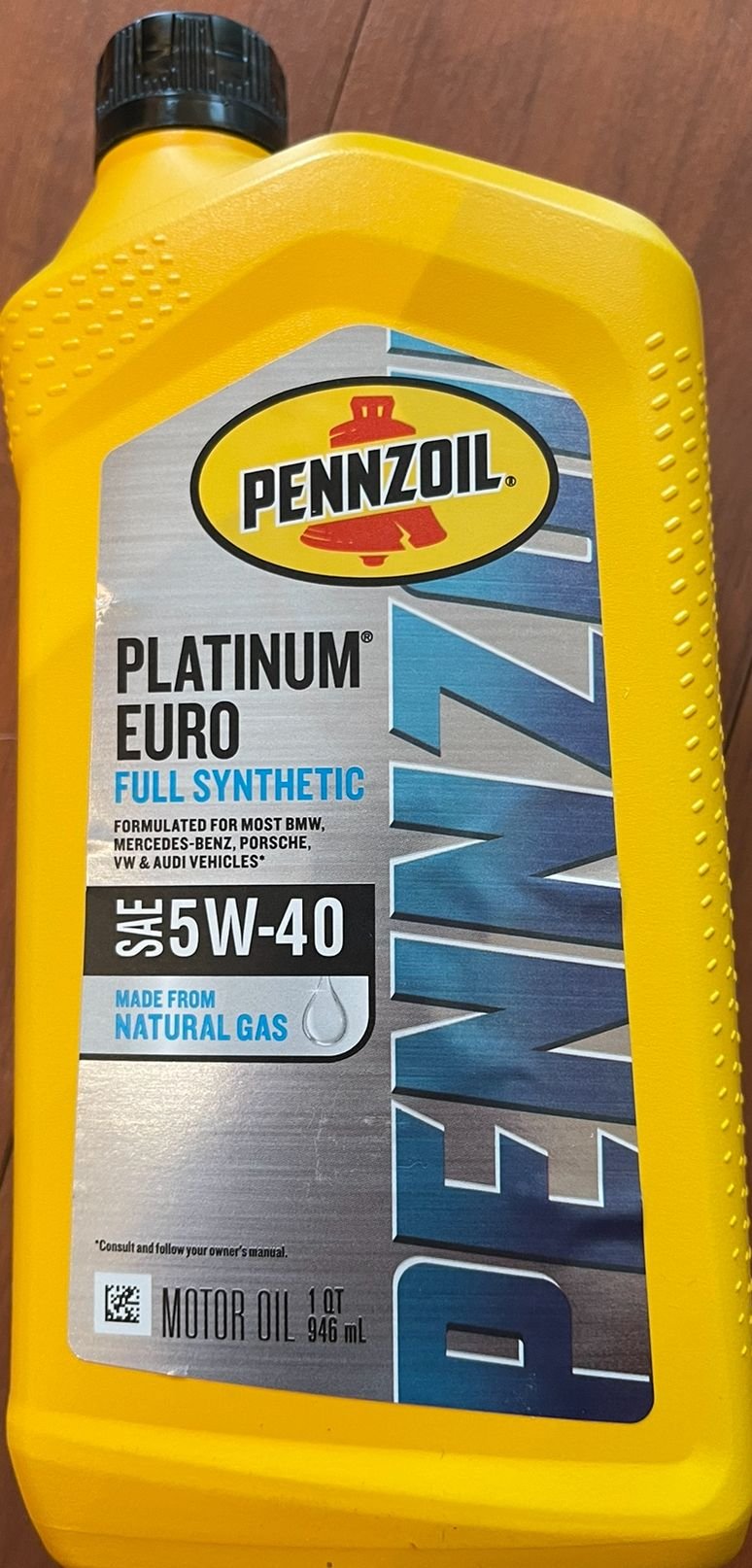

I believe this, Pennzoil Platinum Euro is the only MB 229.5 approved 5w40 API-SP oil.
Are there any other..?
Has anyone used this on M157 ?

which of the two will you choose?

Motul 8100 Power 5w40 is SP however not “mb-approved 229.5”
Not having mb approval is my only concern in terms of it. Would appreciate if someone could chime in on thev approval matters

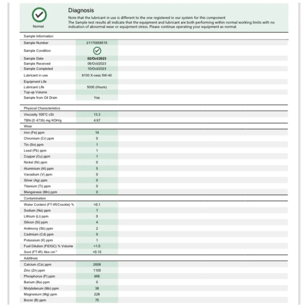

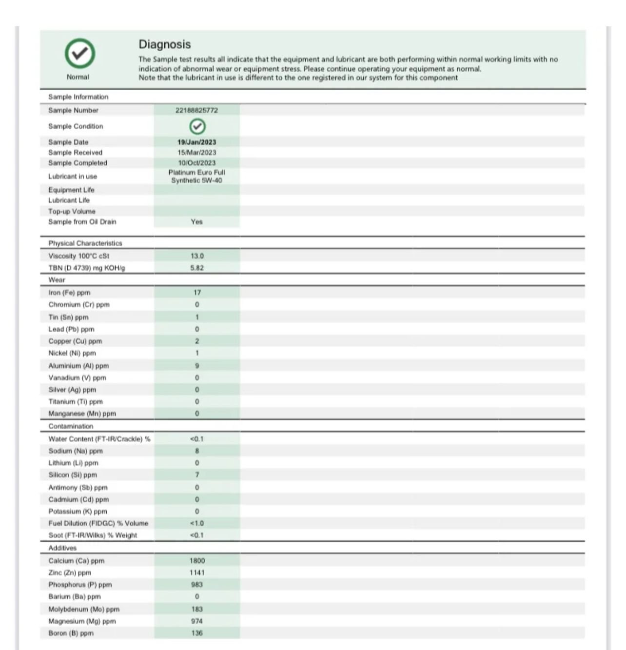

I ran that oil 5/40 xcess gen 2 for four years. I even mistakenly thought it switched to a SP rating in 2024… Loved it. SP is better and higher weight has been better. FWIW. The weight change is anecdotal, though substantiated and the chemistry change is because the manufacturers realized an error in their ways….they were unknowingly recommending to destroy engines in the name of mpg with poor chemistry for gdi engines.
very interesting. It’s confirmed to be SN not sure where people are sourcing SP rated ones but the one I’ve used was SN and I hear no rattle what so ever.
so Balti, what do you recommend and do you currently use?
I ultimately do plan on going over to 5w50. However not as of now.
Simply wishing to hop over to SP. The reason for the Pennzoi Platinum Euro I’ve just received. Only SP rated 5w40 with mb 229.5 approval.

I am not sure how the MB Approval process goes but I think most of it is along the lines of: Does it save gas? Yes. Approved. Is it thin? Yes. Approved..
Forum member JettaRed ran non approved Pennzoil 5W-50 in a M276 with positive results.
Don't get me wrong, I am not saying to ignore the approval but there needs to be more research, I mean, there is no 229.5 approved 5W-50 oil from MB right?
