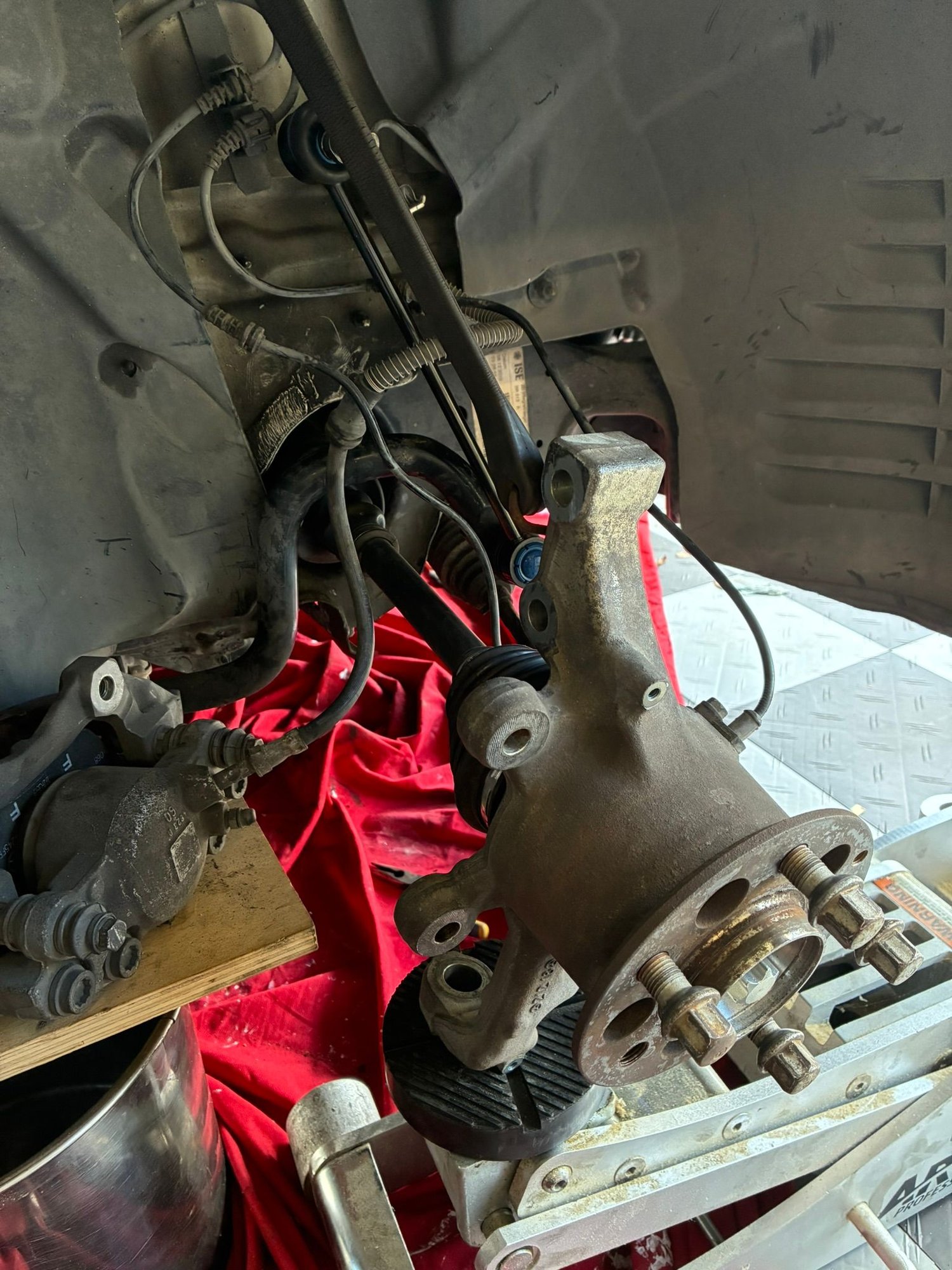

Hey guys, so I was replacing my struts and control arms, but stupidly manage to let the CV axle pop out of it's socket. Been trying to get it back in for 2 days. Watch a bunch of youtube videos that made it look easy to pop back in, but no so much for me. I'm considering just removing the cv axle completely and see if it i can it back in place outside of the car. Any ideas? this job is turning into a nightmare.

the tranny side is still connected and inserted, it's just the tripod joint that is out. I've been spinning the disk and can feel it's in the right position, but i can't seem to push it all the way in. The boot is still crunch up so I don't think it's all the way in.

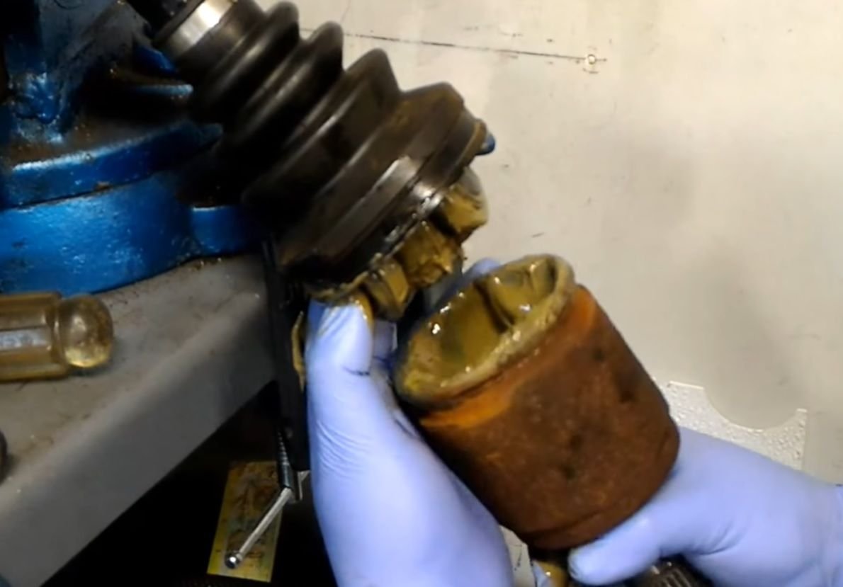

This is exactly what i want to avoid if at all possible. Found a youtube of what it looks like inside.

Don't be too scared to remove the boot, it's really just some rubber and a clamping holding it in place. There are a few things to consider:
- Mark the positions of the shafts on both sides of the boot, so you can install it in the same position. The tripod will wear a bit over time, you want to reinstall the tripod in the same position, not 120° out.
- Make sure you have another clamp/clamps to reattach the boot.
- Don't spill any of the grease. If you do, no big deal, just clean all parts and replace the grease with the correct type and amount.
Check MB document ar33.30-p-0690cw for all details as they should apply to your car.

The tripod joint (the CV joint) is not a "fixed" joint that pops into place. The tripod male/female ends just slide in and out of each other. They don't "click in" together like the transmission side. So perhaps, you're just fine and just need to finish assembling?

It doesn't feel like it's all the way in. The boot is still crunch up and I can't align the hub to the strut. That's why I think it haven't slid all the way in.
