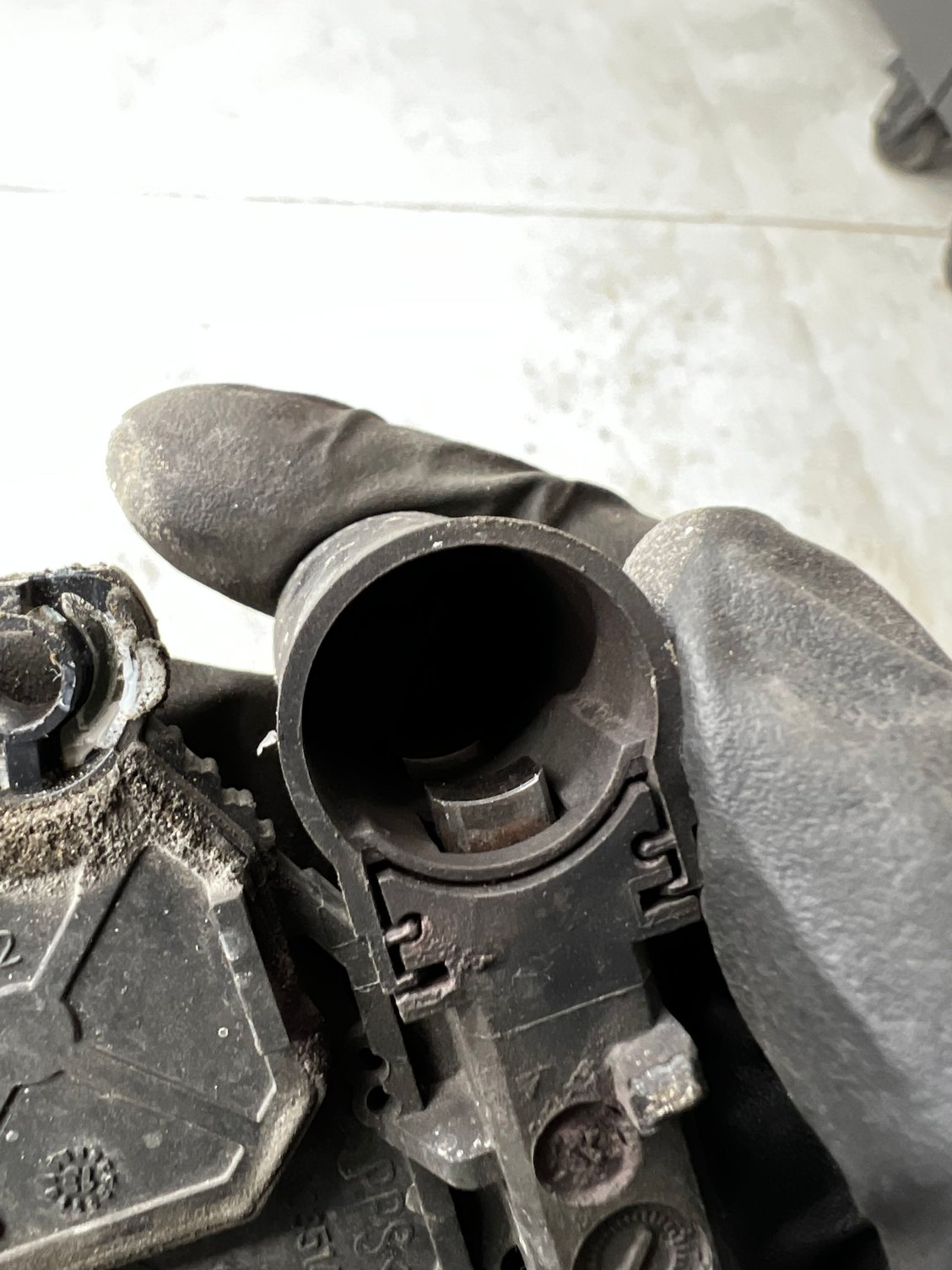

Today I removed the alternator and did an exploratory disassembly of the back. Removing the voltage regulator, I discovered significant scoring on the alternator shaft and equally inverse wear on the inner lobe on the voltage regulator. Photos below.

It appears this was, in fact, the problem. I have replaced the alternator with another of similar stature and found that the problem is decreased but not eliminated. Basically, the part number on the alternator I got and the part number on the alternator I ordered were not the same, and as a result, I had to swap the old voltage regulator to the new alternator. This reduced the problem significantly as the new alternator does not have grooves deeper than the Grand Canyon in the stator shaft.

Originally Posted by ArchAngel2190
It reads ~12.6V as it should. The alternator is charging, just not regulating the current properly.
This rotor looks wasted for some reasons. OEM carbon brushes are softer than the also soft copper. This is a carefully matched pair, like the brake pads/discs.
FYI: The current is *not* regulated, only the voltage is regulated.
(However current is measured internally by a shunt resistor so the ALT can protect against hazardous short-circuit conditions).

Yeah the stator shaft looks wasted because it’s original to the car with 206k miles on it. The new alternator is an OEM Valeo with 37k on it, and the brushes are fully one inch longer and the grooving is minimal if noticeable at all on the stator shaft.
I’m surprised it’s held on this long, honestly.

All that amazing chaos underwrapped without any direct code!! 👏
What's missing are troubleshooting steps to pin point what is going wrong.
> Read the voltage display on maintenance menu to see what happens to Batt. VOLTAGE and CURRENT when the ECU is controlling the ALT after initiating the 12.6V float cycle.
> Scan you car to retrieve ALL listed faults.
> Disconnect ALT control lead to instantly get a reliable power source. See if stable car voltage relieves NTG issue.
Cali, you are the kind of gigachad MBWorld power user I have been hoping would find my threads. Lol. I’ll be following through on the rest of this list as well as the most recent post above me, but I have checked the voltage with the maintenance menu and I can see that the current and voltage are both positive and charging, respectively. There is a pretty heft dive in current when I yoink the wheel super hard but I assume that’s to be expected…?
I did do some code reading back when I was getting the Rockefeller Christmas Tree on my dash, but I don’t have a Mercedes code reader, I just have regular old code readers, so the code I was getting was a “data bus, vehicle dynamics control module - no communication” code (U0122) code but I was pretty sure that the problem lay beyond that and I just couldn’t see it because I didn’t have the spicy code reader. That code also triggered a CEL which I’m no longer seeing when this occurs. Is that still worth chasing?
My gut is screaming loose ground, but there are so many I don’t know where to start. I also don’t know where to start with half of the things you identified - soft crashed front SAM? Hyundai sensor? I don’t know how to identify these problems... Is there a thread that outlines those steps?
Thanks for all the info - I’ll be putting it to
