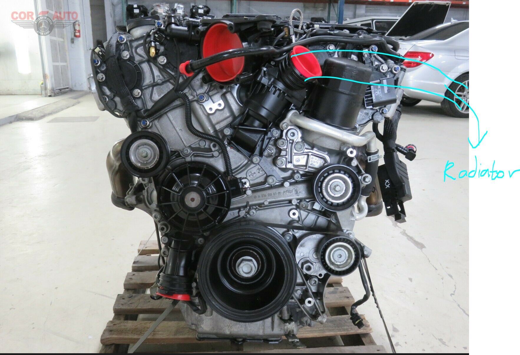

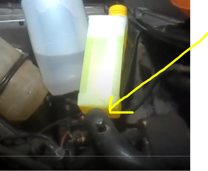

You can get this, when you do.... there is a flat seal you need to remove from the MB specific cap. I got this one. I never use the vacuum feature though, I use my electric vacuum pump.
https://id.aliexpress.com/item/40011...yAdapt=glo2idn
When you said your replacement water pump and thermostat is OEM, what brand is that ? Show me the link.
W212 thermostat mechanically opens at 95Celsius, but can be sooner when assisted by the heater.
BMW uses 103C version. I hope your OEM is a 95C unit.

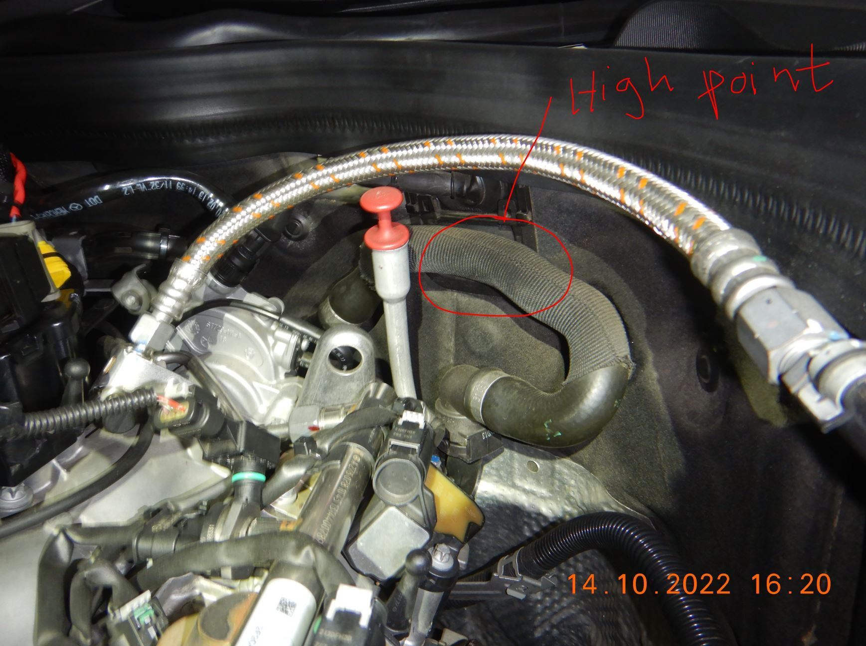

Most people do not realize that ( based on M276 ) the ENGINE's REAR COOLANT OUTLET to HEATER CORE INPUT is the highest point of coolant route in the car, hence vacuuming will help.
Pressure can help too, I use pressure more often than using vacuum.
Heater core return is also very high position, next to EVAP's TXV.
Height information, M276 3.5 NA
Below is M276 3.0 Turbo, but it is the same as M276 3.5NA. This is the coolant hose from engine block rear to heater core via firewall interface hose.
If heater core is not flowing hot coolant and engine overheats, that also means the coolant pump is cavitating from too much air bubbles in cooling system.
When i use pressure instead of vacuum, I apply pressure for 30 minutes to compress air void and hence coolant can fill those air void. It is a slow process.
Usually need a few times of pressurization as the coolant level in the reservoir bottle will slowly goes down...............meaning the coolant has gone to fill those air voids.
Radiator while it looks high position for its input hose from engine block, its output hose is very low position. So air trapped in radiator is actually not so much, even when thermostat is closed shut.
The coolant reservoir is Tee-ded to radiator output & coolant pump suction hose.
