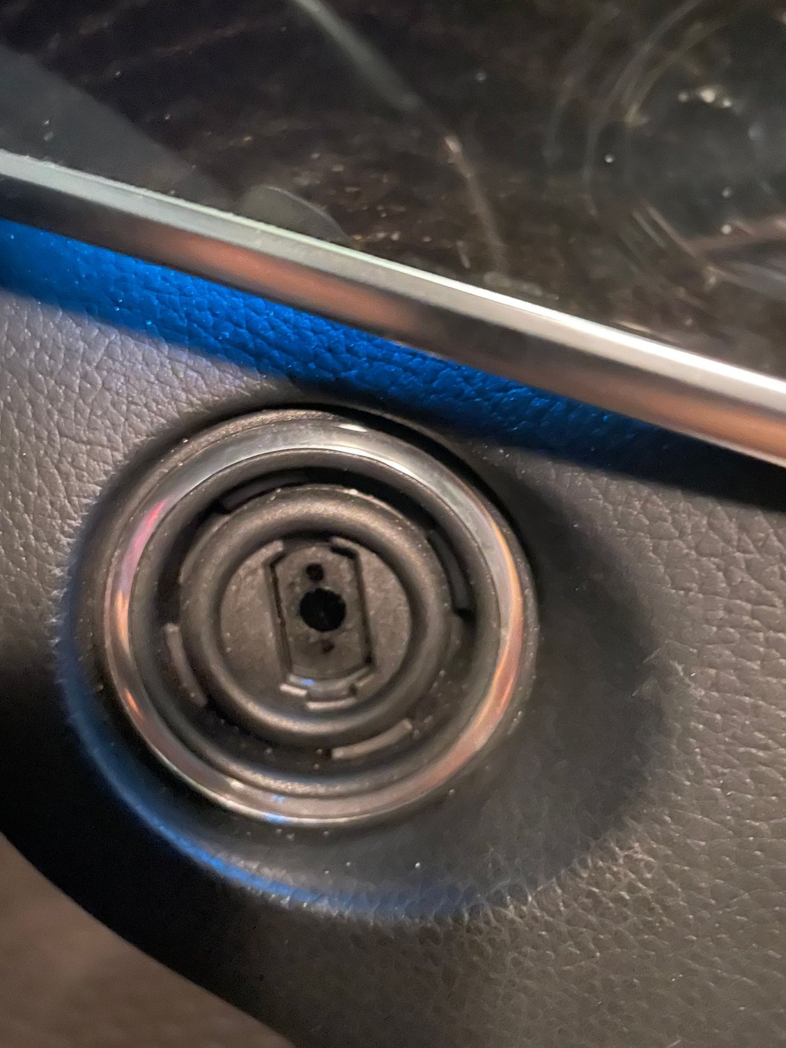

To test this, I have removed the KG button from my ignition. With the keyfob in my lap (reading present by the ignition), I have used a plastic whistle mouthpiece to imitate the button action, namely, press in the whistle and then remove it, as you would release the KG button. I've tried to observe the action and cadence used with the KG button in place, using the whistle, instead. But try as I might, the engine will not start. Which makes me question if a replacement button will work, either.
Short of casting a duplicate KG button plug to match the actual size and shape of the legitimate plug-end of the OEM button, one can simply buy the replacement button off eBay, Amazon, etc. But will it actually work?

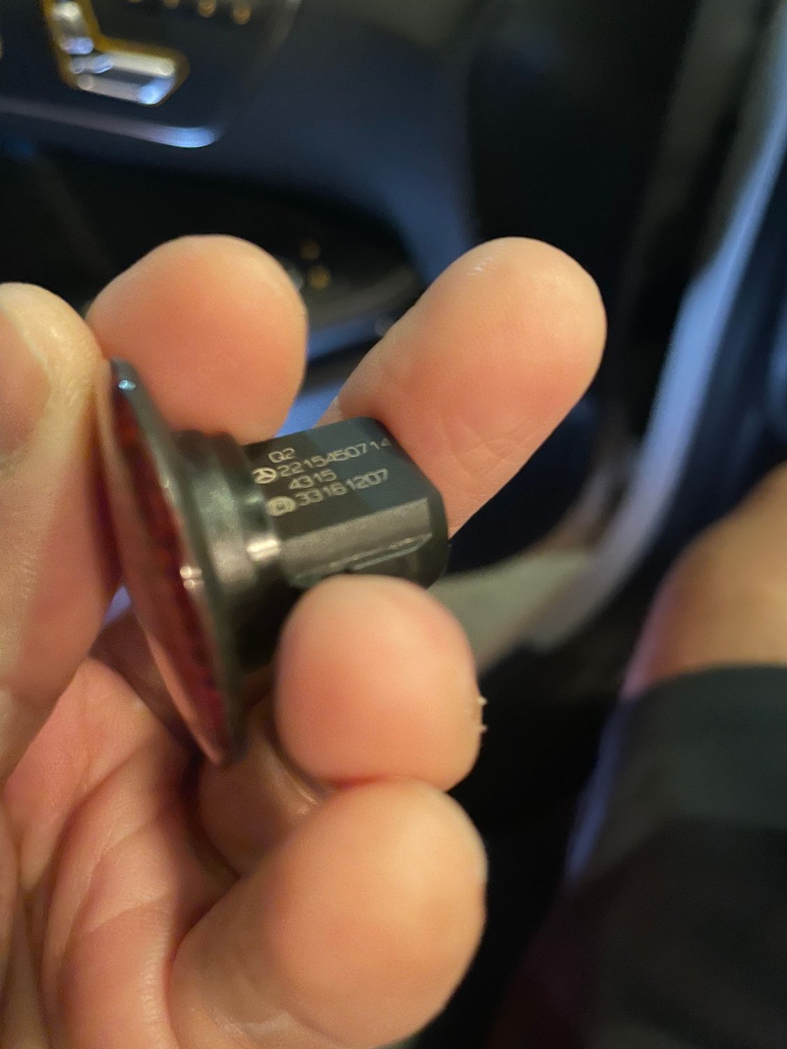

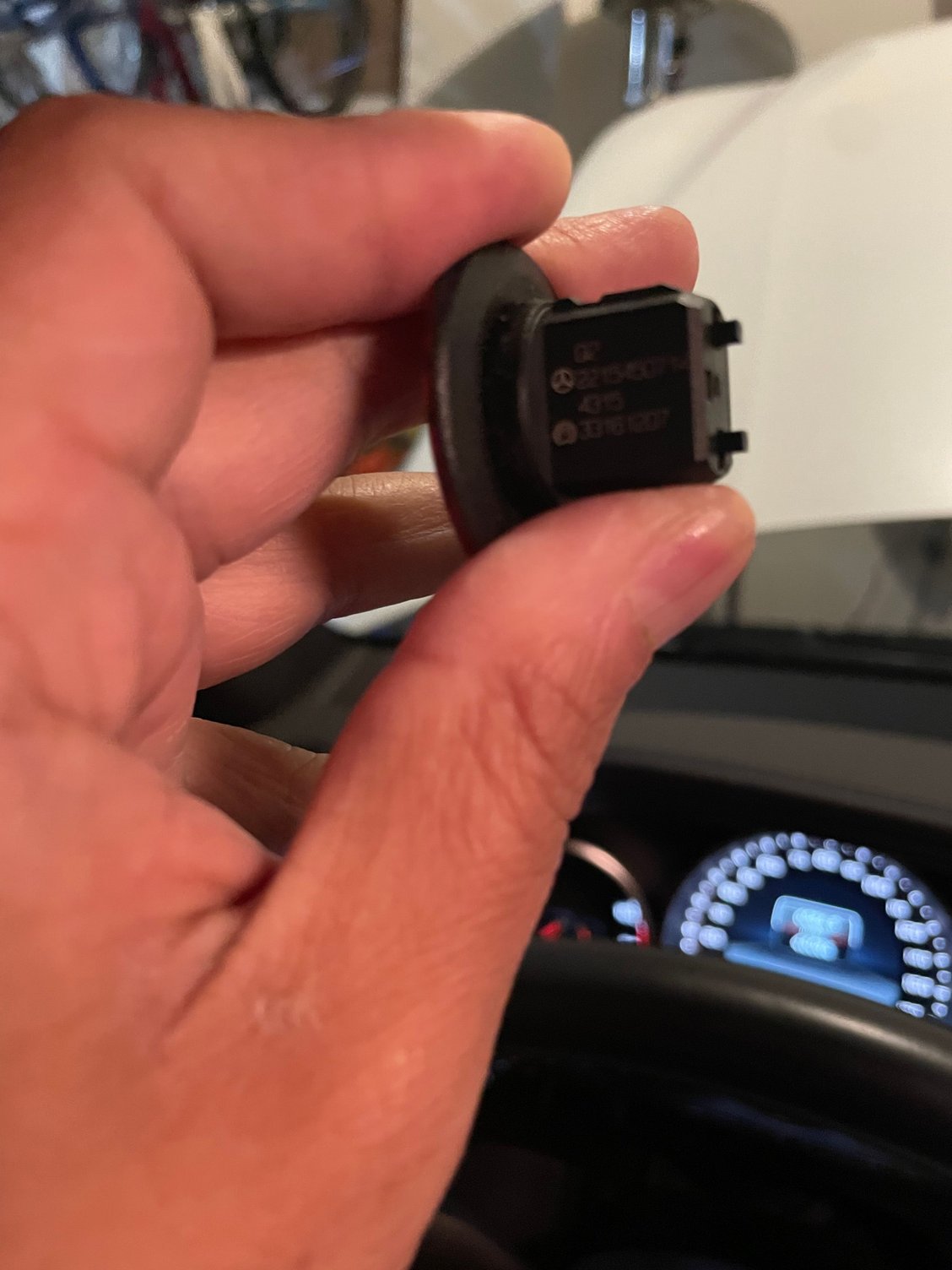

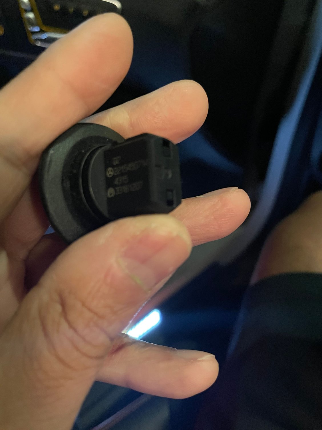

Look:
Purchased online not from benz
Side view - button not pushed
Button pushed
See the two prongs
See the two holes
Old May 7, 2023 | 05:38 PM
PeterUbers's Avatar
Joined: Jun 2004
Posts: 13,799
Likes: 3,228
Starting the car is two things:
- button inserted pushes the plunger back about 1/2"
- button pushed while inserted promotes the two prongs that actual depress the two small buttons inside plunger to actually start vehicle after it (the vehicle, not the button) interfaced with keyfob in your pocket
- the button is nothing more than plastic and a spring - no electronics

So, there are tabs protruding from the long side of the center post that depress small buttons inside the EIS shaft? This makes sense if the process is strictly physical, and the several previous posts confirm that it is physical, only. Thanks.
I can't reproduce this effect with a whistle, LOL.

yep you can reproduce this with two toothpicks - push them both into those two small buttons in the EIS slot while also depressing the plunger in the slot - so long as your keyfob is in the car and you do each toothpick simultaneously- car will start
pop out your button see for yourself - I presumed you did this already (visualized the small prongs that emerge from start button when button is depressed)

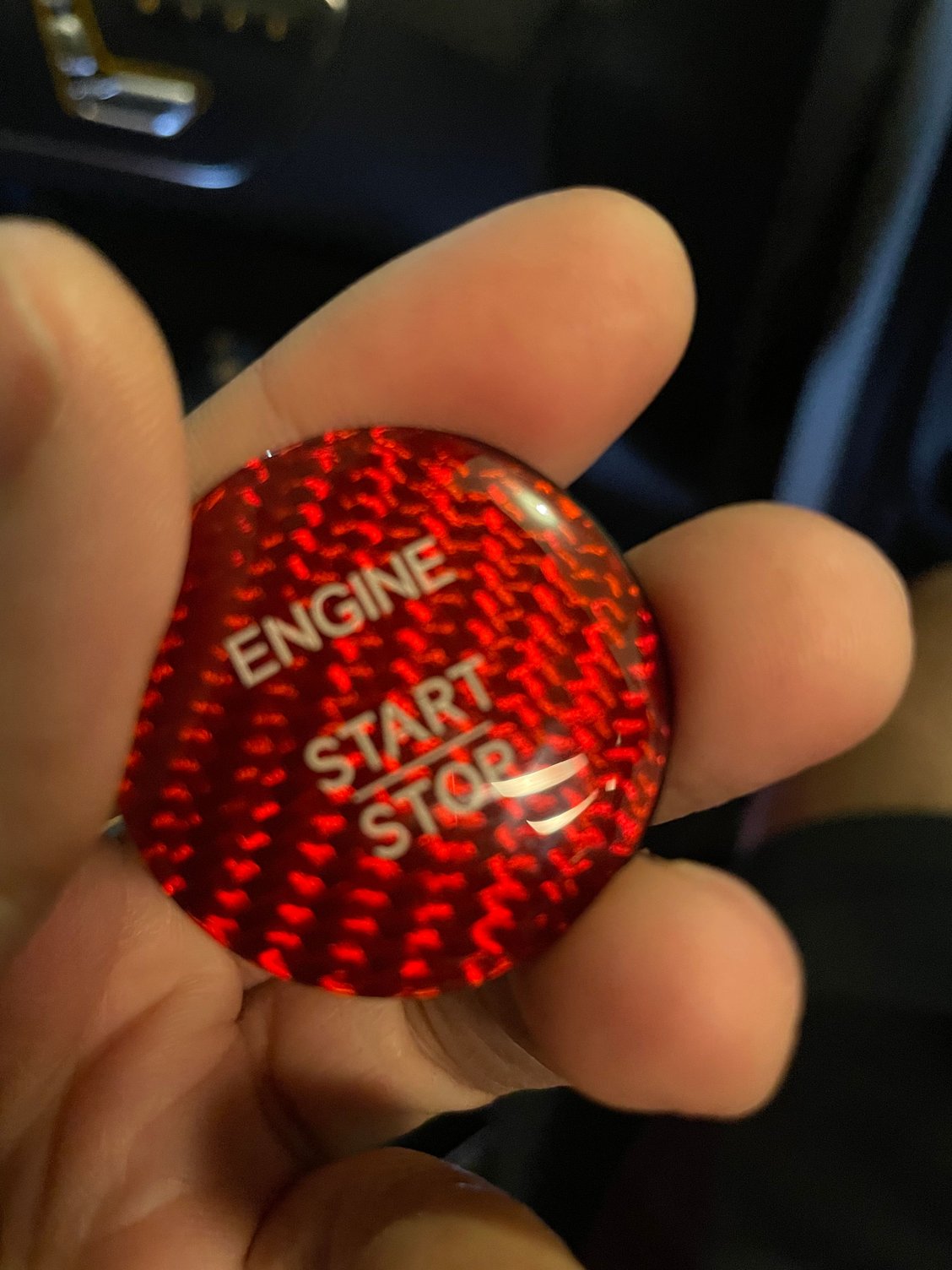

Thanks for bringing this up because I would like to have an idea of having a carbon trim ignition button as well . It should work without any problem
Old May 8, 2023 | 03:16 AM
cetialpha5's Avatar
Joined: Feb 2014
Posts: 6,190
Likes: 1,550
From: MA
2008 E350 4Matic, 2011 E350 4matic
Carbon Fiber Car Engine Start Stop Switch Cover Sticker Trim For Mercedes-Benz
https://www.ebay.com/itm/284896048531
They have it in red too.
https://www.ebay.com/itm/255608912673

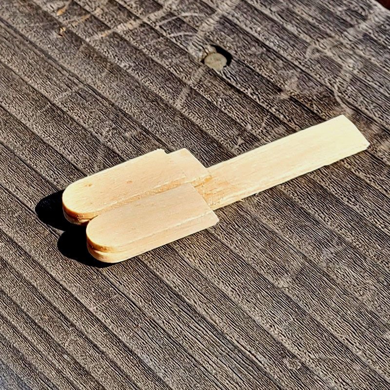

Proof positive that this retired product manager has nothing else to do...
I took a couple popsickle sticks, cut them into parts, and glued them together, matching the dimensions of the OEM starter button. With some fiddling in the ignition to get the cadence right, and the keyfob in my lap, it starts the engine successfully.
Eureka!
Oddly, using this gadget will not turn off the engine. I had to reinsert the KG button to do this.
full functionality has to do with those two little prongs ...
