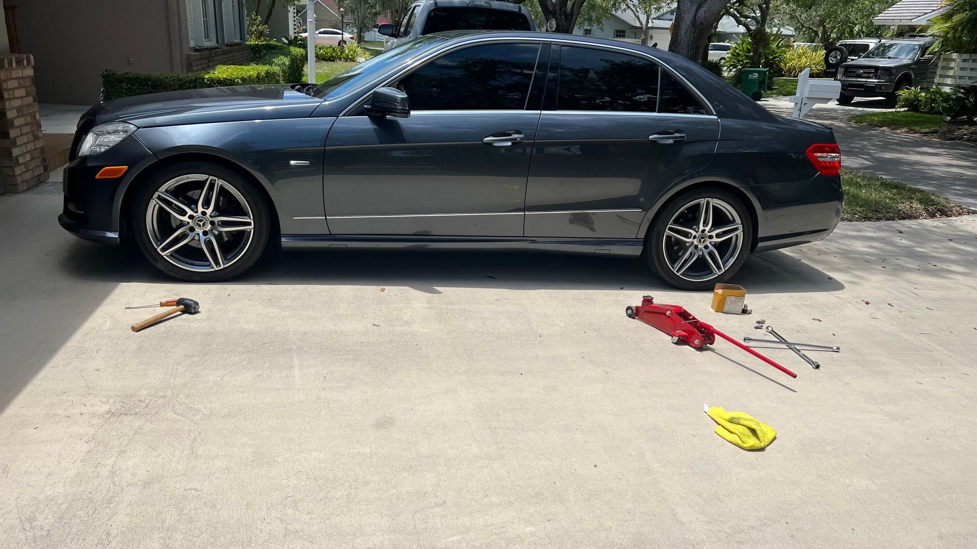

So I did thee install in my garage and went for a drive and immediately heard rubbing. The front tires did rub on the strut housing a bit. Didn't notice it until after. I would probably need spacers or a lower profile tire. Decisions, decisions. Will see!!!

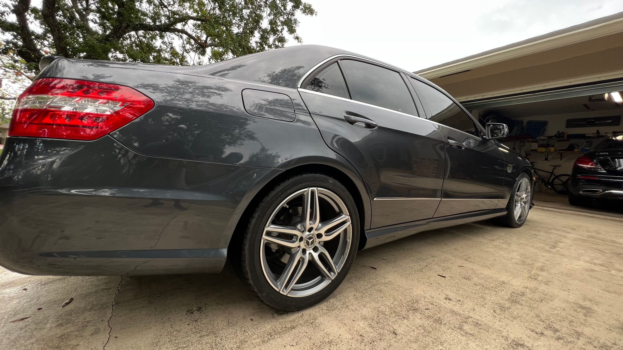

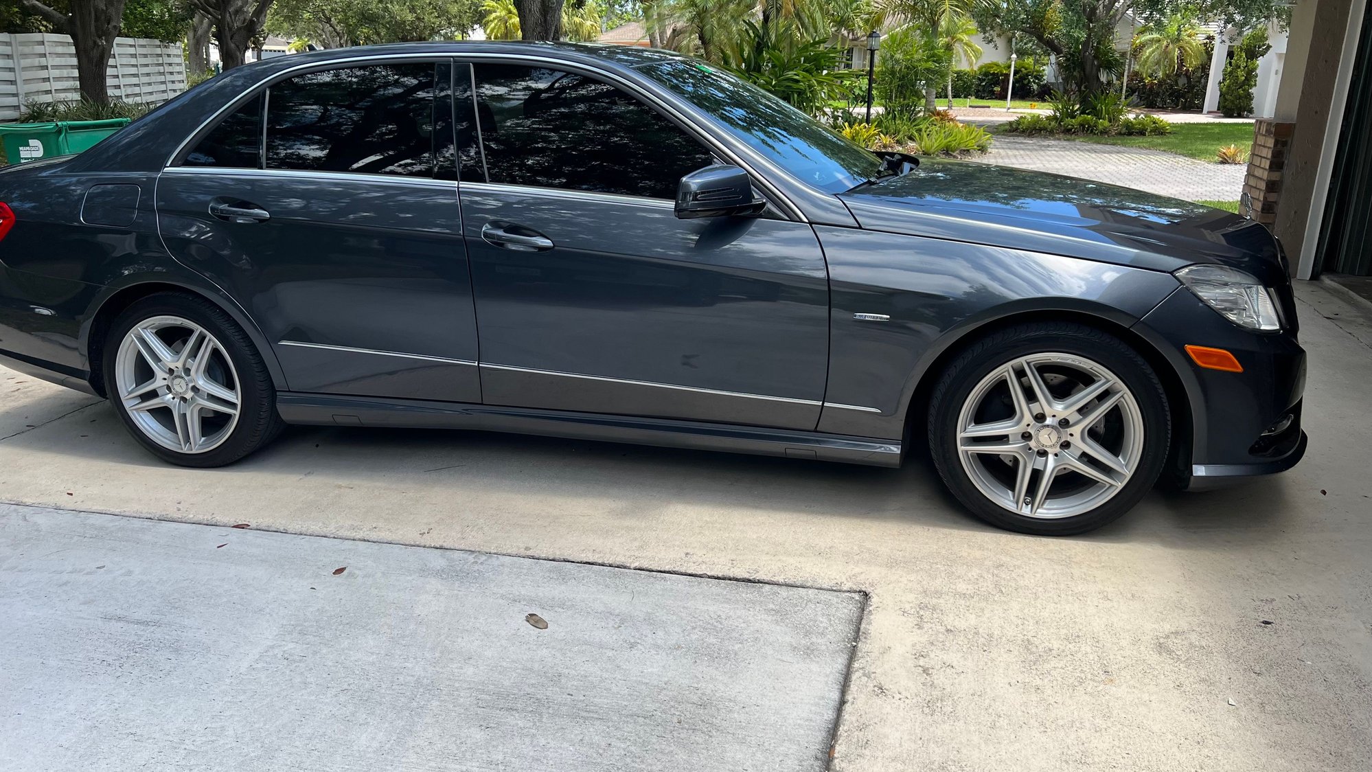

Stock rims.

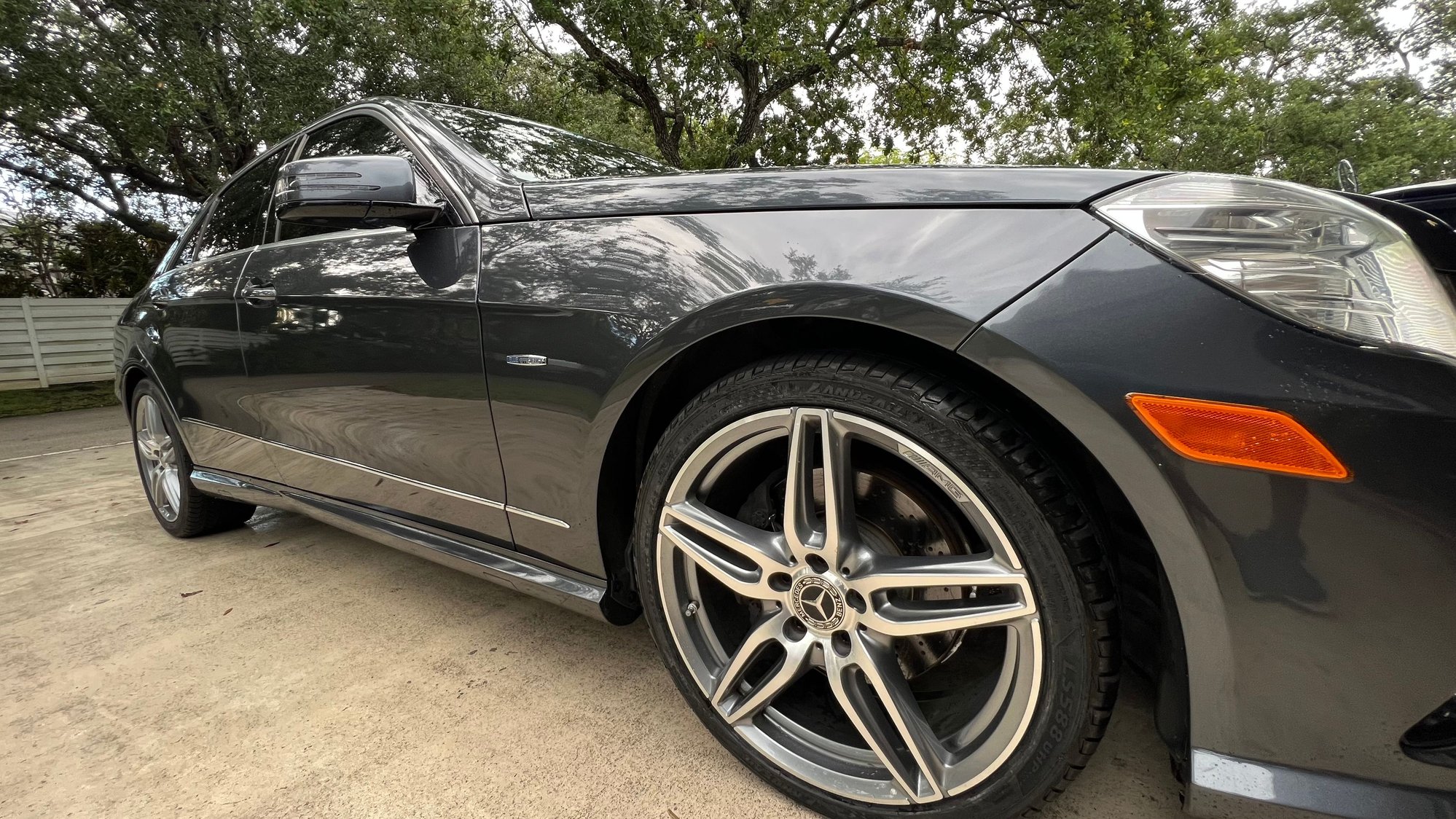

With the W213 rims.

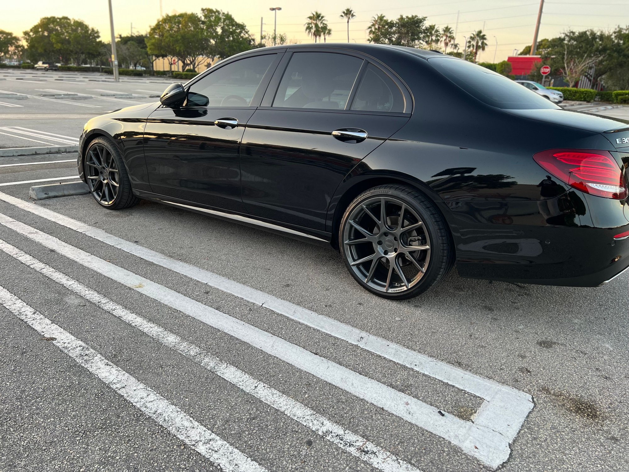

the W213 with 20 Vossens

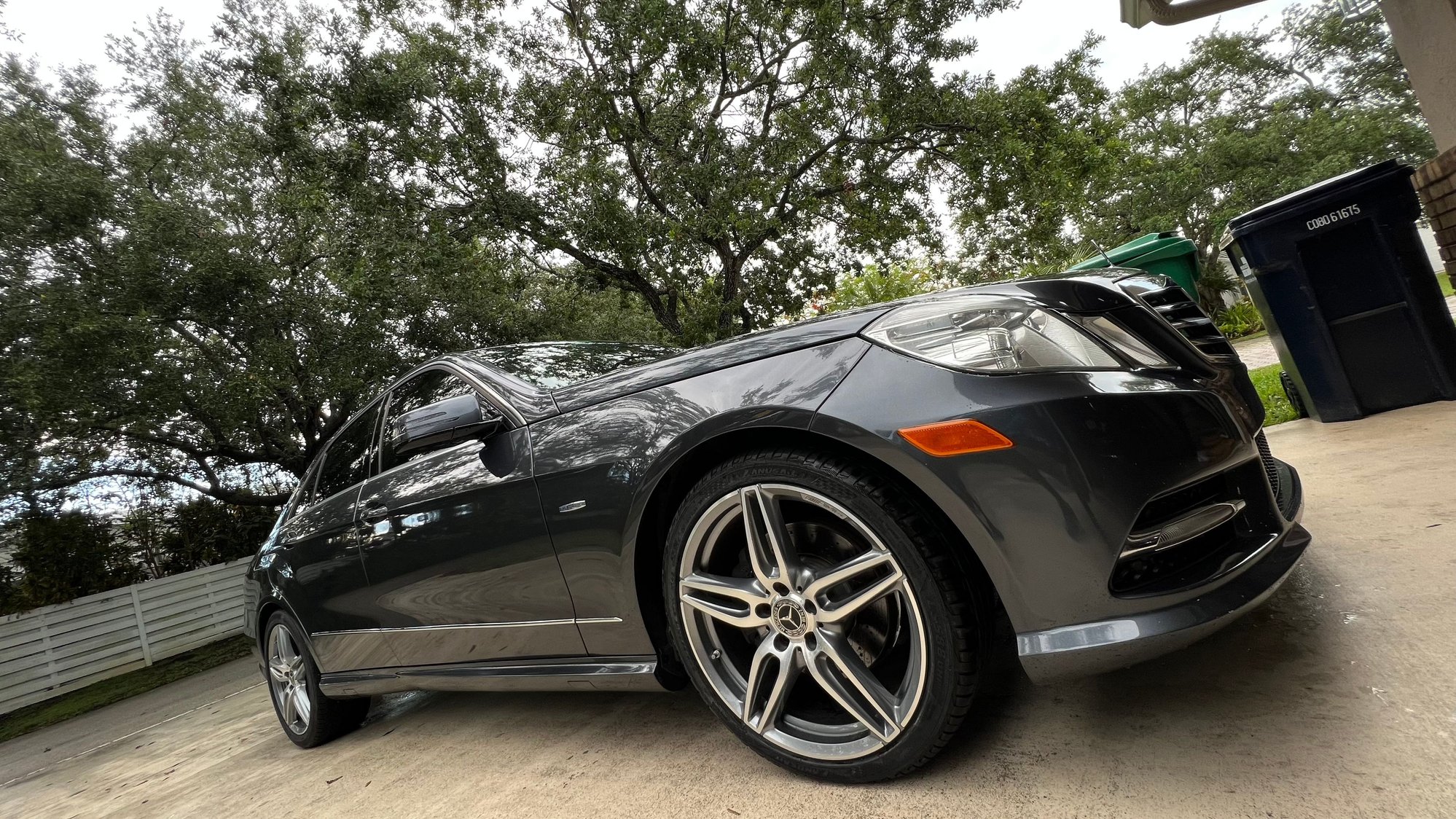

Done. Happy with it. Ride is fine. Looks great. Gunmetal color on tire matches car well!
