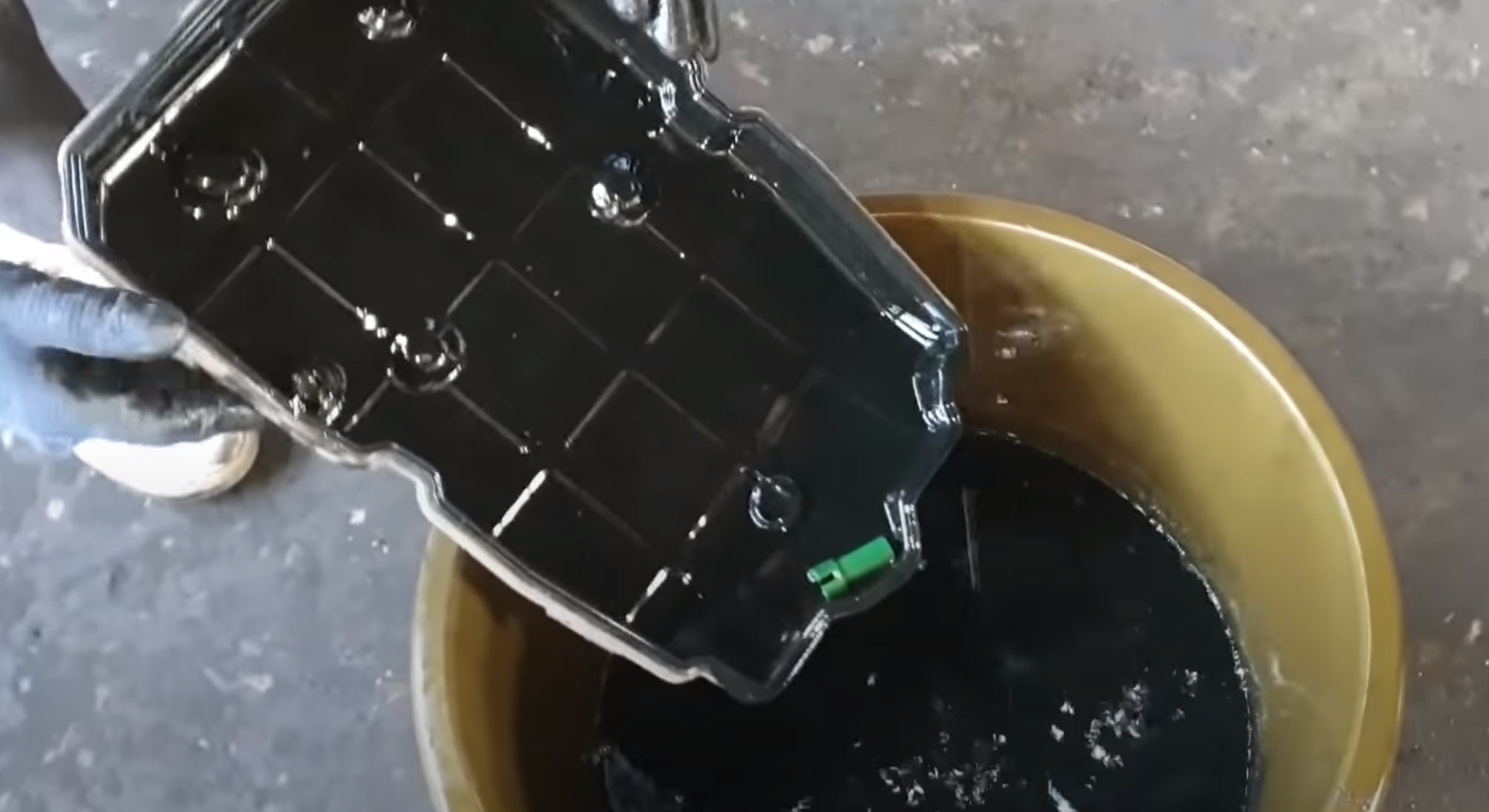

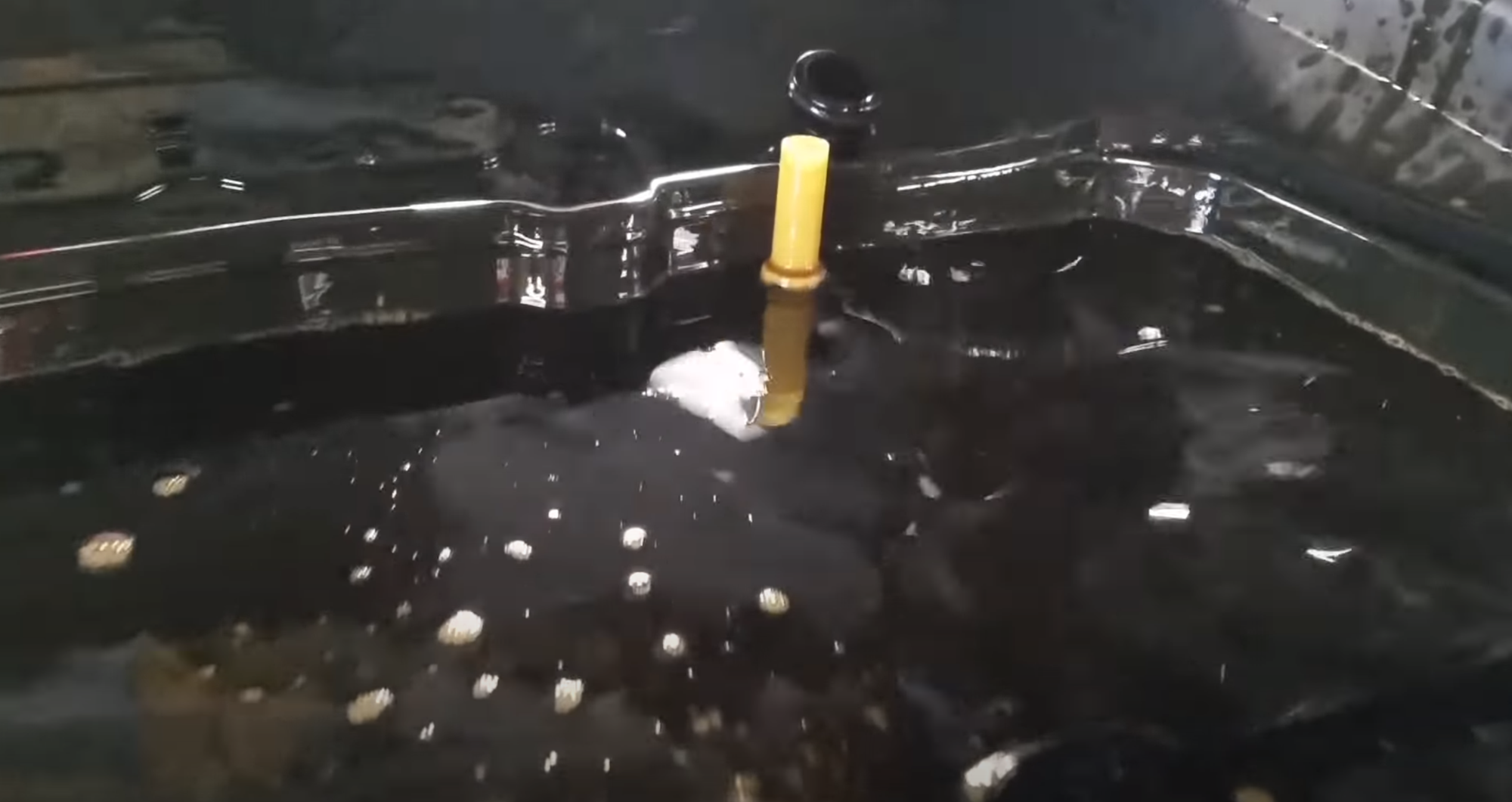

Talking about ATF, I keep wondering what are the chances I did its 1st service at 150k miles? When the car come with good service record at the dealer, I could not find transmission service.
Anyone has pictures of old ATF and magnets? My fluid was basically black and magnets had nice puddles of steel shaving on them.
I see plenty of cars with 100k before their first transmission service. Nothing to be too alarmed at, just be happy you did the service and the car instantly drives better. When I purchased my E550 at 108k, it had been done at 60 on the dot, the fluid was already spent even though the car did not have a very hard life. If you guys ever get into AMG GTS, it's probably the one issue that car has, it probably needs it every 30k.
