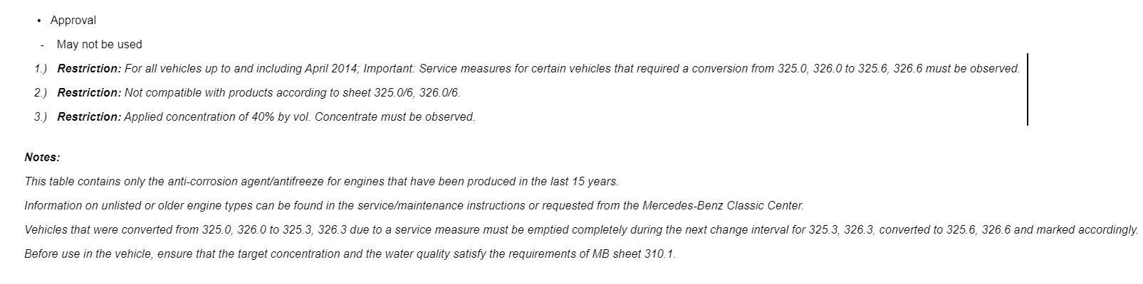

See #2 Sheet 320.1 : https://operatingfluids.mercedes-benz.com/sheet/320.1
This is what we will get :
So, if you bought W212 E350, E400 and E500 of Model Year 2015 and up to 2016, if you do not read properly to this page ( #2 Sheet 320.1 ), you get screwed thinking blue coolant 325.0 and 326.0 is
not allowed as per #1 Sheet 310.1
Below information is not too bad , at least the word CERTAIN VEHICLES is mentioned.
Restriction: For all vehicles up to and including April 2014; Important: Service measures for certain vehicles that required a conversion from 325.0, 326.0 to 325.6, 326.6 must be observed.
Hope this will help newbie buyer of pre-owned MB of model year 2015 and 2016 with the mentioned engines M276.9 , M276.8 and M278.
https://cimg5.ibsrv.net/gimg/www.mbw...b8224fa64b.jpg
https://cimg9.ibsrv.net/gimg/www.mbw...8d891e0718.jpg

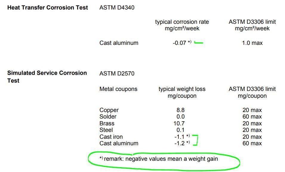

So what is this WEIGHT GAIN below in green ?
That is the thin film like coating the rush inhibitor becomes, to prevent the rust or oxidization on the aluminum alloy.
During my older days doing yacht maintenance, and since I am in the tropics with no winter and no risk of freezing, and older marine diesel operating temperature was a cool 85C unlike our Mercedes 95C+ coolant temperature,
we only use distilled water and add 5% of the recommended corrosion inhibitor from MAN Diesel or Caterpillar Diesel. There is no better heat transfer fluid easily available compared to water ...PERIOD.
So , when thinking coolant, do not only think of its heat transfer properties, think of how its rust inhibitors will work best for your engine.

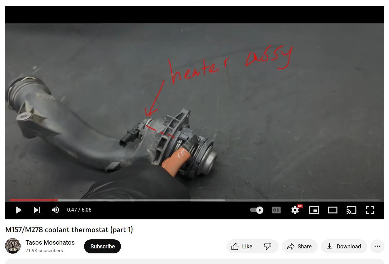

02. Our thermostat has a heater called R48, hence there is a wire into the thermostat and that is not coolant temperature sensor, that is heater power wires.
This heater is to speed up the opening of the mechanical thermostat, which still uses conventional wax-to-melt.
However, the sad news is, our thermostat due to its design to work with that R48 heater, the wax inside the thermostat is no more the traditional 86C/187F melting point,
but MB uses ( like BMW ) a higher melting point one at approx 102C/215.6F.
So when this heater has weaken and can't produce enough heat to melt the wax, your coolant temperature will be no more cooler than 102C + 3C at least = 105C or 221F.
3C I added is the "loss". Wait, there is more surprise......
M278 Thermostat Assy, with heater

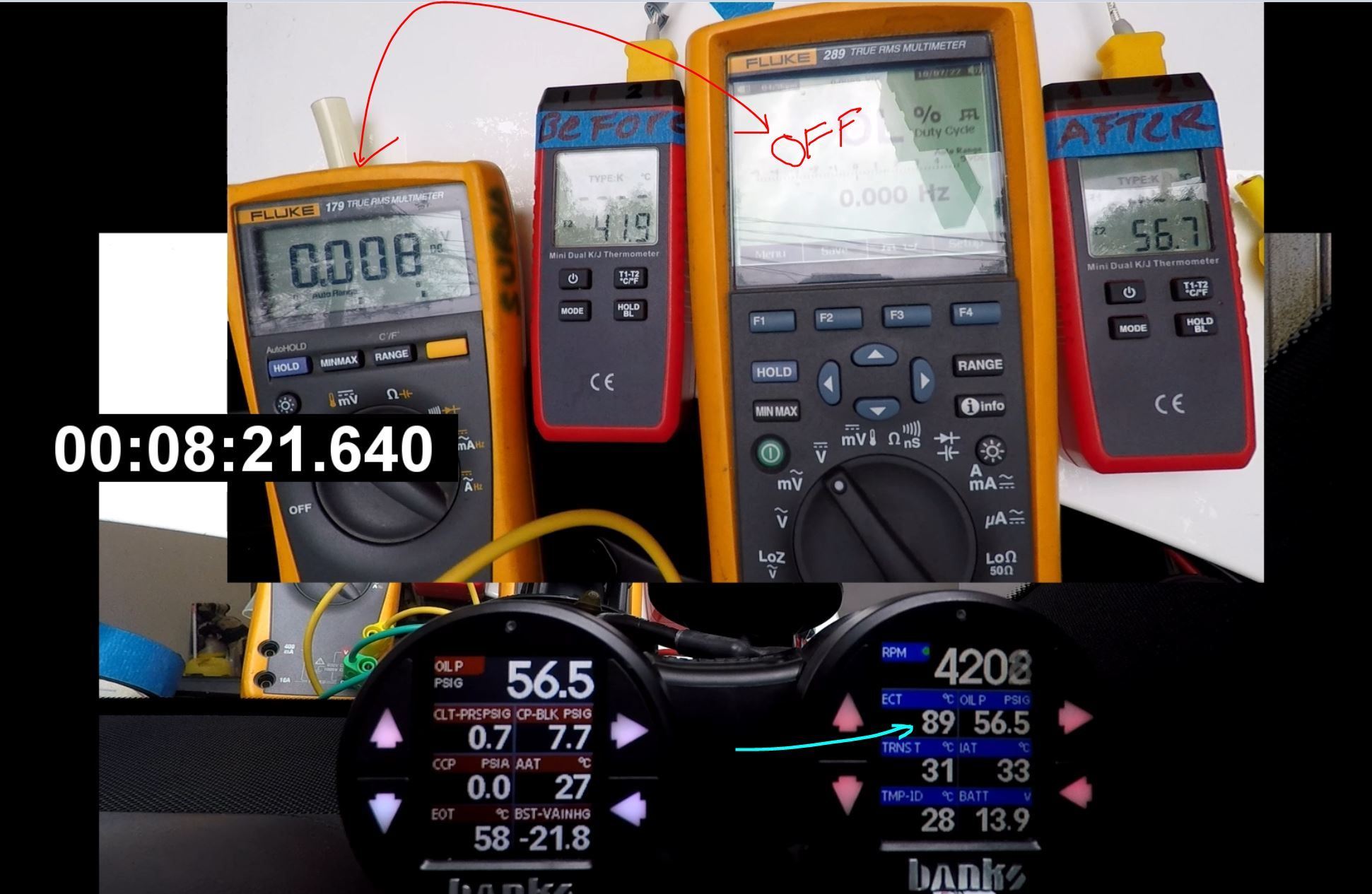

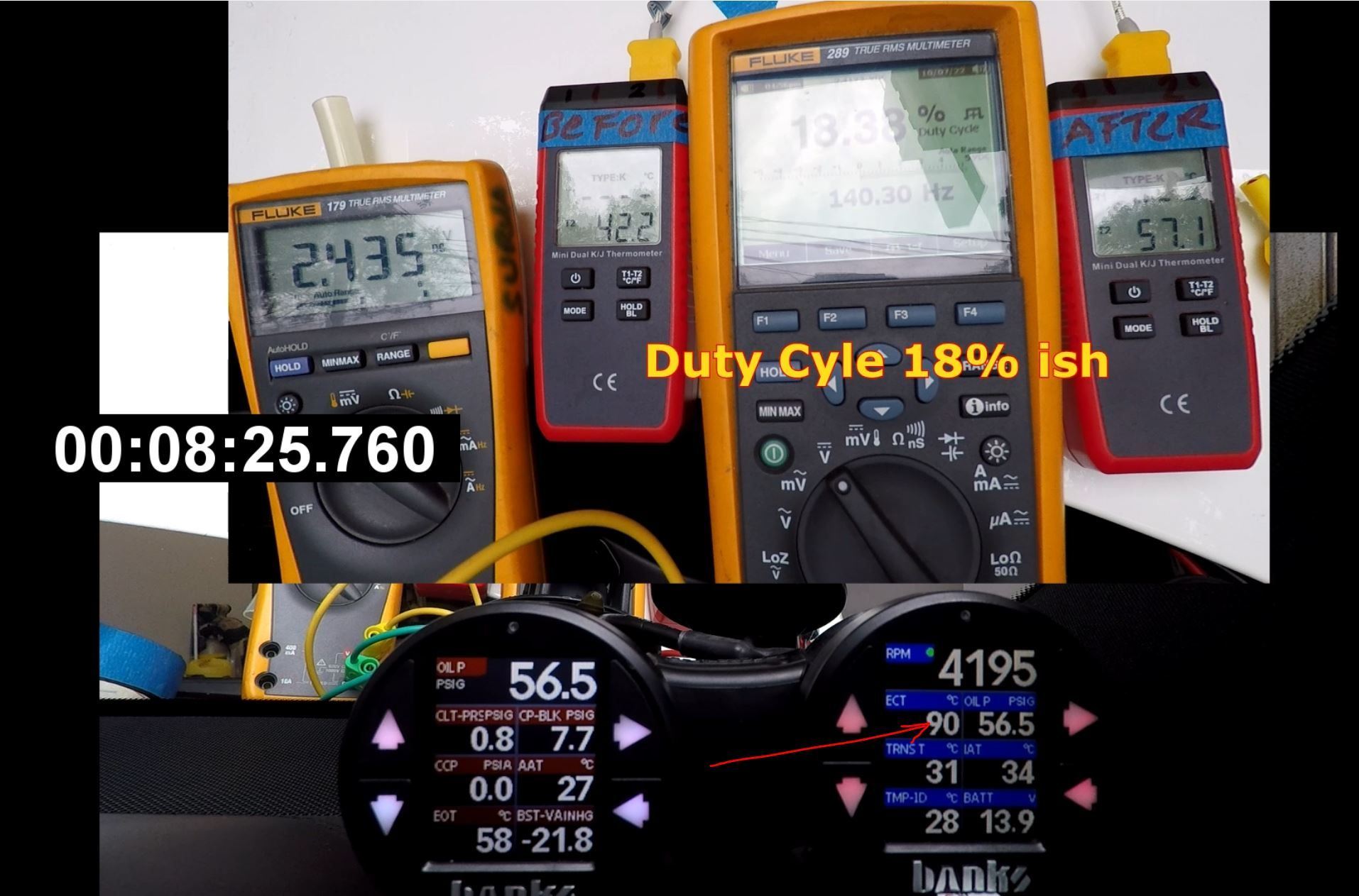

Here is the heater R48 in action when only coolant has reached 90C.
Coolant temp values are via OBD, so it is the accurate one.
At 89C/192F heater is still not heating up.

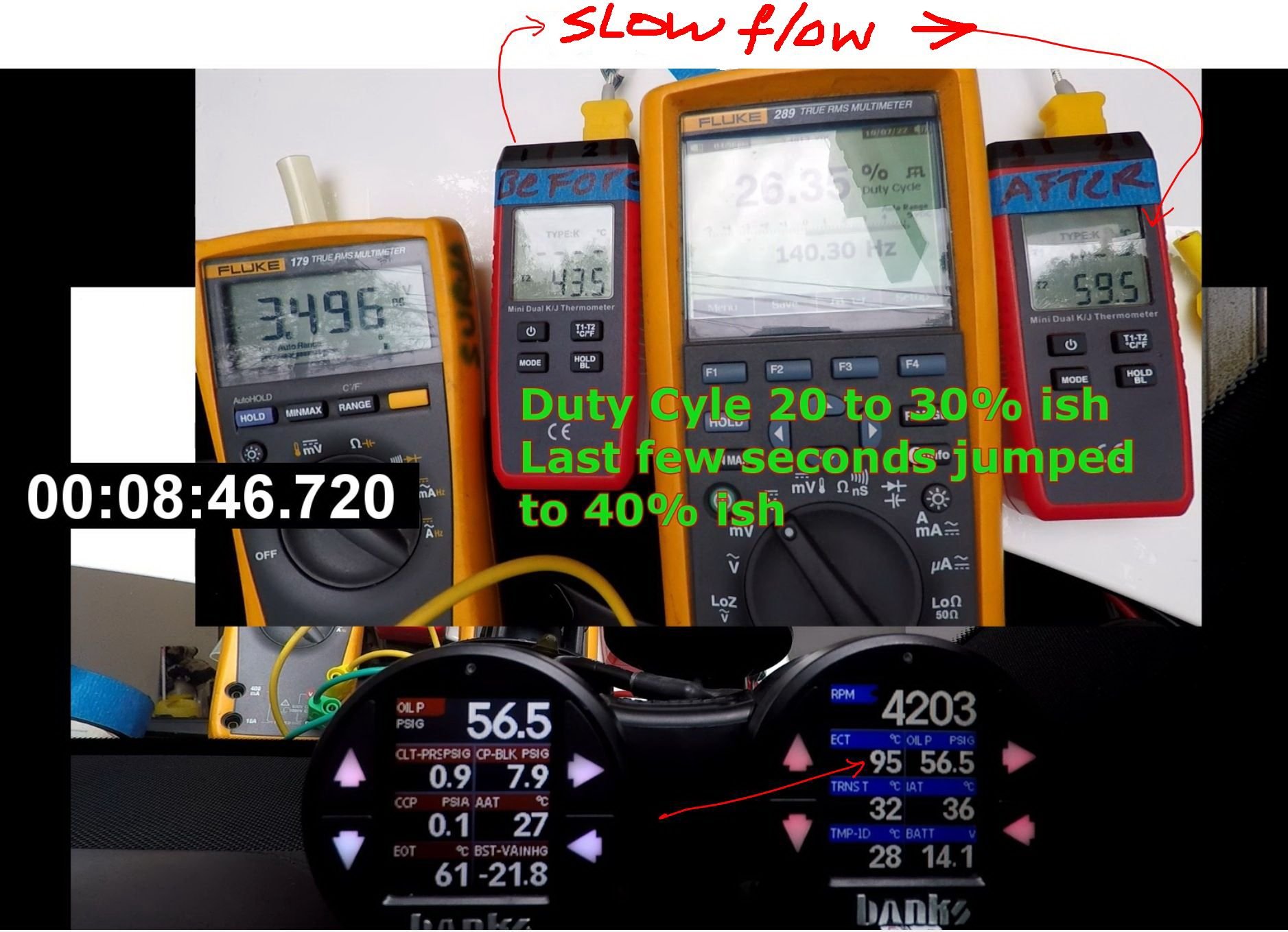

At 90C, the heater is starting to be powered up a tiny bit, 18% duty cycle only. This is a PWM type of power.
At 95C / 203F the ECM is still only pushing partial power to heater, not even 40% constant duty cycle.
ALL ABOVE 4 IMAGES ARE BASED ON A STATIONARY TEST

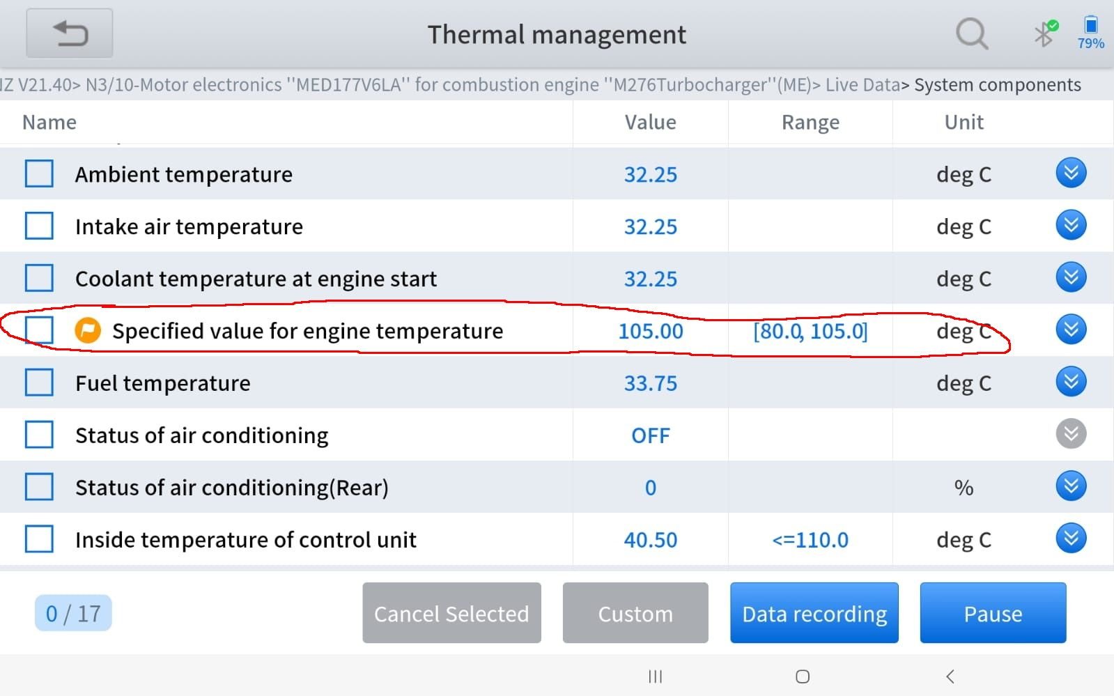

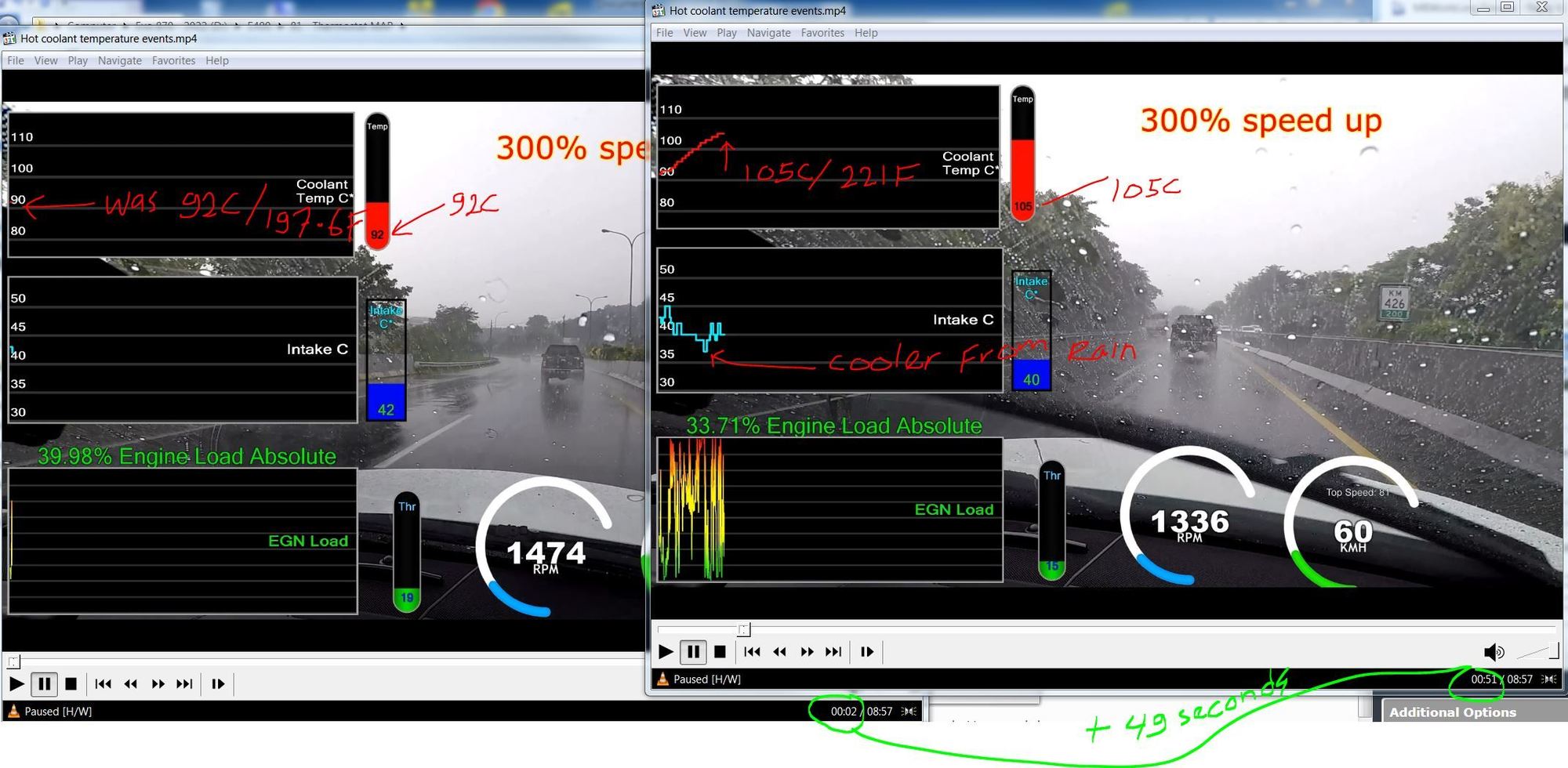

Upon engine starting from COLD, the ECM will set up a target temperature of 105C/221F. BELOW IS ENGINE OFF AND COLD

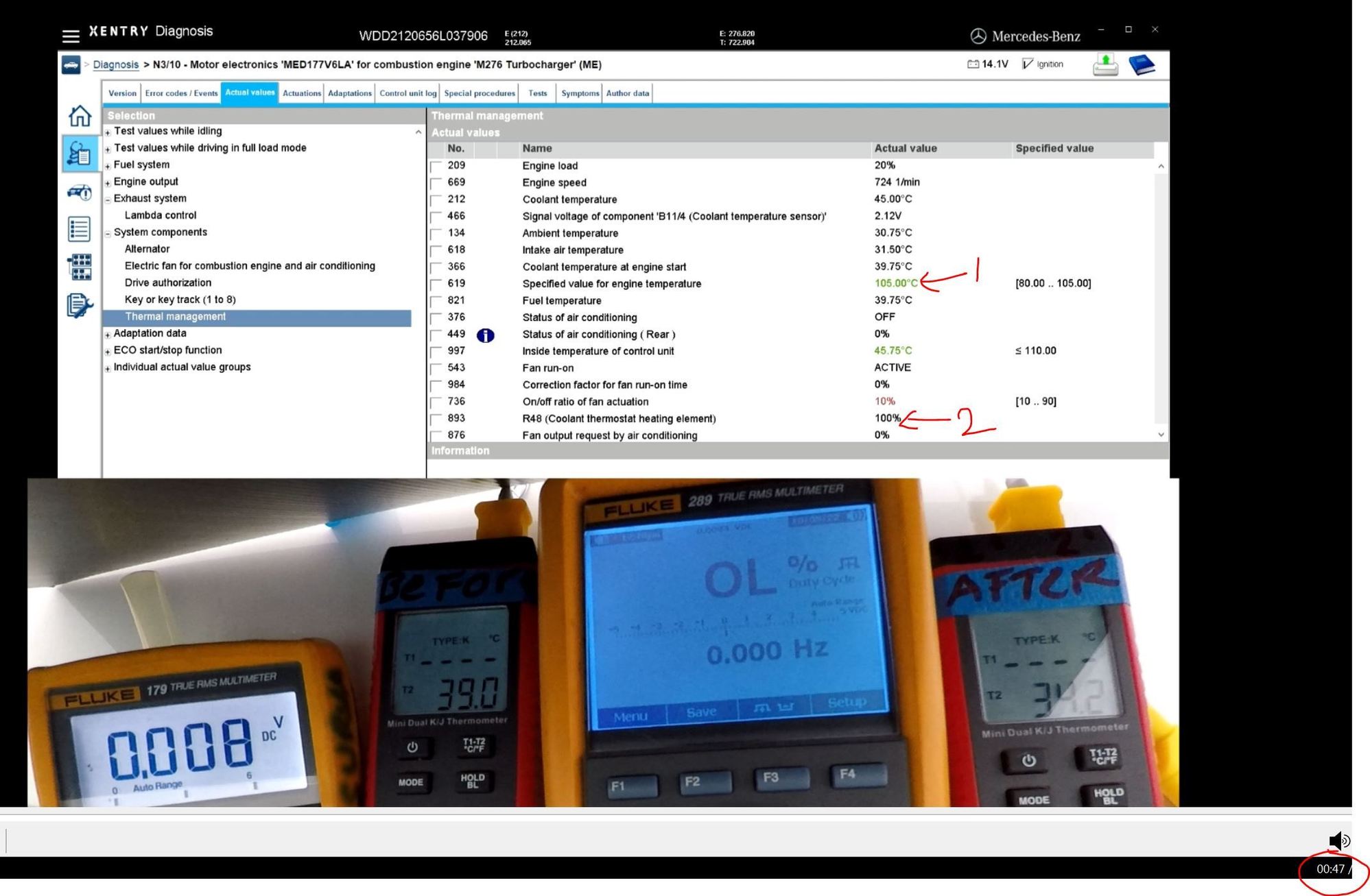

Also you need to be careful when using any scanner or Xentry when you look at the R48 Heater percentage. That % is opposite value, 100% means 100% OFF , yep sound crazy. See item 2 in red.
This is what R48 82% means. 82% OFF or 18% power is to the heater R48 hahahahah
Now look at item 1, the coolant target temperature has change to 90C / 194F and no more 105C / 221F like when engine is still COLD at first engine start of the day.
You see, 105C/221F coolant temperature is actually the most thermally efficient temperature for combustion. So once in a while, MB designer thru its ECM algorithm will push coolant temperature to 105/221F and even 110C/230F when
there is a "safe" opportunity. What is a "safe" opportunity ? Among others is when ambient temperature is cooler than or at 22C / 71.6F , or when it is raining and radiator get extra cooling power from rain water + wind velocity of the moving car.

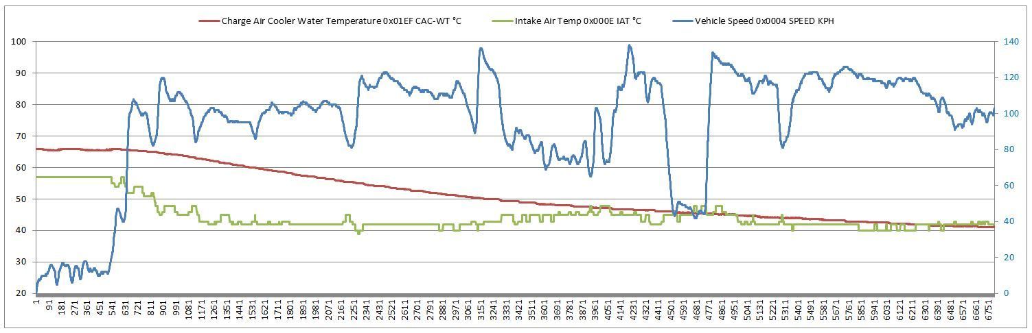

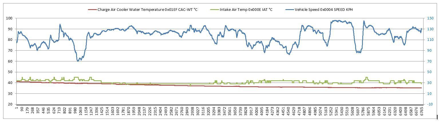

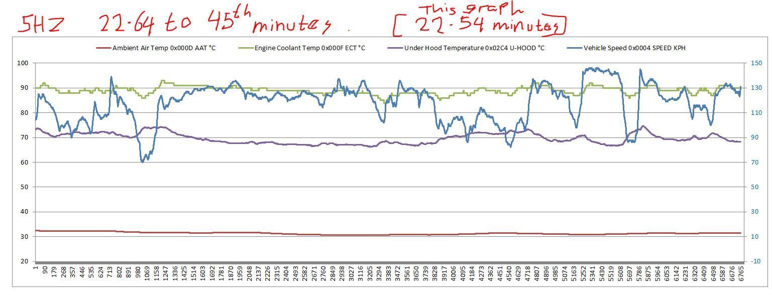

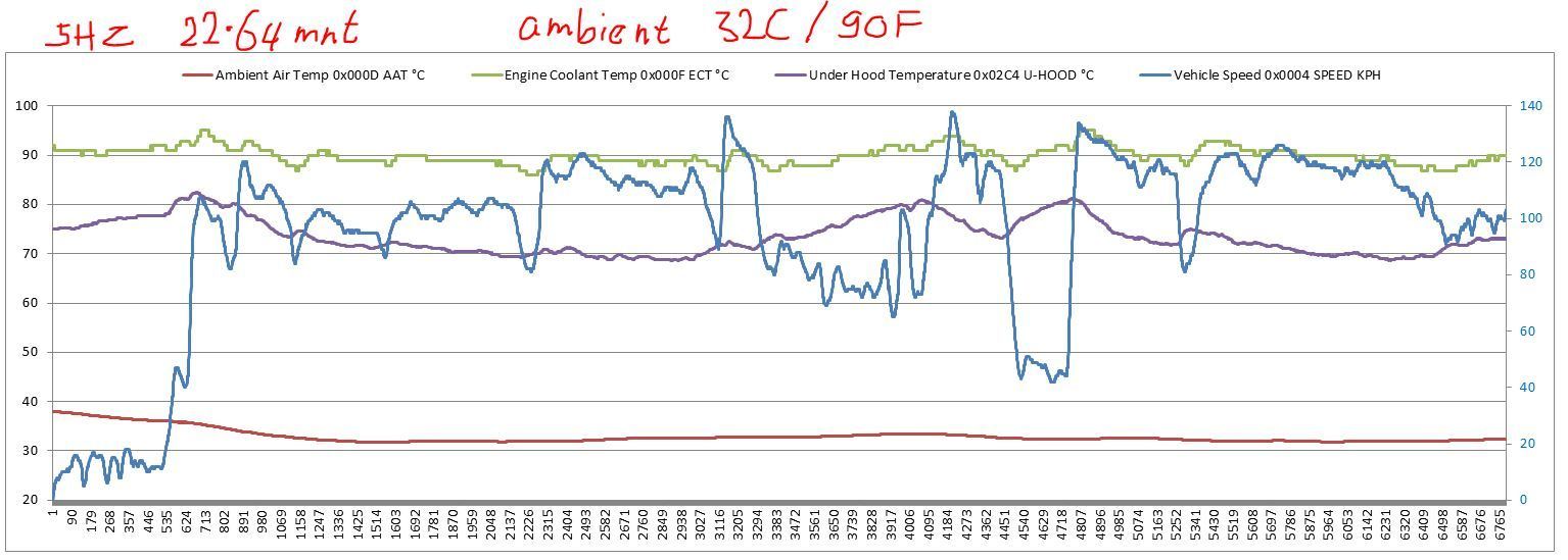

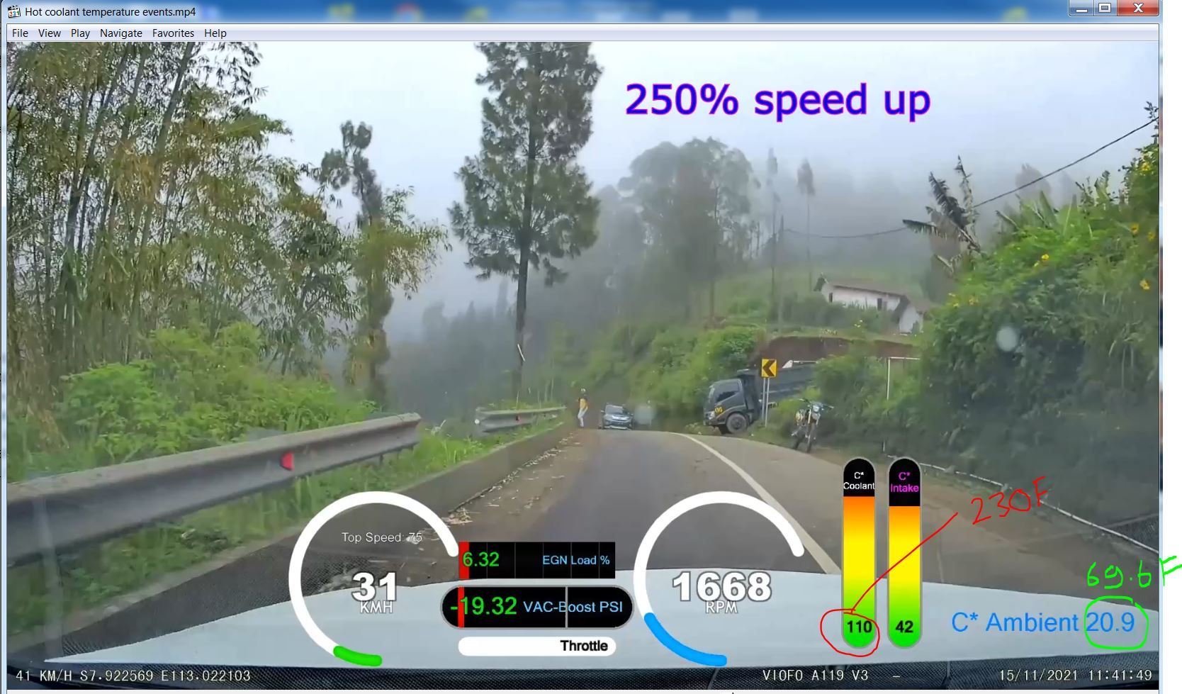

For my M276 3.0 Turbo, which shares the same radiator as your M278, same body aerodynamics for our W212, the best cooling for me at 32C/90F ambient temperature is
car velocity of at least 120KM-H / 74.5MPH
Scale on the right is for SPEED only. In KM-Hour
Scale on the left are the temperatures in Celcius. This is me out of a petrol station. So some heat soaked happen during fuel stop.
The charge cooler coolant temperature is my own install and so is the underhood ( engine bay ) temperature.
These below the next 22.54 minutes later when heat soak is almost gone and I can maintain better a bit over 120KM/H or 74.5MPH average.
Hope this thermal strategy info is useful to you............

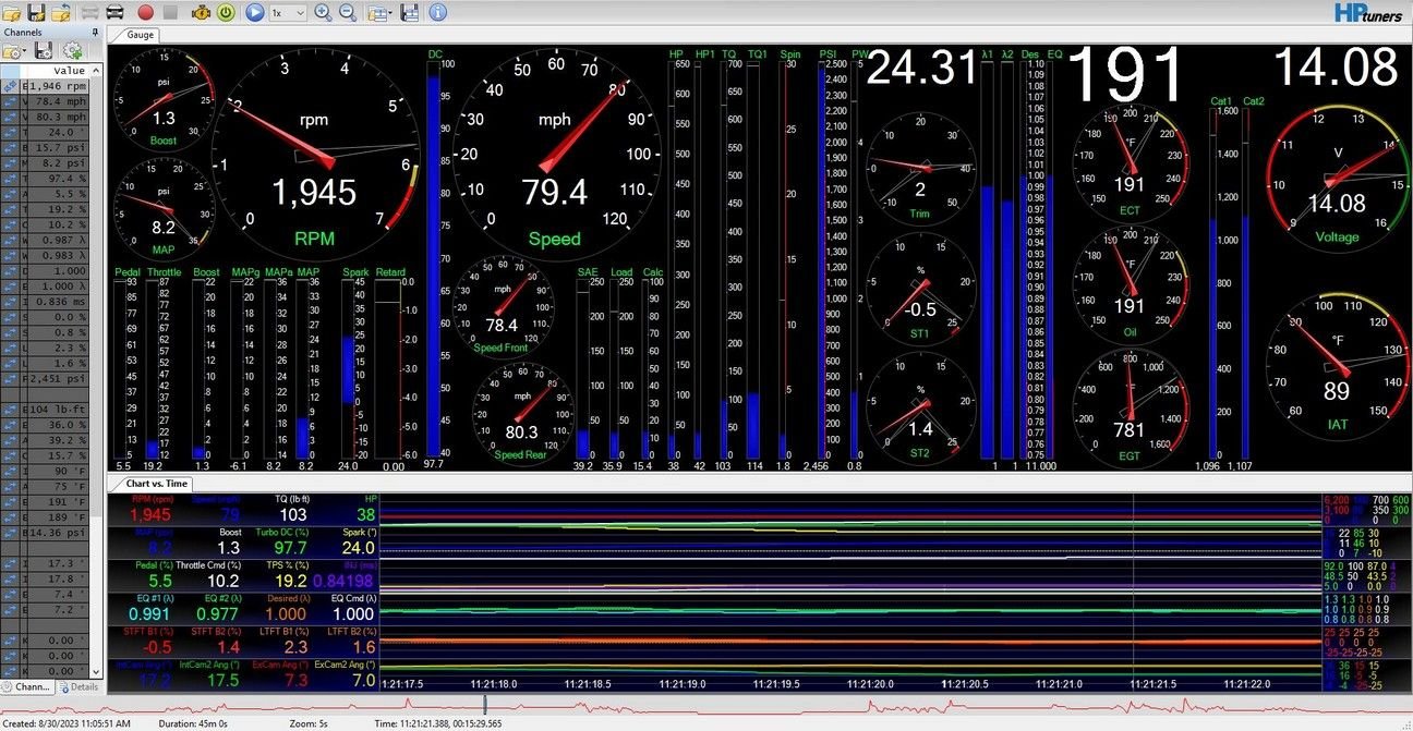

I measure water temp via the ecu, using HP Tuners, which is also how I programmed it to run so much cooler. Mainly the fan settings, then spark timing to more or less fix the idle temp. Plus a slight bump in idle speed. I bumped spark ~10 deg which made all the difference. Today it was ~108F and idle in park was 199F. Oem would be 230.
If you want to log data you should consider HP Tuners. It can display lots of things all at once,
via charts and/or gauges, then you can play it back later. Data speed is limited by the can bus, but cant do much about that.

The heater is a rod, it is inserted into thermostat body to make metal to metal contact to deliver the heat and melt the wax inside the thermostat in order to make thermostat open sooner than 102-105 celsius.
Replace the complete assy and bring back your timing to original.
Heater has a life and so is the thermostat. Get a new one and while at it replace all those dangerous hoses + aluminum pipe combo to intercooler famous for breaking and leaking
