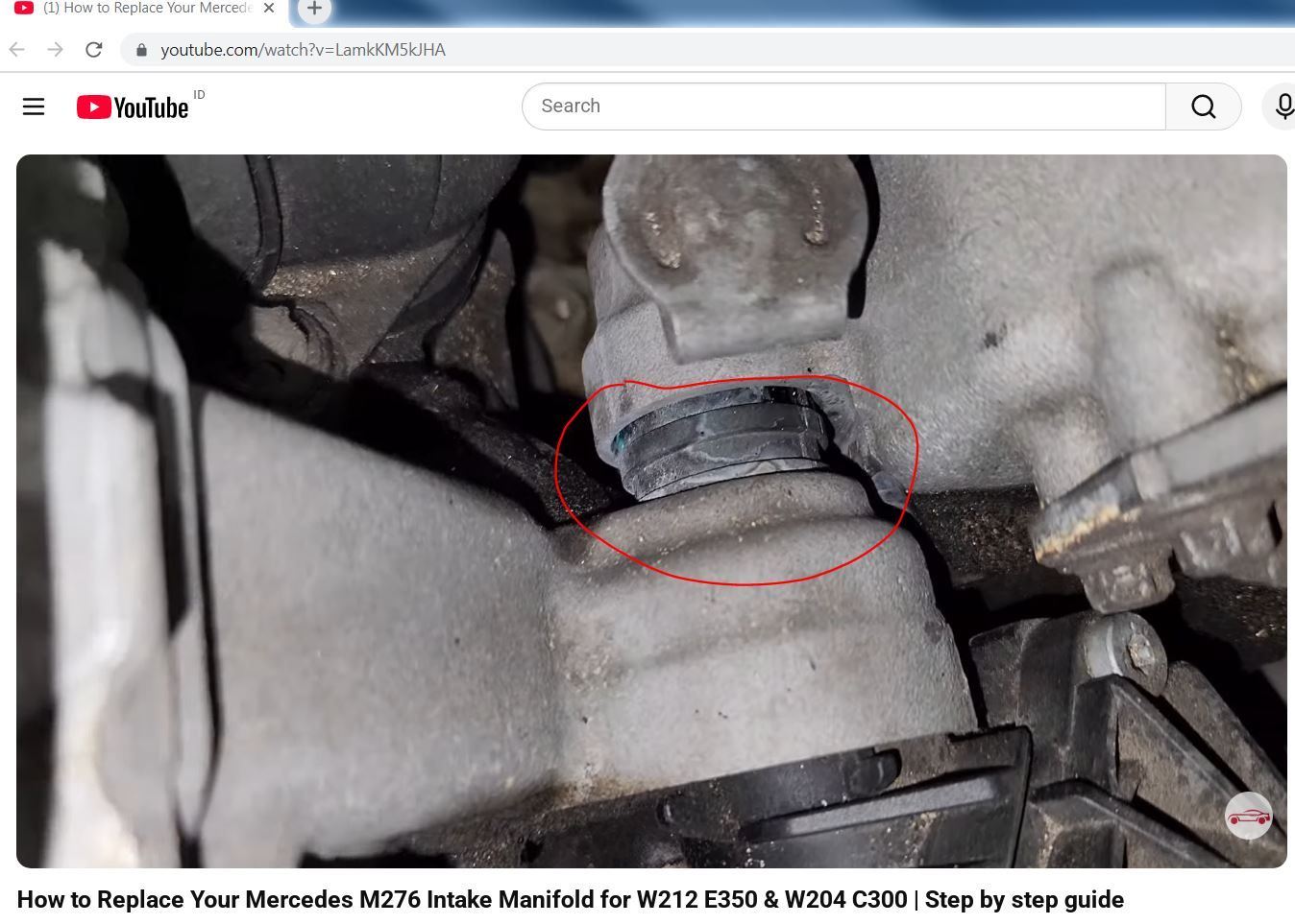

4th video.........
This one mild leaking and then easy to break apart when removed, it was that fragile after so much heat cycle. Good thing it was seen leaking and not broken/cracked while in use.
Mileage unknown but age wise, imagine oldest M276 is 2013-2014 ?
He discovered it was mild leaking a few months back, in video below :
So you guys with aging M276 10+ years old and say above 100,000 miles, be ready to have a leak or breakage on this pipe.
Inspect them properly and replace them. This pipe breaking can kill your engine due to overheat in a VERY short period,
because the coolant loss will be too much.
