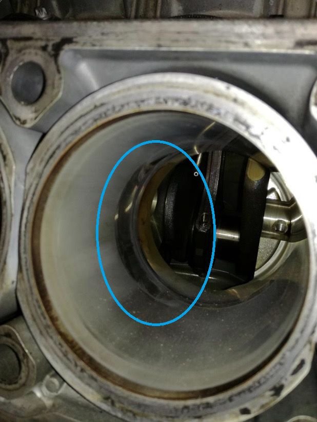

Most people here probably have not seen what the m278 and m157 bore scoring looks like in full extent. Pistons are damaged also in cylinders where the bore is still nice in many cases but not always. Even cylinders what has perfect bores have piston damage quite common. Piston scuffing happens because of faulty fuel injectors, poor lubrication and excessive heat.
If you google the photos what overheated engines cylinder and piston damage looks like. It is very similar to m278 and m157 bore scoring. I wonder why?

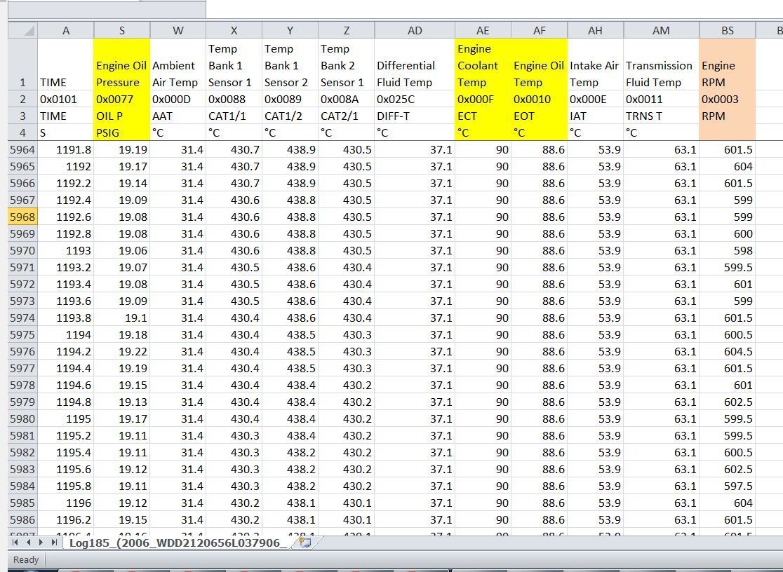

If engine oil is COLD idle oil pressure is higher and also RPM is on purpose higher set by my ECM for cold start, like 30 seconds or so.
If engine is already normal hot, and idle is back to 600ish RPM, oil pressure would be much lower at 20 PSI approx.
You will never see hot idle at 40 psi if engine oil and coolant already 80C.
I have tons of logs....

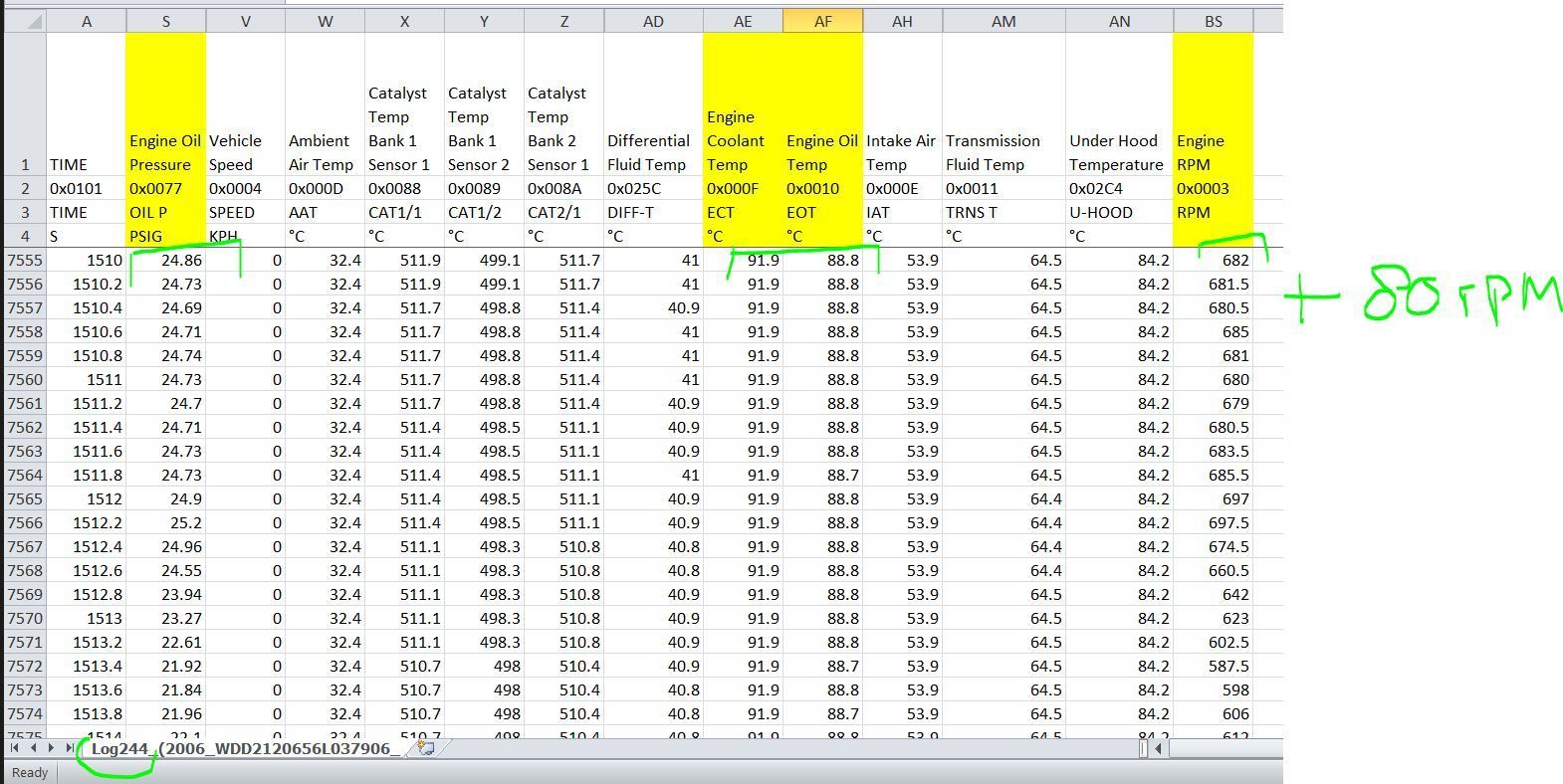

Without a proper logger, JR data is not complete.
Also he has no oil temperature sensor, a real one. Oil temperature effects viscosity so much in return effect oil pressure at X Y Z RPM.
Engine oil temperature below is from skin temperature of the oil pressure sensor port adapter (metal) using Omega K thermocouple.
Extra 80 RPM, gets 4-5 psi higher oil pressure. Different log, but closest oil temperature.
This is much cooler engine oil temperature.

I have two m278s. I think that it drives better when solenoid is unplugged. It can be my bias or my other car just does not react that quick on throttle.
[img alt="This is my friend car and he thinks that it happened because of injector fault. Injector washed the cylinder wall. Piston looked good. Spark plug was black on that cylinder. Would oip
Solenoid mod helped on that case.? Maybe.
"]https://cimg7.ibsrv.net/gimg/www.mbworld.org-vbulletin/618x822/d87115e0_48d4_437b_bd41_483a0620cbb4_c41cf44c1b58c 745b181d04e136e7361e25be3bc.jpeg[/img]
This is my friend car and he thinks that it happened because of injector fault. Injector washed the cylinder wall. Piston looked good. Spark plug was black. Would better lubrication and cooler cylinders help in that case?
[img alt="This is random photo from internet and looks more like piston overheating.
"]https://cimg9.ibsrv.net/gimg/www.mbworld.org-vbulletin/1500x2000/img_5996_8be15f0a9351722ff79c1fd071971519aef65a08. jpeg[/img]
Another photo from same case.
Another photo from same case. Looks like that pistons did not fit into the cylinders anymore.
I don t know why other two photos do not show correctly. When i press edit button. It looks right. Sorry
There are few examples from different piston damages.
