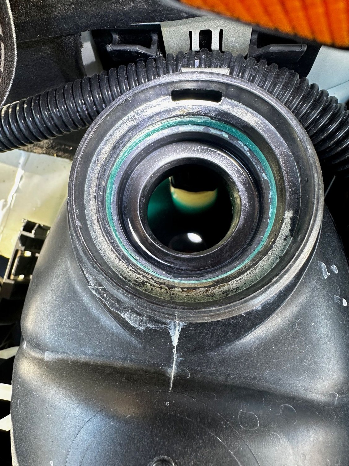

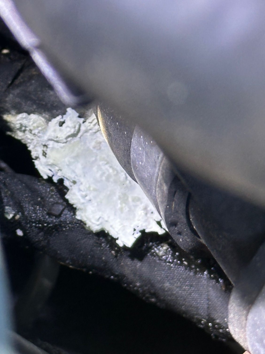

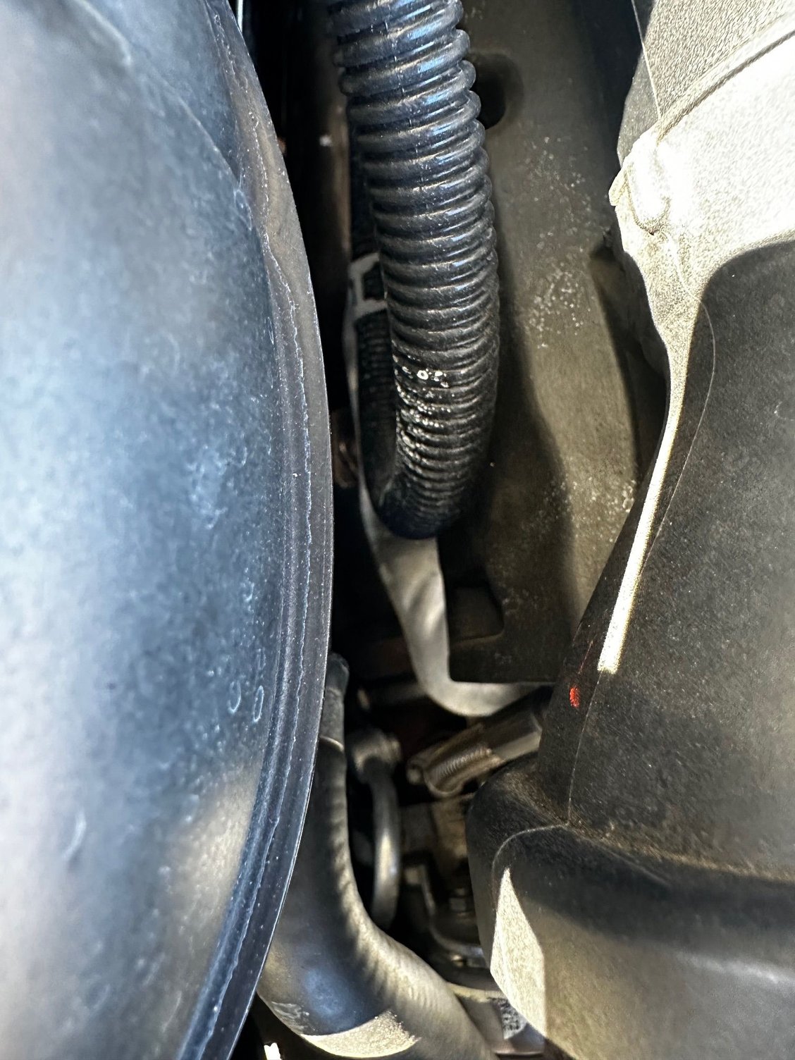

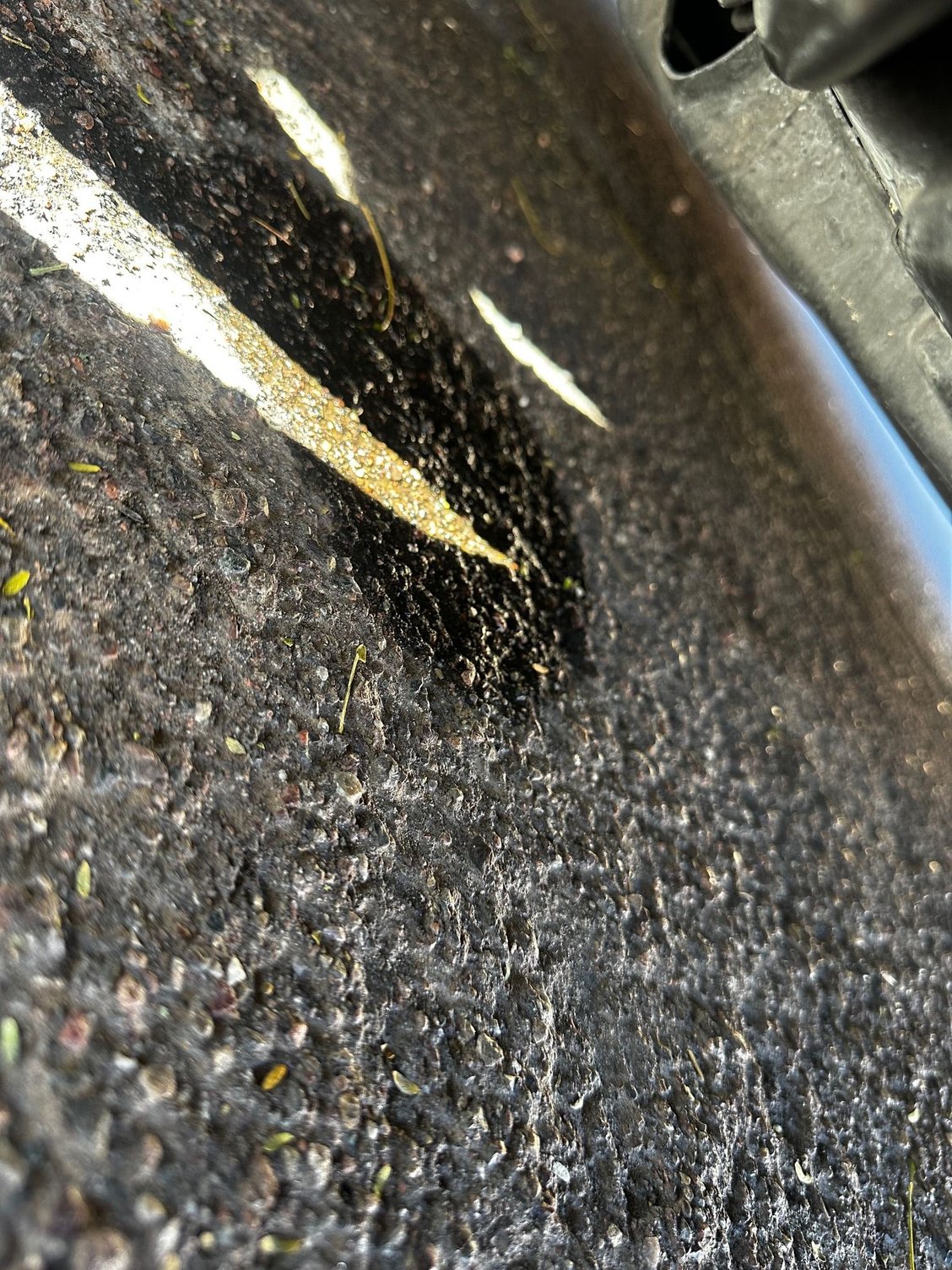

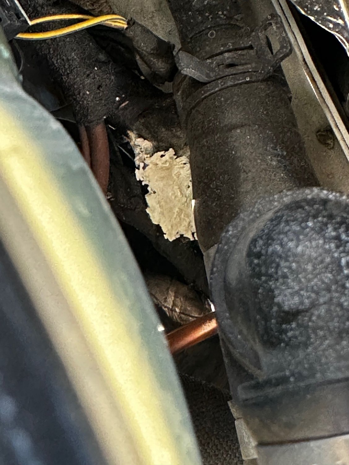

I've attached the images for what I am able to see without taking anything out. My questions are - thoughts on the most likely culprit of this leak (or how since it seems like it may even come out of the cap) and what is the proper OEM coolant I should be using? I know I am a new owner and it has been 6 months since the service but it's less than 2500 miles since that service in June to today - does the shop have any responsibility here? (not really looking to drive to Tucson to get it fixed unless it's more major than swapping out the reservoir.
Thanks in advance for the thoughts! I really enjoy working on my cars... I drove a 1972 Chevy El Camino 50 miles a day for over 2 years straight! Not afraid to get dirty.
Cheers!

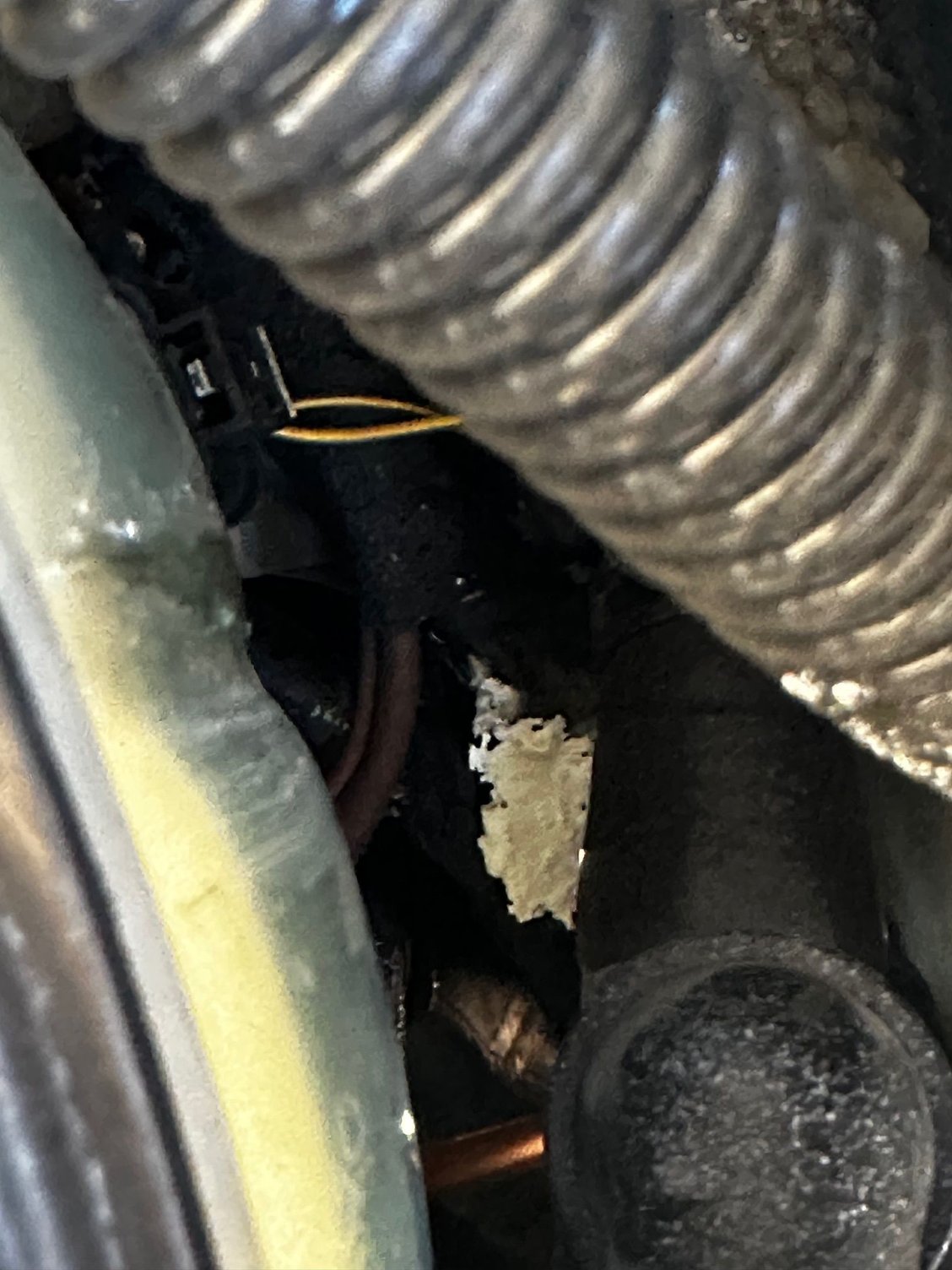

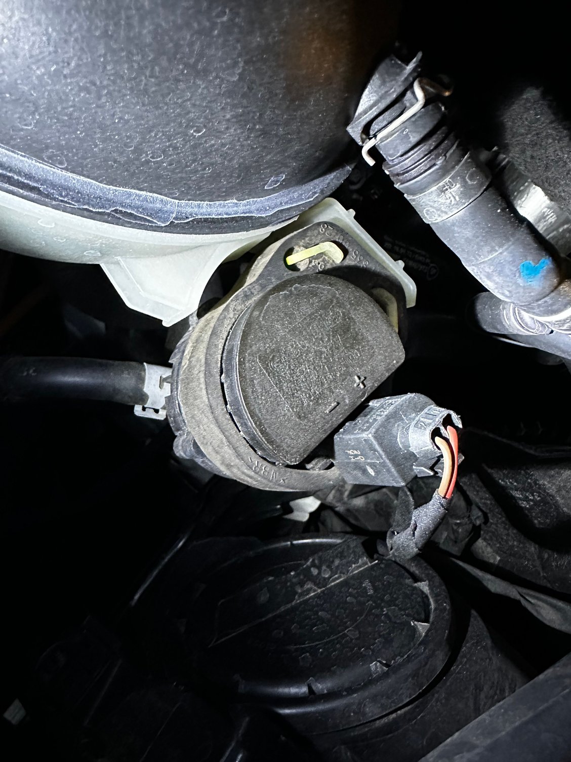

Notice residue around the cap and the lip of the top half.
Some Spray next to the reservoir

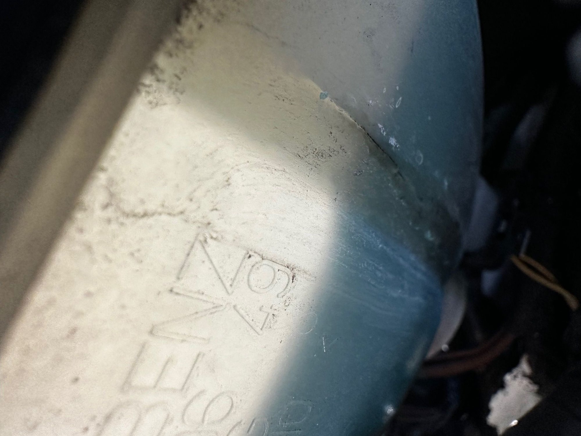

Some sort of residue built up on the bottom of the reservoir but looks dry and may have been much longer.
Only area up top that I can see has some sort of wet spots. Reservoir side closest to the motor
The hole it is dripping out from onto the ground when parked on flat surface or incline.

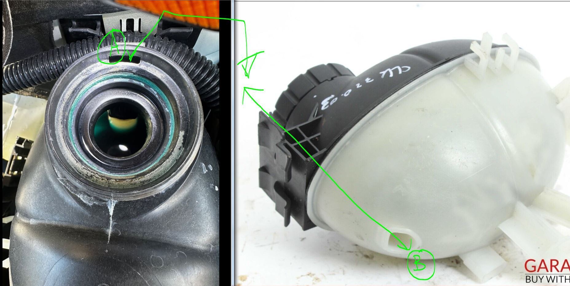

Inside the cap. Color seems Blue and not the purple the part store is trying to give me.

You did good by not listening to the purple advice- This cooling system uses Blue/Turquoise chemistry.
Being in high heat AZ region you need your cooling circuit in good repair.

You can use a UV dye to spot exactly your leak source or replace : the plastic expansion tank + Cap + hose/O-ring as these 3 are know to have limited service life.

leaky cap
Your pics show an active leak at the cap... thing is once pressure is well sealed in something else going to get stressed out.
We know the cap is supposed to vent and the plastic tank is not supposed to split but regardless that's what happens.
Given you're in a heat stressed area, your best be proactive instead of wait-N-see.
The issue is normally even the cap is not supposed to safety-vent under standard conditions. The car produces too much heat that's poorly removed.
I wonder if these smart-thermostats are worthless or the main pump is ultra undersized to be useless - I get it, the ECU runs these engines a little warmers but radiator fan and venting through open cap under normal conditions is not too impressive.
+++ internal vent:
I think the cap has an internal venting path through the tank.

On my third M278 car and I live here in the valley in AZ as well. Looks like the leaking coolant is pooling onto one of your lower control arms. Had the same issue on my W222 S550 just a week or two ago. Found a leak behind the firewell just below the font cowl. There are a number of lines back there along with the heater control valve (I believe this is this case on your car as well). Found a leaky line along with a leaky heater control valve. Took me an afternoon but its not the worst job. I would check there and see if you see some old, caked up coolant behind the engine from the top.

So according to your first post on what has been done it looks like the all of the turbo coolant lines were replaced, but not the entire cooling system. This isn't the worst thing in the world as the turbo coolant lines on the M278 will pretty much always leak at some point, so good thing they're done. I'd definitely look at what I had suggested as the heater control valve leaking can be a common thing as well.

Use 326.0 or 325.0 coolant for your M278.
Simple explanation : 325.0 = Concentrated 100% coolant and the 326.0 = Pre-Mixed 50/50 coolant and proper distilled water
https://mbworld.org/forums/e-class-w...formation.html
The 1.4 BAR pressure cap and the coolant reservoir works like this :
01. When 1.4 BAR is reached, the pressure cap internal sealing system will rise up a bit and allow the overflowing coolant to go to small hole A and dumped to bottom of the reservoir at hole B. A & B are interconnected.
This is also to protect us the user from getting hot coolant spray when opening the pressure cap while coolant is hot, with doing counter clockwise rotation a tiny bit like 90 degrees or so ...and let the gassing off or overflow to occur to A and B holes.
02. You best replace your coolant cap, it might be weakening already, because the "leak" or venting is up to the red arrow zone below, where by right hole A would manage it nicely.
Attached spec of the cooling circuit and the pressure cap. 2 pdf
The pressure cap looks simple but it is not that simple, when you are done reading COOLANT PRESSURE CAP TEST VALUE.
Buy genuine coolant pressure cap please.
There are 2 types of cooling system on M278 that I know of.
1st is the turbo aftercooler cooling is shared with the engine cooling circuit and the dead give away is that the coolant reservoir bottle is only 1, that big black top one as per your photo.
2nd one is a totally separated turbo aftercooler cooling ( like my Turbo 3.0 M276 ), where there is a smaller white color coolant reservoir bottle at middle of engine front.
Which version is yours ?
2nd version
