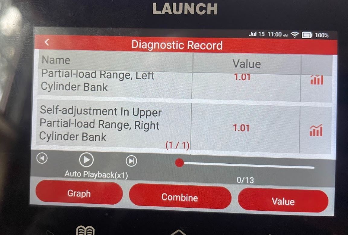

Does anyone know if you can export he diagnostic records to view on your PC? I have captured many data stream but do not see a way to get them off the reader. The Elite 2.0 is very powerful but viewing the records of the live data is difficult and tedious on such a small screen.

You know how you can hook up the scanner to a PC USB Port?
From the PC you can navigate the Android filesystem inside the handheld device.
You may find where the dot.csv log files are located.
Well worth poking around to import into Excel for analysis.

I plugged it into my USB port but my PC does not recognize it as a drive. It seems to only support charging of the device.

There is an option to share the report, just add your email address.

I have no option to share the data streaming reports, just the diagnostic (DTC) reports. I start a data stream and then hit "Record". When I stop the recording it auto saves a copy that I can view on the device. When I hit "Report" it just says "Report saved". I feel like I am missing something obvious.

In the scanner's setup, specify a wifi connection and an email address. There's a "share" option that sends the report via email, and you can store and print from there. Scanner updates are via wifi -- no PC connection is necessary or provided.

I must be missing something. I have WIFI setup and can easily email a diagnostic report. I have no option to share a diagnostic record which would be the live data stream results. Viewing the graphs on the device is nearly useless.

Sorry -- I think I misunderstood you. I thought you were having difficulty emailing the inspection reports. I haven't worked with the diagnostic records, but I'll take a look and see what I can find about recording/printing results.

Have you tried using the "Image" function? This lets you capture screens and email them.
